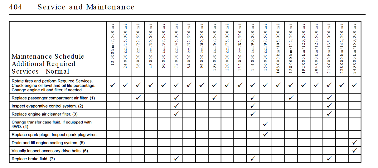

Just go by the recommendations in the owners manual, anything else the dealer recommends is crap to get your money:
http://www.chevrolet.com/content/da.../02_pdf/2016-tahoe-suburban-owners-manual.pdf
Page 404. Oil and tire rotations every 7.5k (our oil life is always around 2-3% at that point), cabin air filter every 22.5k, engine air filter and brake fluid every 45k, transfer case fluid and spark plugs every 97.5k, engine cooling system every 150k. That's all the regular maintenance needed without other issues coming up.
And if you use Top Tier gas (and/or Techron just before each oil change), you should never have a problem with carbon buildup.
