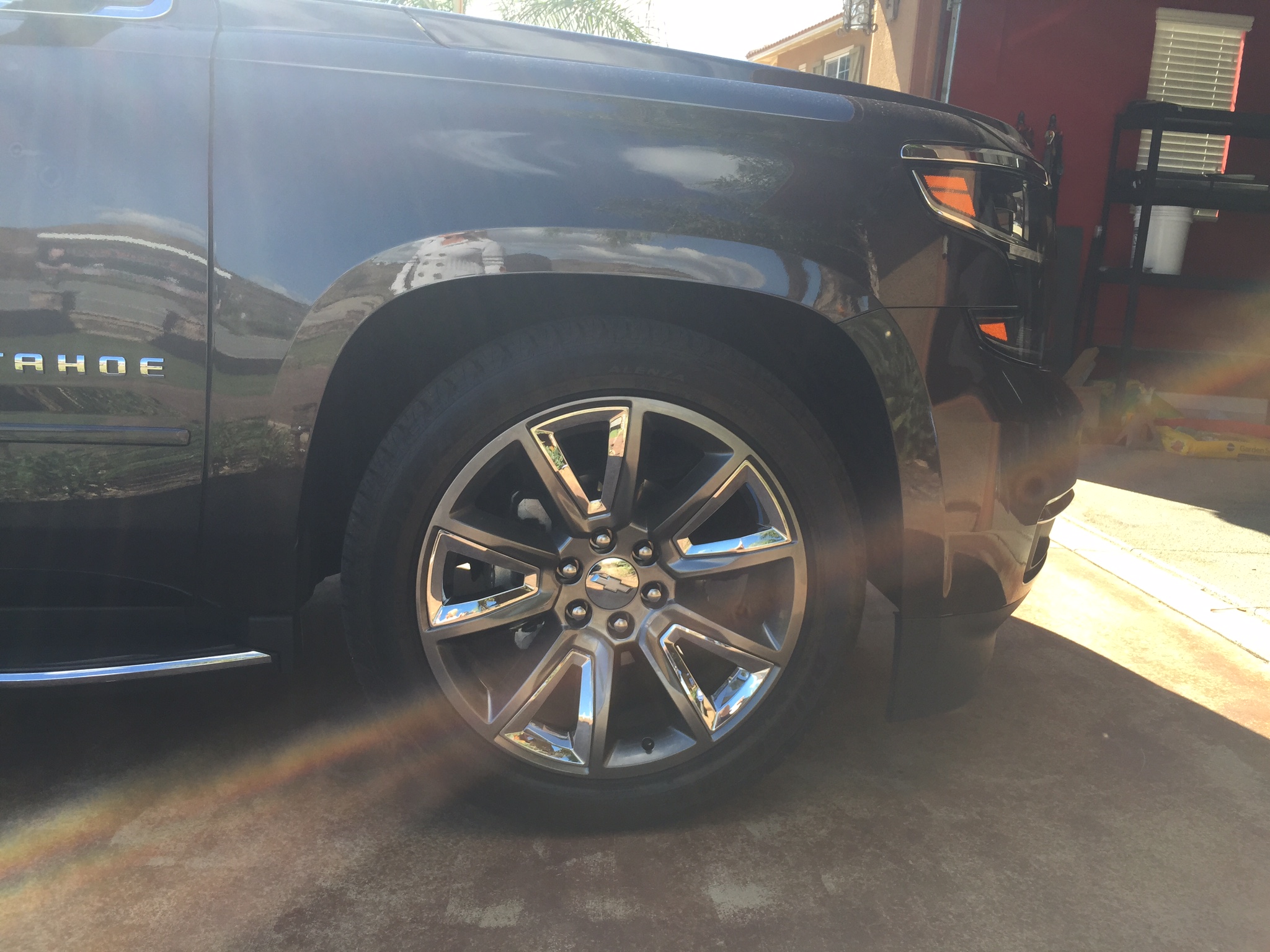

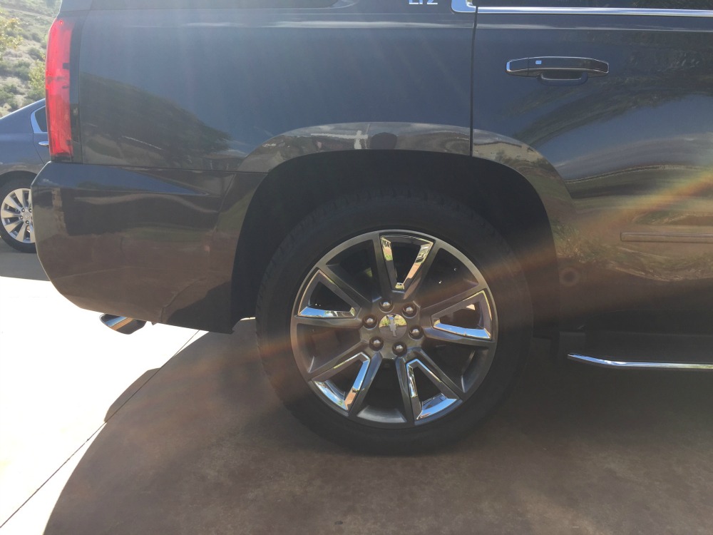

Lowered our '15 Taco LTZ. Used the McGaughys 34213 kit. Advertised 2" drop spindles in front, and 3 springs in rear. Install was straight forward. Took about 2 hours to do the front and about 45 minutes to do the rear. I did this in my garage at home using standard tools, jack and jack stands. No special tools are needed (spring compressors, ball joint tools). This was my first time lowering a vehicle, but my mechanical abilities are probably a little above average. Instructions included in kit are accurate and easy to follow. I like the way the front turned out. The rear still looks a little higher than I would like, but as I write this, the kit has only been installed for an hour. So, Im hoping the rear will settle another inch or so (fingers crossed)
Before
After

this kit sits high in rear which ive swapped out locally. Please pm me I will walk you thru a few steps to get it lower. If its not enough I have the correct springs to bring it down where you want it.

That's how my 2 inch rear sits.
Tony is right though.
Looks higher in the back than a 3 inch.
It may settle.
