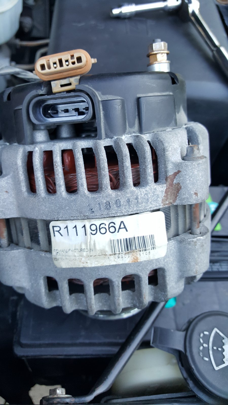

Would it be possible to use a 130 AMP R111966A
alternator in place of a 145 amp DR44G Delphi

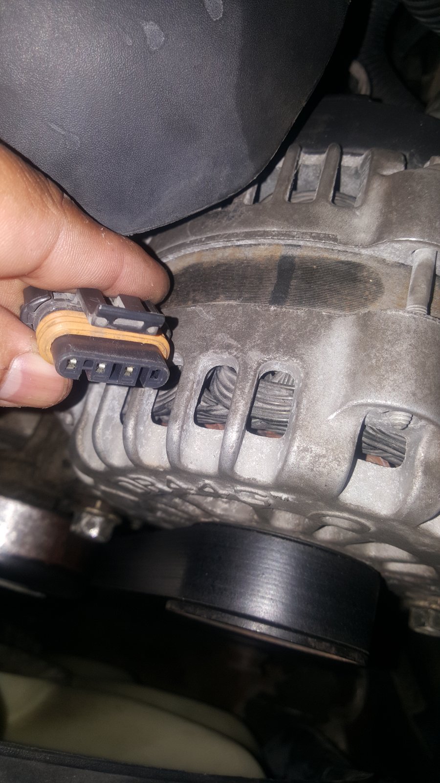

alternator? Would the 3 prong wires from the 145 amp alternator work on the 2 wire alternator?
Im also having issues with a ground i think. One headlight brighter than the other. Have to tap the dash for the lights to turn on and also tap the headlight to turn on as well. Any ideas on where to start or check?

If your Tahoe is spec'd for a 145 amp 3 prong alternator, I wouldn't try to fit a 130 amp 2 prong alternator on it. Its a fairly common alternator and you should be able to find one.

This. The factory alt is barely strong enough as is. Please dont downsize further
