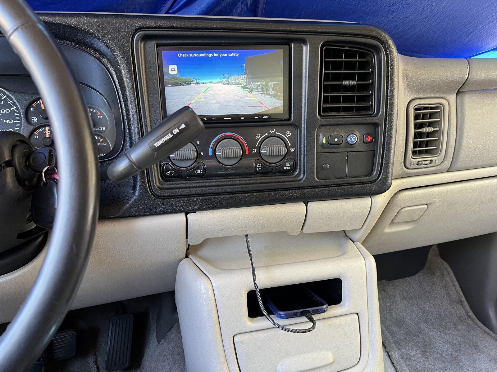

This is a first-world problem on GMT800s, for sure. Same on my 2001 GMC Yukon. Most 12V cigarette lighter USB chargers have a power on illumination light, so if you leave the charger inserted you will draw power off the battery. Not much, but that’s not ideal. I have to admit my solution was overkill. I installed a new Double-DIN head unit with a USB-C outlet included on the back, and I ran the extension wire around thru the dash at the charger panel. I’ve since decided to move it again and run it thru to the center console box.

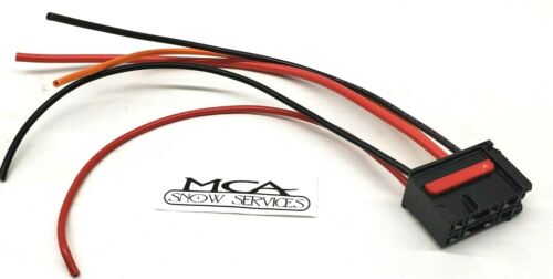

just buy a switched cig plug no chopping wires

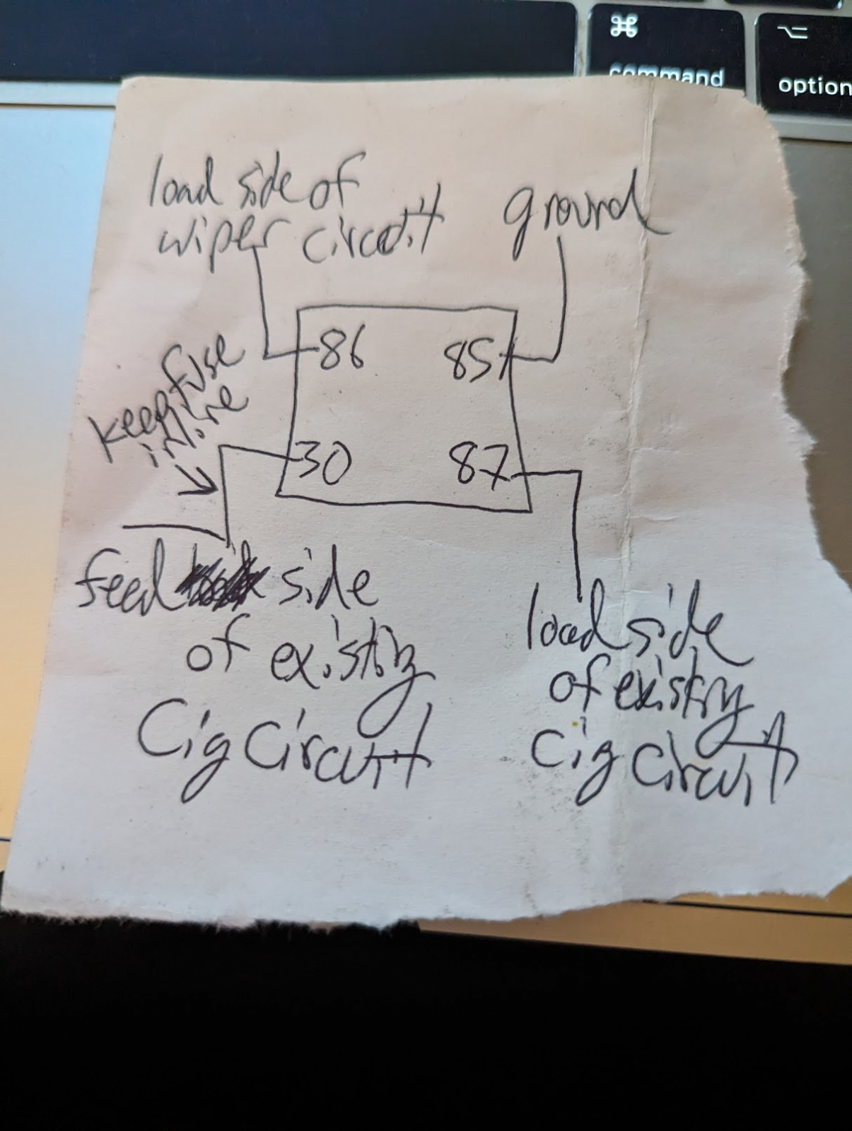

Why not hijack the wiper tap to just trigger a relay installed nearby, then have the following taps.
(see pic) you could install the whole thing just alongside the fusebox and almost zero additional load goes on the wiper circuit and the original fuse size is retained for the cig lighter
