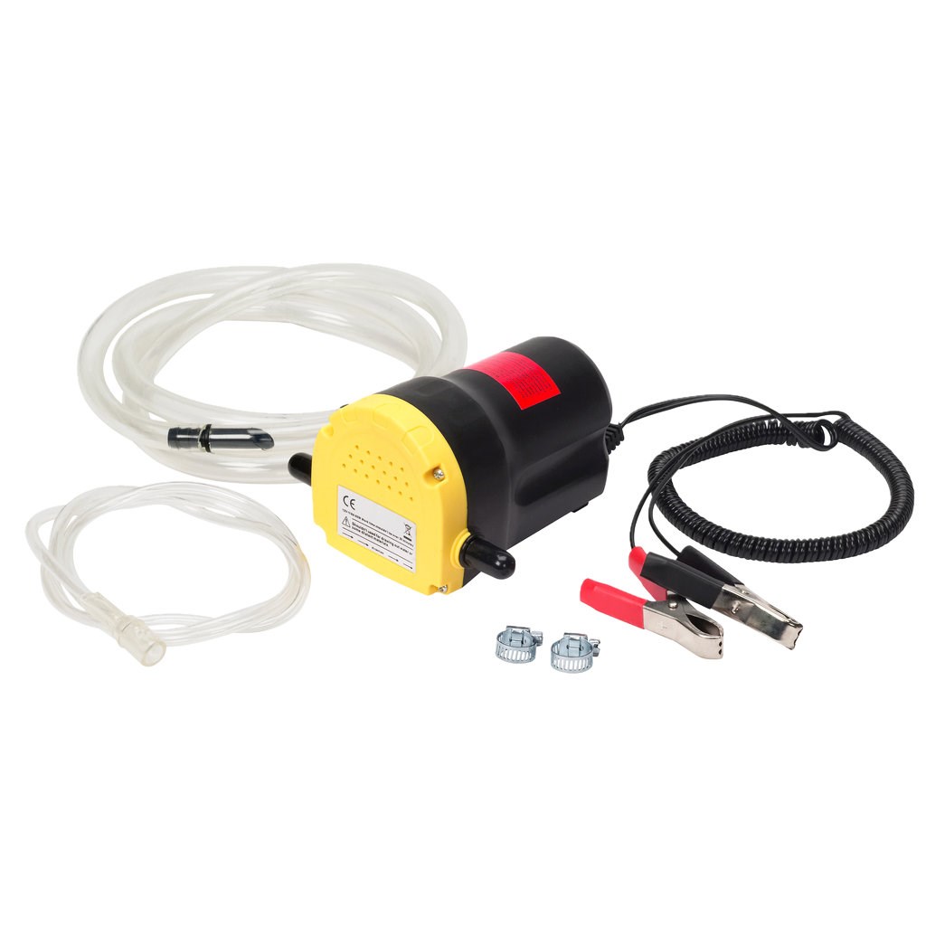

Can i just use a electruc pump in the dipstick tube and suck some out now? Like this:

You may, but you'll get less than a half of the fluid this way. Better option is the fluid transfusion through the ATF coolant line up at the radiator. Complete fluid exchange.
