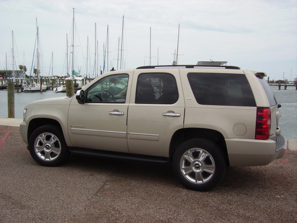

Yep, the L9H 6.2L which has VVT but no AFM..
Looks the same as any other LTZ, just more GO.. Going to be removing roof rack, but other than that it will look stock.
Has AirRaid MIT w/ dry filter, 3.5" exhaust with Flowmaster BB 50 Series muffler, Hotchkis Sway Bars and V rated Goodyear Eagles. Not going to lower it as it is 4WD and want to be able to go exploring on our upcoming West Coast & Alaska trip..
Just a nice American Grand Touring Tahoe.
