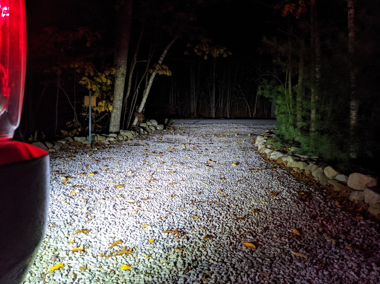

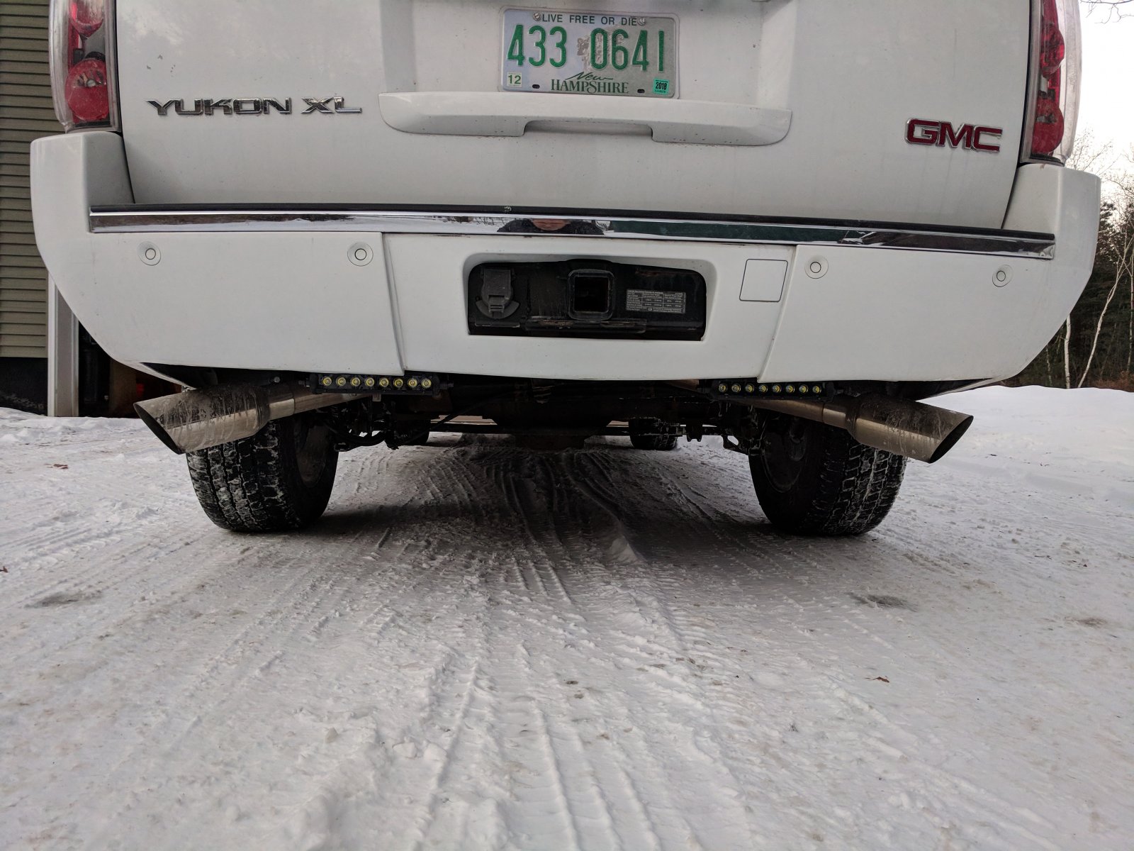

I had two 8 inch LEDs installed under my rear bumper to provide better backup lighting. I believe that the power source was the cigarette lighter power source in the rear. I have a manual switch under my dash, so that I can use these lights as work lights or for lighting assistance when loading stuff in the back of the truck., as well.
