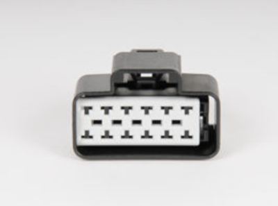

So my heated/cooled seats are not working. This seems to be a common problem. I pulled the module connector under the passenger side and it had the burn mark that everybody talks about. I ordered a new module (pic attached below) and pins. Stupid me forgot to take a picture before I cut the wires. Does somebody have a picture of where which wires go?

Did this resolve your problem? I ask because my passenger side heated seat button on the door will not lite up, and the seat does not heat, are those the same symptoms you had?

It did not fix it. Have not had a chance to troubleshoot further.

Might be better off finding the same truck as yours at a dealership and checking out the harness.
I resolved my issue by reseating the connector in the door !

Did you get the picture you needed to get the wires back in? I have some pictures from mine - also a 2009 Tahoe LTZ. The wires had obviously been mucked with before I bought the truck so I can't guarantee the wire colors are right.
Yeah, mine was pretty bad.
