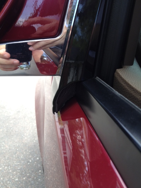

I see now... I think. Kind of dark.
Hmm... I think that might bother me....
You can't see it from the front or from inside. The only time you see it is walking up from the rear and you have to be looking right at that spot. otherwise, it just blends in with the black of the mirror.
I have pretty bad OCD and it doesn't bother me.
Haha! Got it. Hey, the overall look is awesome, anyway. Your truck is beautiful.

Can you take another pic of the glass part of the mirror but not hold the camera in front of your face this time? I am really on the fence about whether I want to do this mod.
:laughing1:

looks good, my question is this i got a 2011 yukon i would assume i would have to buy the mirror switch with the fold button for them to fold with some programming and how could i make the blind spot work? is that even possible? either way they look good

I hate to revive such and old thread but I've not seen the answer elsewhere.
Is it possible to add the whole chome trim piece from the Escalade windows (which includes the blacked out B pillar) to the Tahoe/Yukon? I'm guessing that would solve the problem with this gap.
Mirrors look awesome though and I'm considering it for mine.
Nope. It's the entire window trim surround and it's different. You'd have to install an Esky DOOR to do it.

The gap honestly isn't that bad. I did this mod on an old vehicle and I'd do it again. Even with the gap.
x2
My OCD is pretty bad and I don't even notice it anymore... until this evening when I get in my truck after veiwing this thread again :D

I think Nathan needs to buy Esky doors to fix his problem :imo:

Well that is a bit more of a project than I'm looking for. :)
How much of the mirror can you piece together by combining old and new mirrors (I've got a 12 with power fold, blind spot, and red signals)? Can you re-use the top cap or will you need to get the entire mirror painted to match?
I see some on eBay but most have broken power fold. Is that tough to fix?
