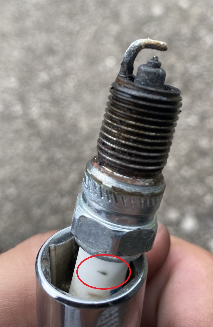

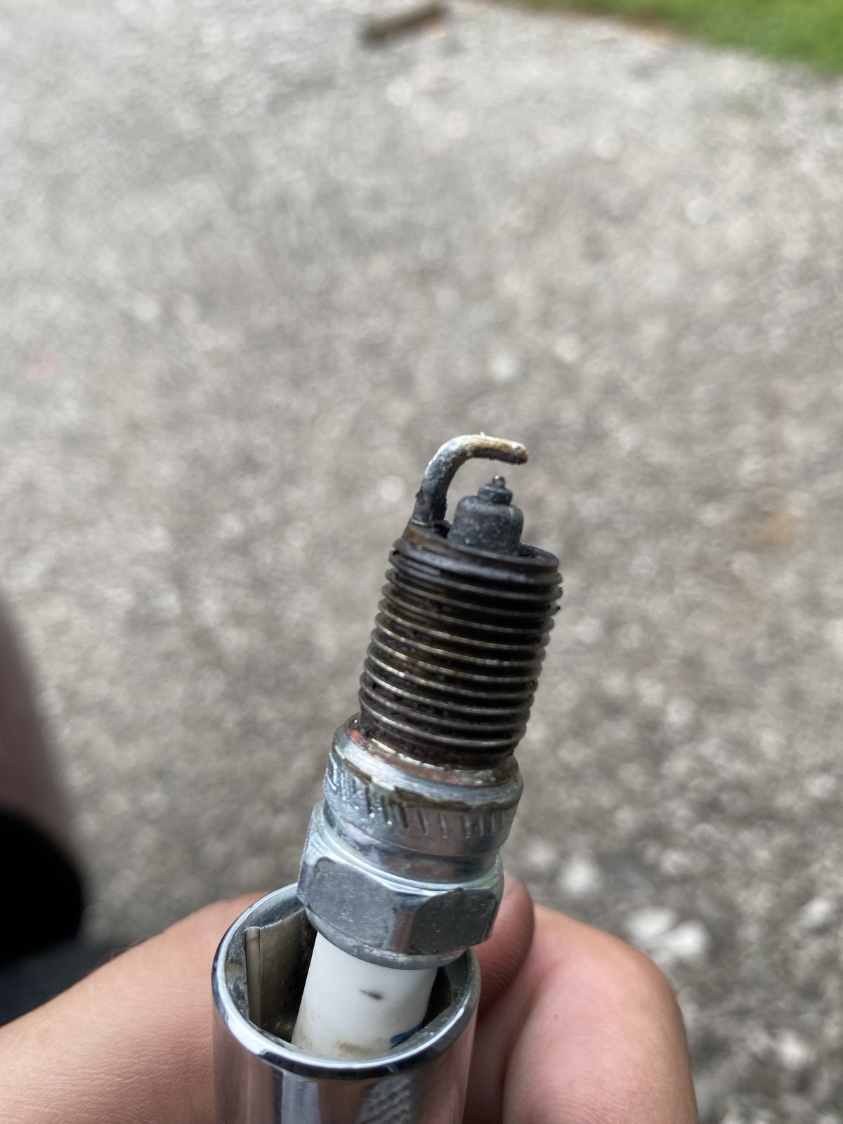

I checked today to make sure I didn’t have a stuck lifter, checked compression it was all good. The #1 plug was the problem. Replaced it running fine now, engine light gone.
