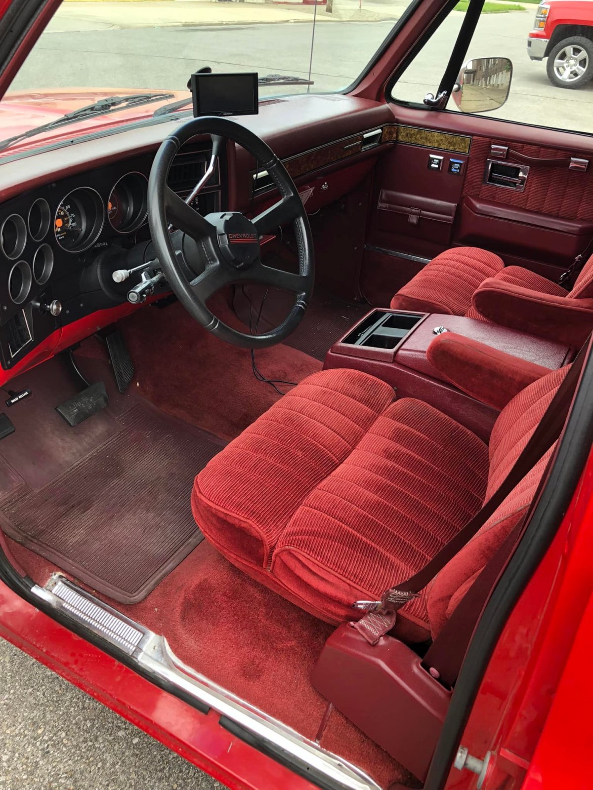

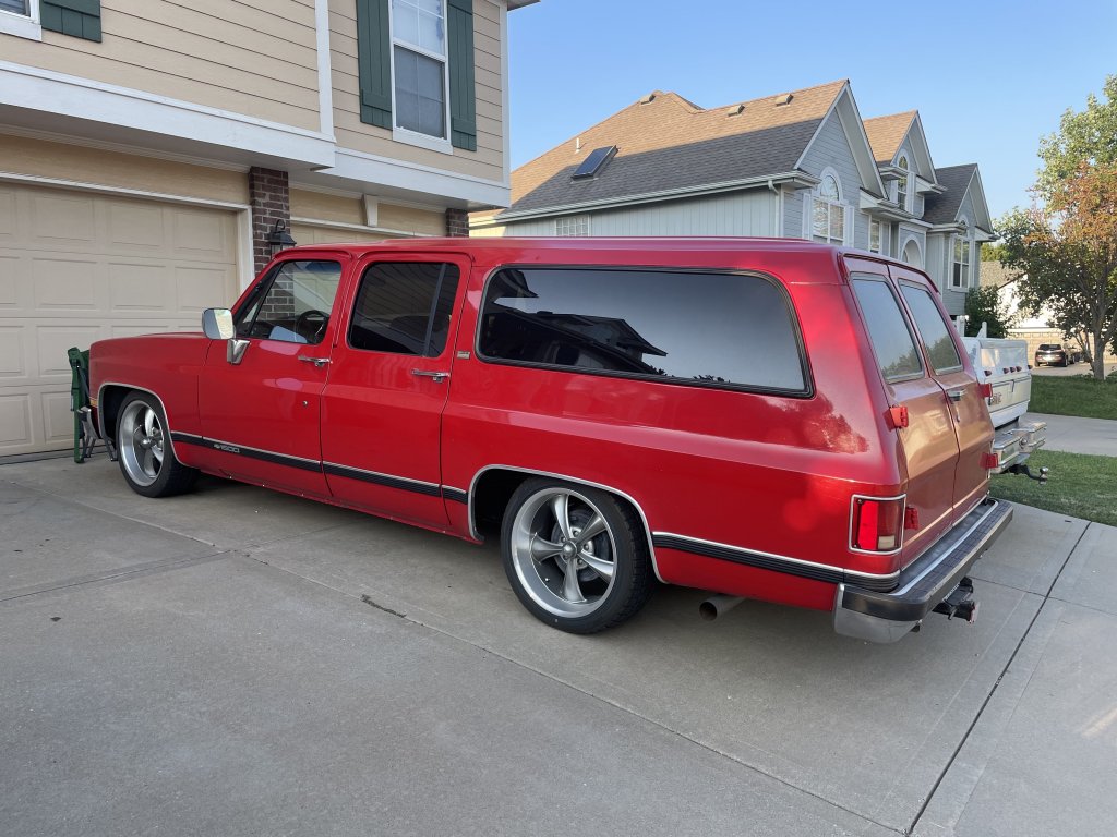

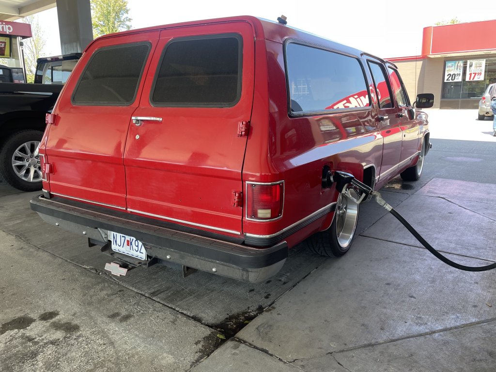

Picked her up today. Drive her five hours home from Waterloo, Iowa to south of KC. Overall did well. Discovered a leaky radiator up in Des Moines. We did the right thing and closed the hood, pretended we didn’t see that and bombed our way home :happy175: she did good! I now have a aluminum radiator, hose and tstat ordered to fix the issue.
Here are the details I know.
1990 Suburban R1500 350/700r4
112k on the clock
I’m the fourth owner
Rust free other than SUPER minor spots along the edge of the rockers and the driver front inner fender well has a hole in it and some scale on the frame from midwest winters. Nothing major.
Wheels are 20x8.5 Riddler on Falken rubber (245/45 front, 275/40 rear)
For those that aren't familiar with these this rig has rear heat and no roof rack from the factory. Both are very unusual for the time which adds to the cool factor a little bit more. :)
