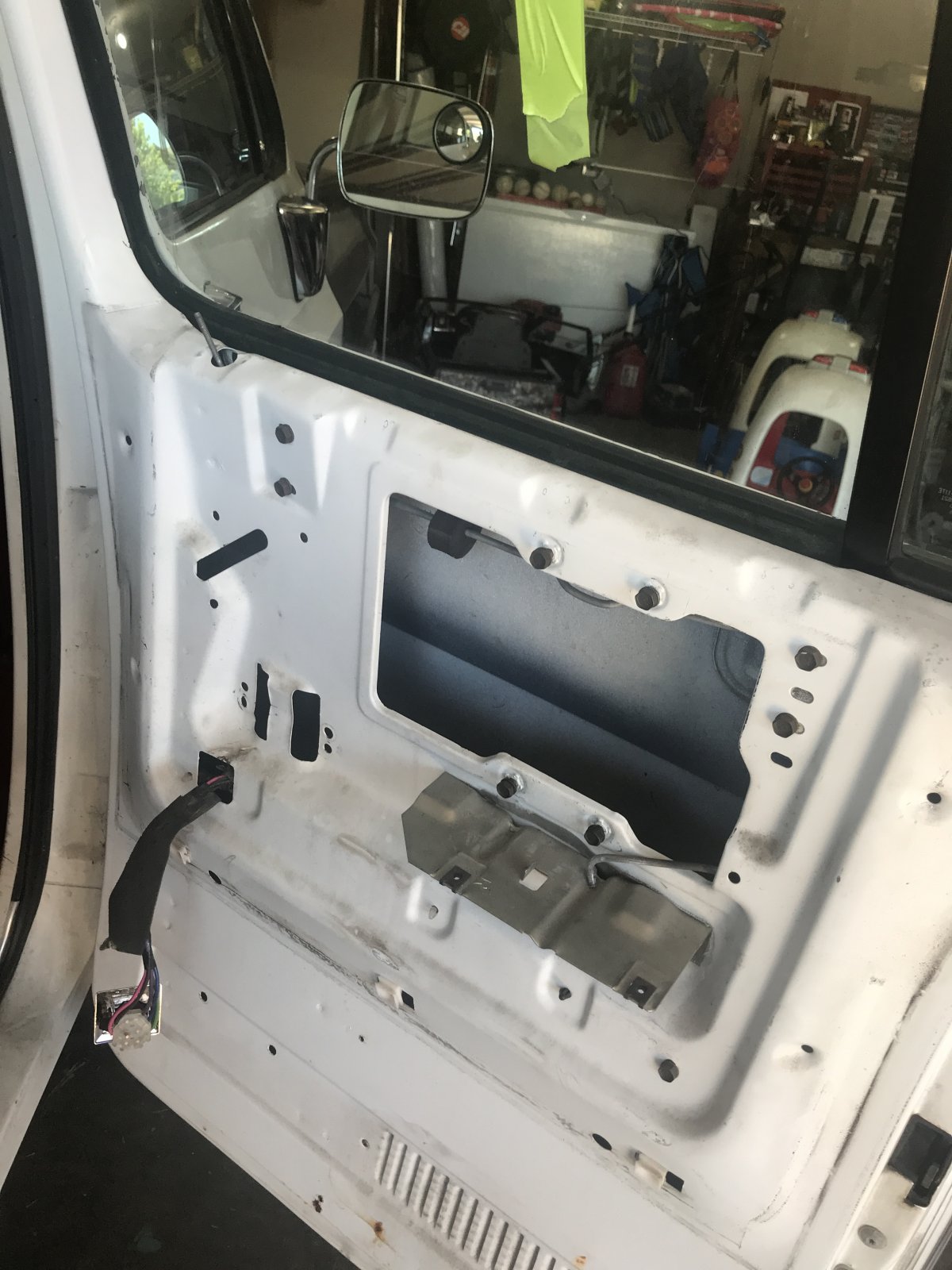

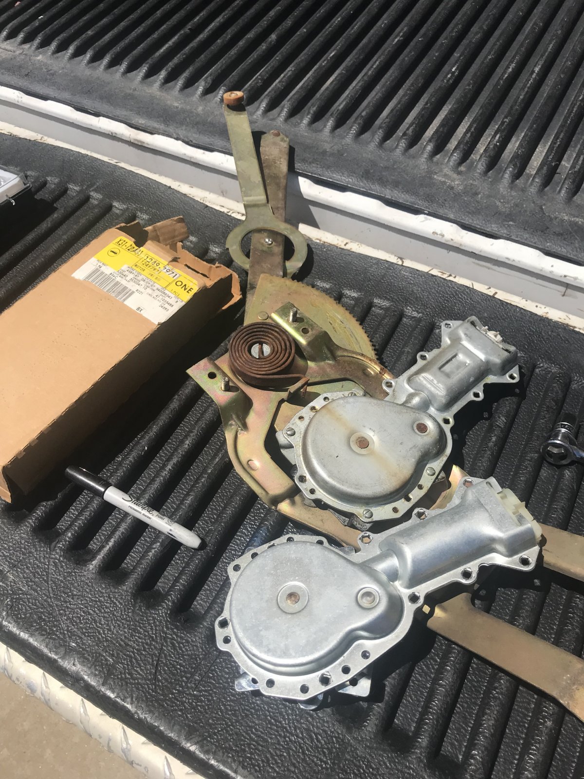

Finally about 1/2 way through with the 4th door in my quest to restore the guts and rubber gaskets and felt of each door. Should be done with that fourth door this week or weekend. Today I ordered headliner material to address the saggy headliner here soon. I'm going to remove the rear window to get the headliner out and either put the existing solid rear window back in with a new gasket or put in a sliding rear window. Haven't quite decided yet. A sliding rear window would allow more air flow throughout the cab and I've always been partial to a rear slider but we'll see what happens.
After that, the only major thing left in the interior is carpet and may upgrade the audio when I do the carpet. I'm going to address more exterior stuff before I worry about carpet and audio, though.
50,943
19,372
Got the fourth door finished up this weekend with felts, rubbers, window motor and panel refresh. Now on to the next thing

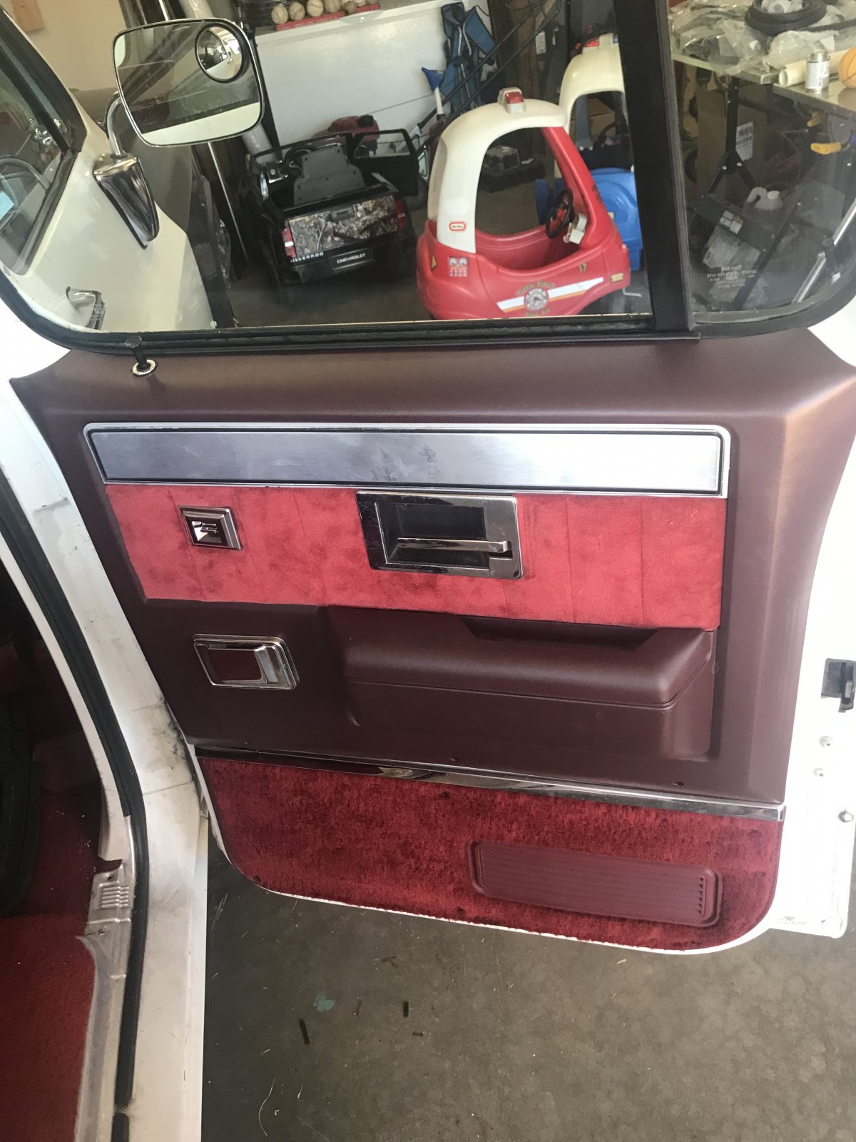

Did you repaint the burgundy? How'd you refresh cosmetically? Looks awesome!
Yes. Used the burgundy offered by LMC truck. I normally use SEM products for interior but figured I'd give Color Bond a try and it worked pretty well for all four door panels.

From the pics it looks great. Did you need to use adhesion promoter? Also--how were your panels before the respray? I'm an interior guy, so--you know....lol
50,943
19,372
Yes. I used surface cleaner and cleaned it up really well. Applied adhesion promoter and then applied about 3 coats of the color. Prior to the refresh the panels were a very faded and sun beaten maroon. I didn't take a before pic unfortunately. :)

I've see panels like those so sun beaten that they actually flake. I'm assuming yours weren't that bad?
50,943
19,372
No, they weren't that bad. The last pic is actually a brand new OEM panel that I applied the paint to (started out blue). The original panel there was actually cracked on the top portion so it was pretty bad originally so I just replaced it and got lucky to have a brand new OEM panel. The other three panels were not nearly that bad. Just faded pretty good but no flaking.
