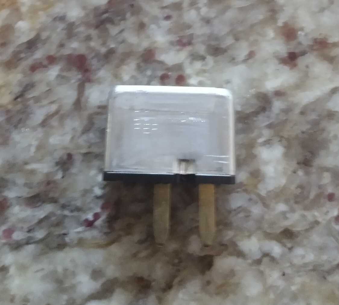

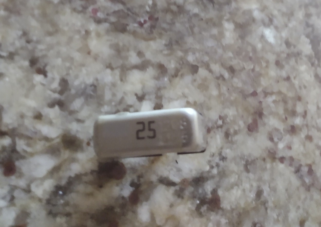

When I press the unlock button (either on the door button or on the remote) I can hear a relay clicking. So today I took the dash apart enough to see the relay (see attached pictures). It is on the back side of the fuse panel. Took it out and on the top of it has 12088575 and looks like it is 25 amp. On the side of it is 6182. It is 2 prong, tested it and has good continuity.

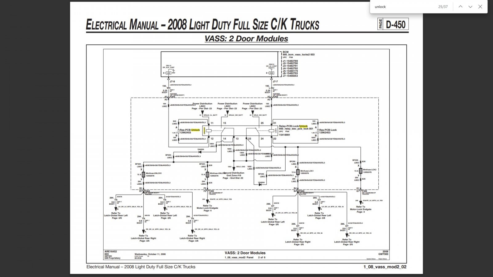

See you have the Lock/Unlock relay and the Unlock relay.. makes perfect sense right?
Looks like tan and grey wires to the motor.. something must flip polarity or something something..

That's not a relay, it's a circuit breaker. Relays need at least 4 contact points, and sometimes have more.
Ah.. makes sense why it has 25 on there.. Thank you Fless!
That circuit breaker is for the left door or doors.
Both rear doors are connected to the same circuit, Fuses for unlck1 and lck1..
lck2 and unlck2 fuse is for the endgate? Seperate relay for liftgate, so I'm not sure what endgate is, seperate liftgate lock maybe, but it is also connected to your doorlock relays. So endgate should be locking but not unlocking for you as well.
Looks like both lock and unlock relays are normally grounded, and when you hit the switch, one connects power to lock, or the other connects power to unlock. They utilize the ground of the opposite relay.
looks like relays are on built in the pcb in the instrument fuse panel. .

Any chance you have this for the 4 door vehicles?

Hi BSarte, that diagram is for the 4 door vehicles. The diagram is for the rear doors.
I am guessing VASS is just an acronym for the system like 'stabilitrac' which is integrated through the ecm, brake module, steering/yaw/wheel sensors etc.
Main thing is the locks use the same wiring for lock and unlock and for both doors. And if the relay can be heard clicking, then the relay is getting the signal from the BCM.. so it seems to me like the relay switch contact maybe bad.
