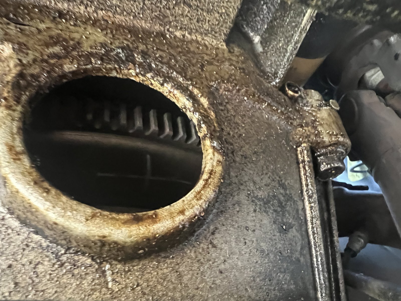

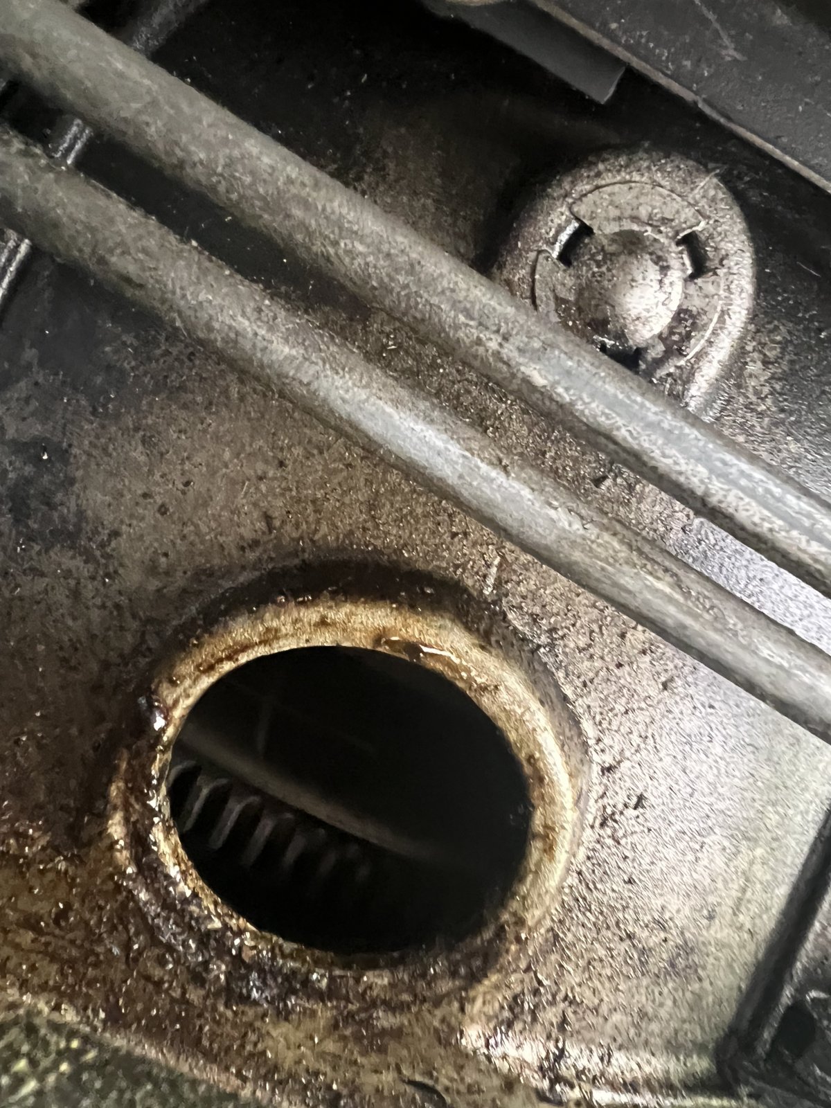

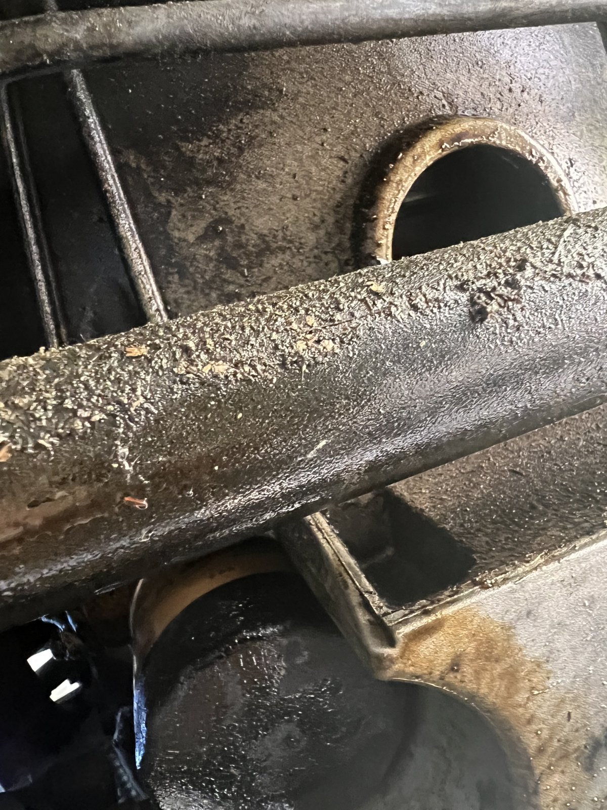

I recently bought a07 Yukon Denali with the 6.2, has 250k miles so it’s not new by any means lol. Runs and shifts great though. Now I’ll be honest, I’m no mechanic. I know how to do the basics but that’s about it. I was changing the oil today and went to change the filter when I noticed this hole behind the filter. Now I would assume these teeth shouldn’t be exposed like this but I honestly have no idea what I’m looking at. Any help would be greatly appreciated.

That is an inspection hole. The thing with the teeth is your flex plate. It’s just missing the cap.
GM Genuine Parts 24205900 Transmission Bell Housing Inspection Cover (62 mm) https://a.co/d/ec3ixRn

Thank you so much. I’ll see if I can’t find another cap at the auto parts store. I was concerned because I noticed there was no fluid in there and didn’t know if that was something they should be lubricated haha. Sorry if it was a dumb question. Thanks again.
