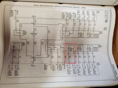

My driver's power seat will do everything, but forward and backward. It will click like it wants too, but nothing. I checked the track for obstructions and disconnected people wire behind seat panel. Any ideas on more troubleshooting?

Test light to motor power wire connector- fwd, back. switch to other wire-fwd, back. If these check out motor bad.4 tests, 2 light on.
