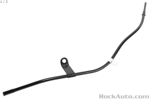

Interesting.. Here's some photos from rockauto..
The 07 has a longer dipstick.. 808.05mm vs 742.8mm, both double o-ring
Both tube's have the same diameter..
I would imagine it should work unless something is in the way on the '12 model that isn't in the '07..

New tube could be stronger, bracket is shorter and bolts more centrally on the tube.
Why extra bends in tube and spiral the stick?
OK, the reason I see shown for a spiral tube, the dipstick is more centrally located and thus more accurate..
Sure, I guess if someone was to force a dipstick sideways or you put some bends in the dipstick?
Seems like an answer in search of a problem to me..
And the rivets, supposed to strengthen that section of stick so it doesn't bend..
I don't recall that being a problem.. and the fix would be a new dipstick if it ever happened?
But now, the old straight dipstick costs more than the twisted-riveted new one.
