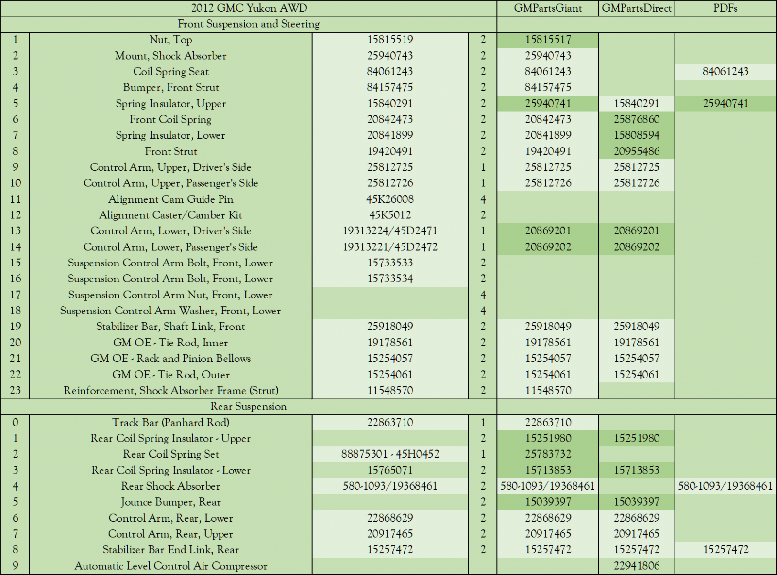

I have not found a quality kit. My own preference is GM OE parts.
I can provide a list of part and part numbers but you'll have to double check them to your vehicle and of course availability and decide what you want to replace and re-use.
