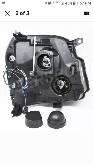

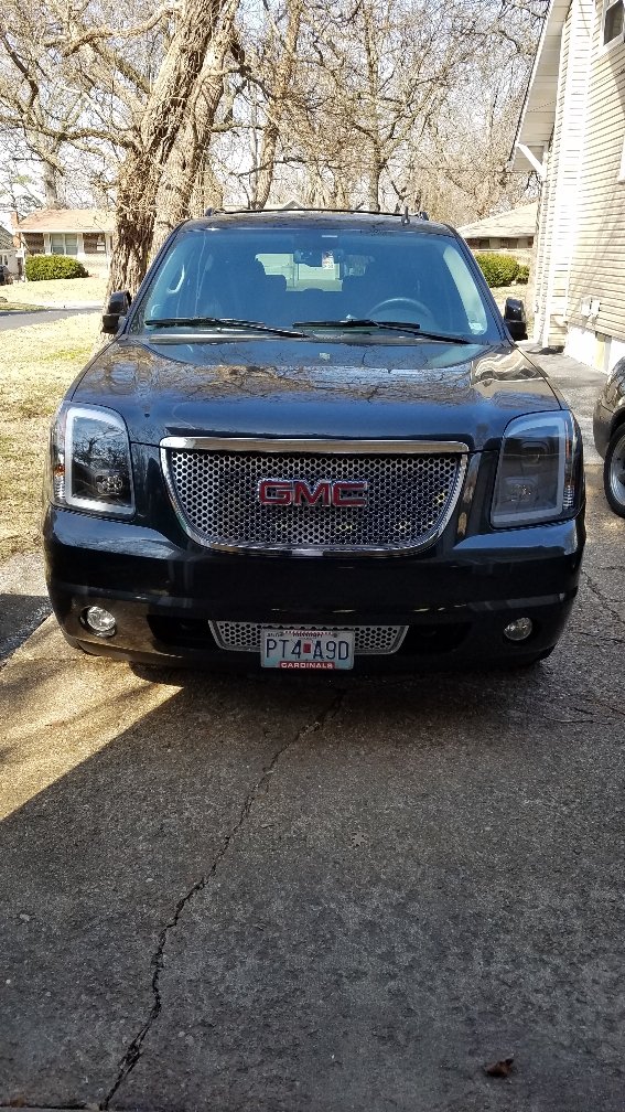

how is the view going down the road at night hi/low?, are the bulbs accessible from the back? the pictures in the listing online look like they are all sealed up on the back
Apr 11, 2018
7,124
14,376
St. Louis
I haven't gone down the road at night yet. The high beams aren't in projector lenses and light up the whole garage door, not just the bottom half. The openings in the back for the low/high beam bulbs are rubber dome shaped that pop into the back of the housing.

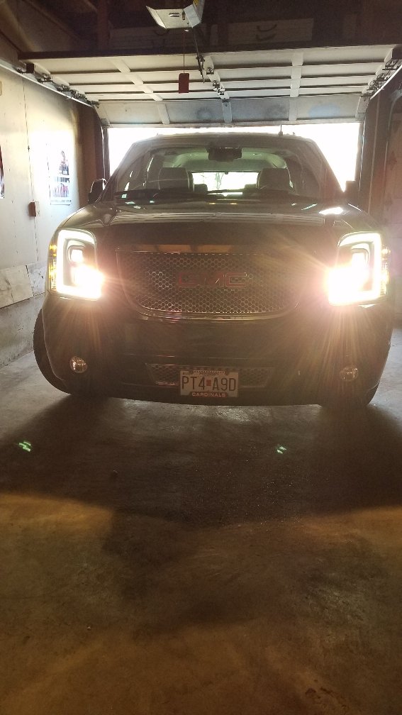

Drove it tonight. These lights don't appear to light up the roadway as much as my OE lights with Silverstars. It may be because they are smoked slightly and probably came with cheap bulbs (or the combination of both).
I think I'm going to pickup a pair of better H7 bulbs

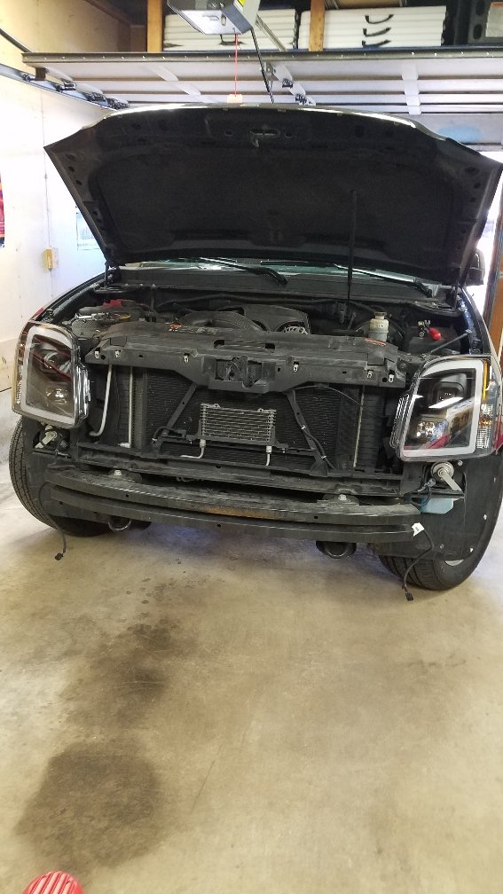

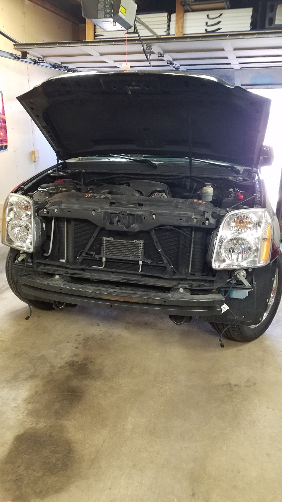

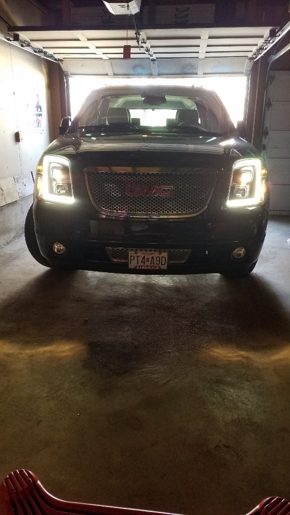

I installed these today. I went with removing the entire bumper, just made it easier. I turned on/tested them before re-installing the bumper, and found one of the parking light bulbs was burnt out. I had to run by the parts store and pick up a 194 amber bulb. I'll get beam pattern on my garage door pics tonight to compare with the stock lights.
I still may need to adjust them

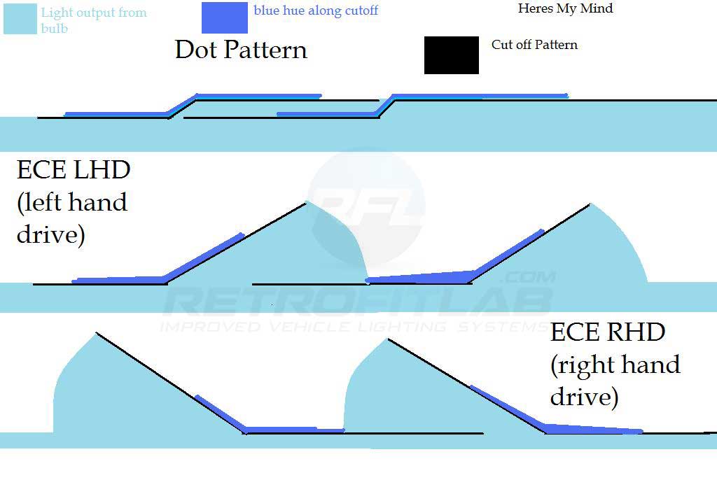

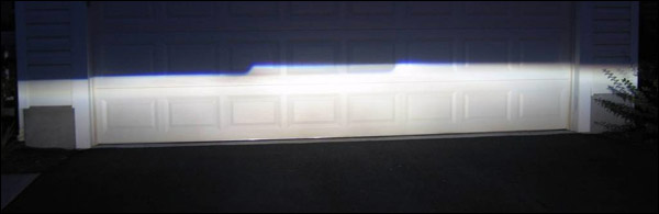

that beam pattern is for right hand driving it's correct
It is not correct. The "step" on the cut-off line (which by the way the left one is all jacked up), steps up to the right which is for LHD vehicles, DOT standard. For RHD vehicles the step would be in the opposite direction which is ECE standard.

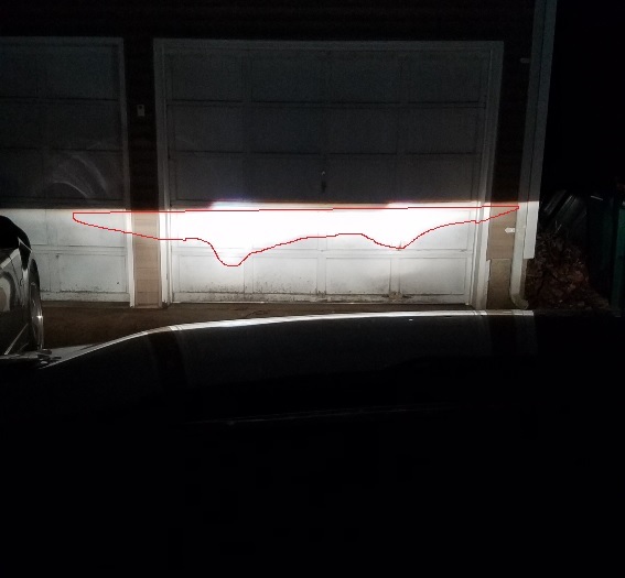

You have "less" light on the road because of the major hotspots those projectors are creating. You essentially have two cut-off lines. The one on top which is suppose to be there and the ones on the bottom that I marked in red. There's very little uniformity of light output evenly spread out. You'll have the same results with any H7 bulb you put in there.
Here's an example of an even spread of output

The light output is just dimmer/more yellow than I'm used to. I'm sure these didn't come with the best/brightest/whitest bulbs in it....lol

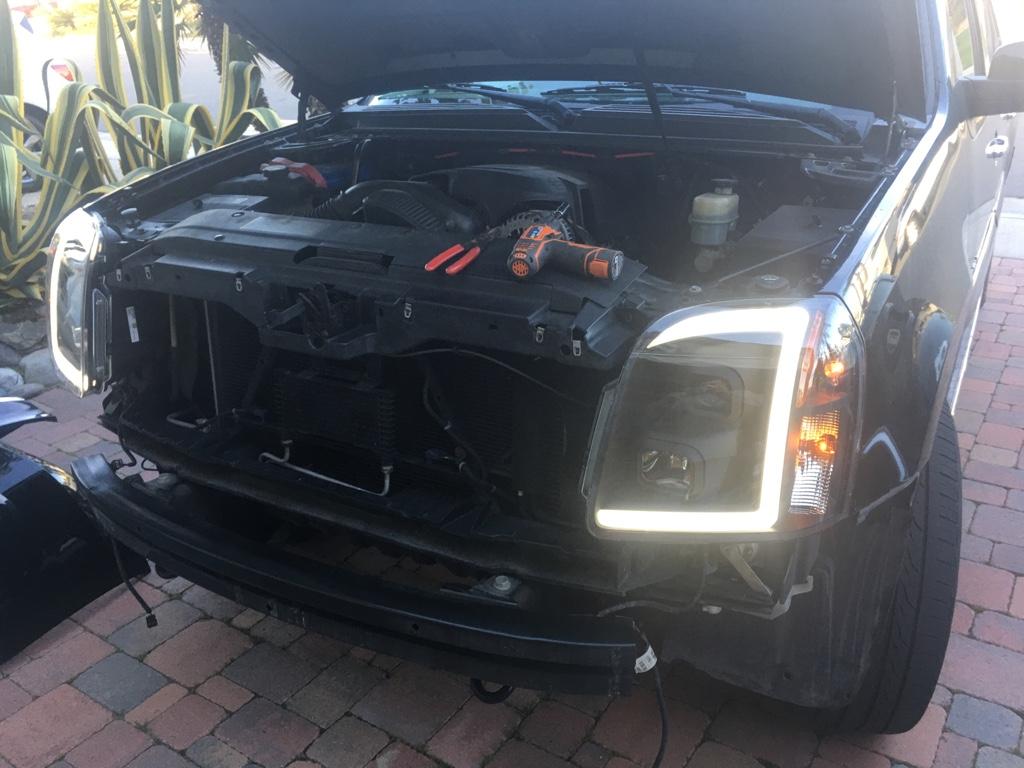

If the truck is driven with the parking lights on, the DRL operate. The DRL are on all the time with the headlights turned on. Now all’s that needed is a definite answer to see if the BCM won’t freak if the DRL are tapped directly into their circuit. Another option that’s not as convenient would be to run a dedicated feed w/ key on directly to the DRL and isolating it from everything else. I’ll post up the 5k PIAA lights installed in the new lights tonight.
I regret that I did not notice they are tinted blue. Not my cuppa tea but not going into the bumper cover again to change it doesn't sound like fun. Stick w/ the Silverstar Ultra if they make them in H7. It was a bummer that the fresh OE H13 bulbs could not be reused. Only the projector / driving lights are height adjustable, but it's sufficient to dial them in.

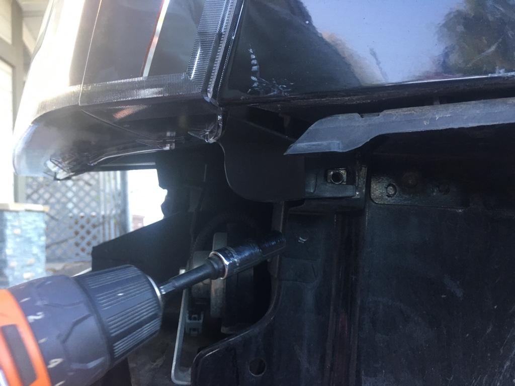

That even spread of light and clear cut off Dario posted is the product of a higher build quality in the projector glass. Below is the headlights lower mount arm / bracket that keeps the headlight assembly from being easily removed. It hides at the front corners of the truck just under the amber reflector behind the bumper cover.

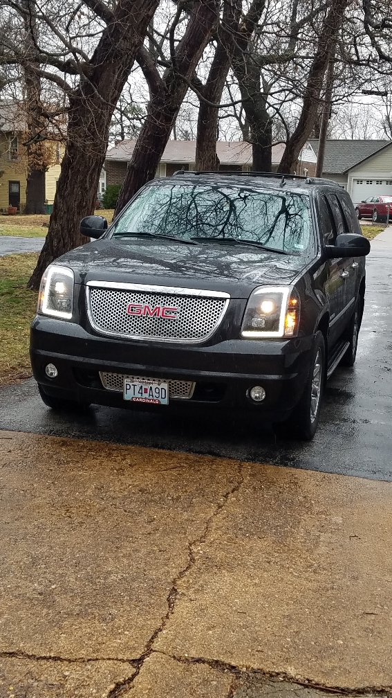

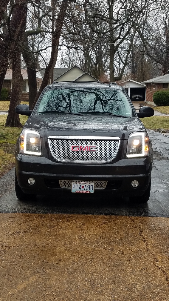

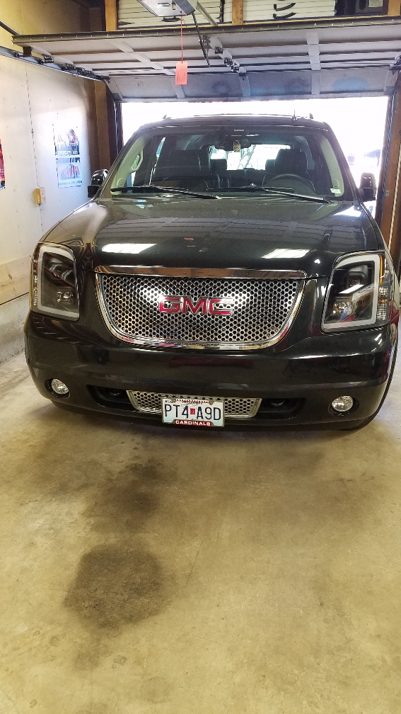

It's a gloomy, rainy day here, and I got a couple pics just a few minutes ago when I pulled in at home.....
That bracket under the yellow parking light doesn't need the bolt fully removed, just loosened. It has a U shaped opening.
