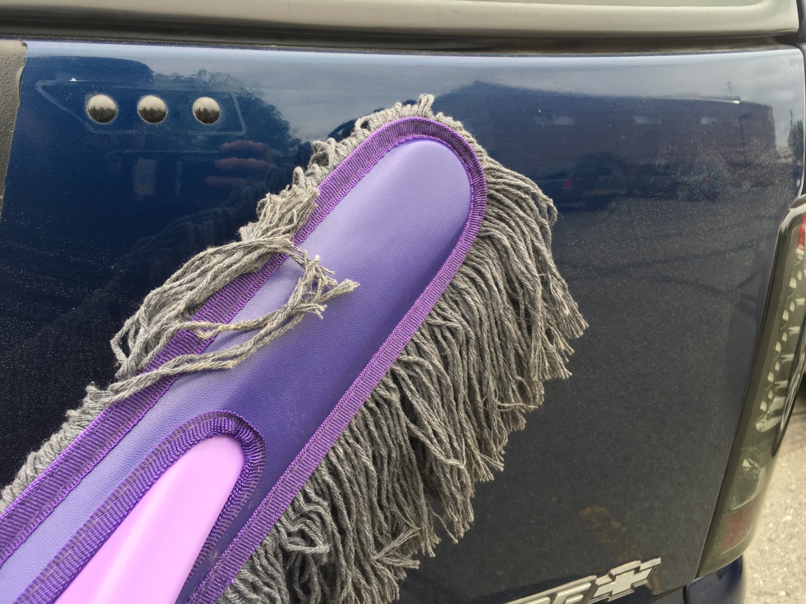

To apologize to my baby for not treating her right with the brakes I bought her the original California duster. Pollen is crazy this year

I've heard TONS of professional auto detailers say those things are the devil! Lol Supposedly they cause scratches and swirl marks. Especially when you use it over and over again and get dust caught up all in the fibers. You are basically just dragging dirt across your paint. I'm sure just using it 2-3 times to get pollen off of a clean car would not make hardly any scratches or swirl marks. But using one regularly in between washes will definitely be dragging dirt across the paint. I know you have spent a lot of time polishing your paint, so I'm just saying be careful with that thing and don't use it when you should really be washing it or using some detail spray and clean microfiber towels.

Yea for the duster if you know how to use it properly it it’s fine. I will only use it with light dust and pollen of course.
