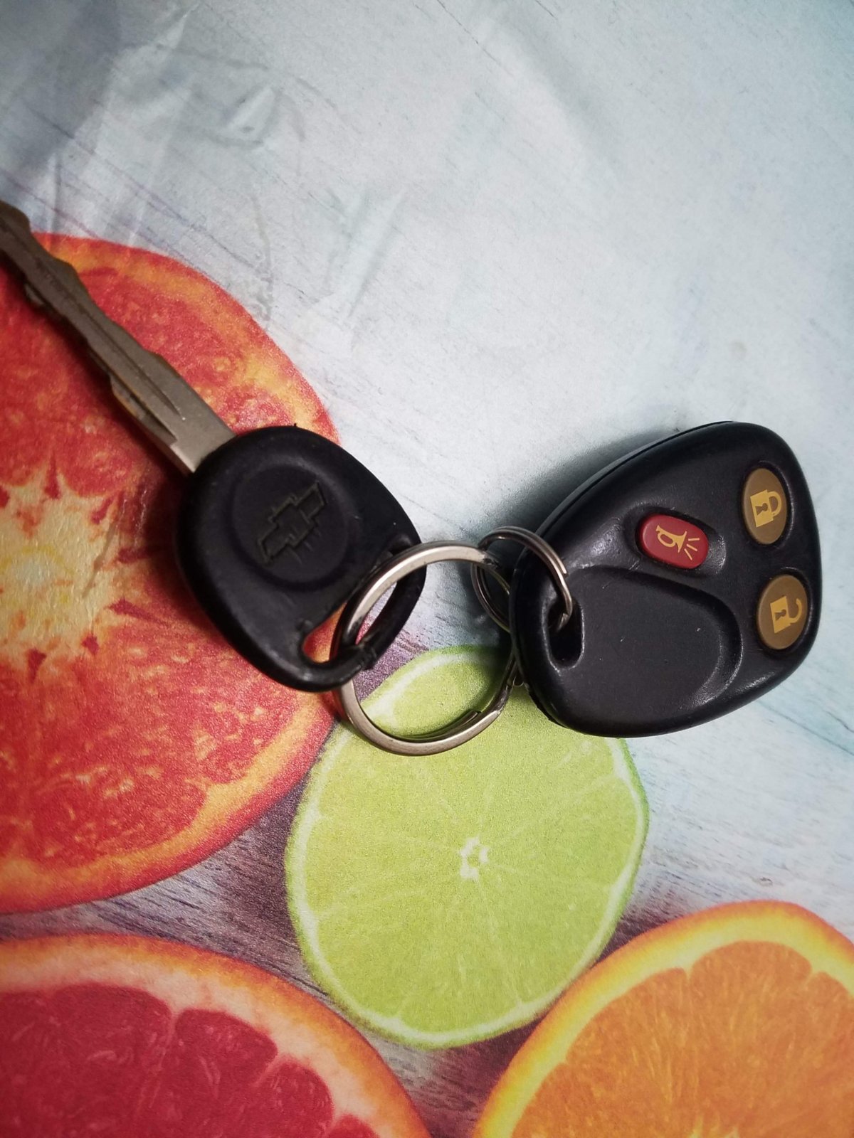

I couldn't stand how my new GM key is longer though, i ended up picking these up
https://www.amazon.com/Chevy-Bowtie...1PC95NWY60Z&psc=1&refRID=8DJZWFTKM1PC95NWY60Z
OEM replacements, and when they brake Ive already bought 2 more, my girlfriend cut my keys for me at work made me happy

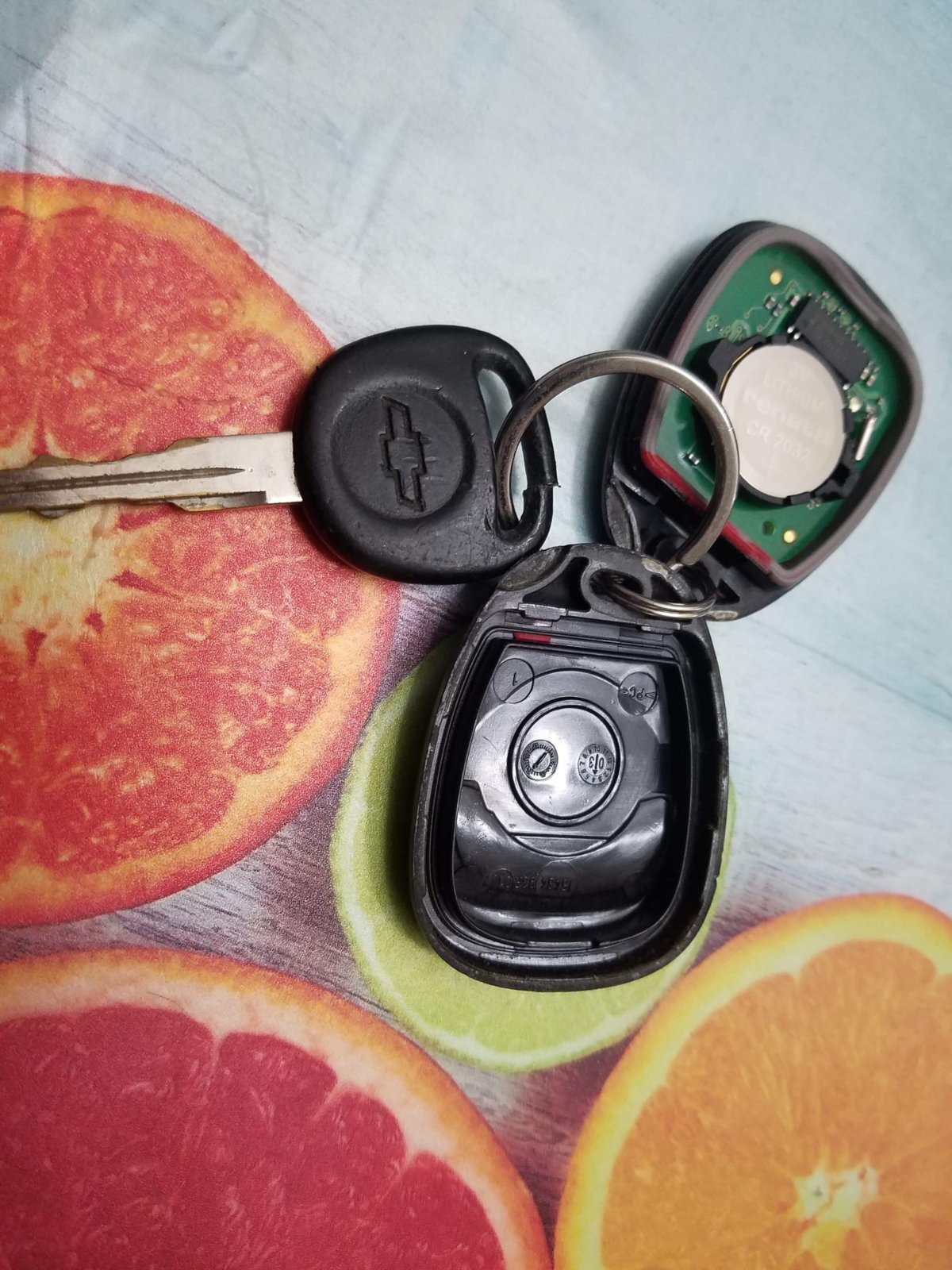

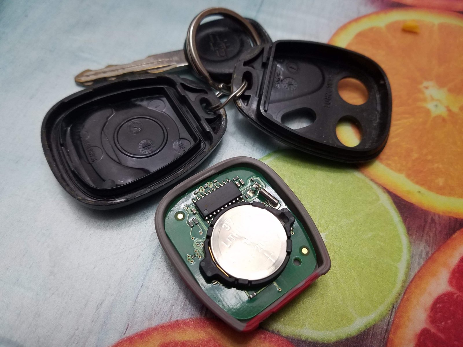

haha as for a good fob I haven't found one I bough two of the cheap amazon ones there range sucks I ended up just using the housing to replace that and the pads used the board from my original fobs though
and I know they break but they are the OEM style key, and I no longer keep my key on a heavy keyring it's on it's own, with just the fob hopefully or wont break anymore

Cool. Good idea. Does it just pull apart? Glued together or snaps in place?
it just snaps apart, the board lifts right out :) well mine did anyways. because my key fobs were so worn down that you couldn't see any of the three buttons the pads. I did clean all the contacts on the front of the board with isopurple alcohol before putting back together it works like new now
