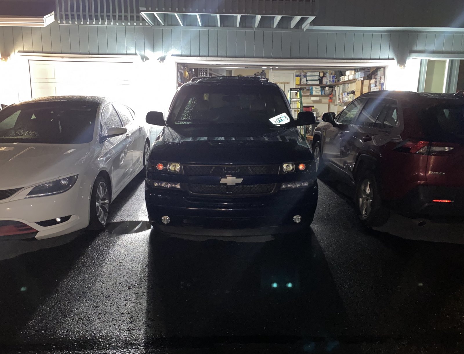

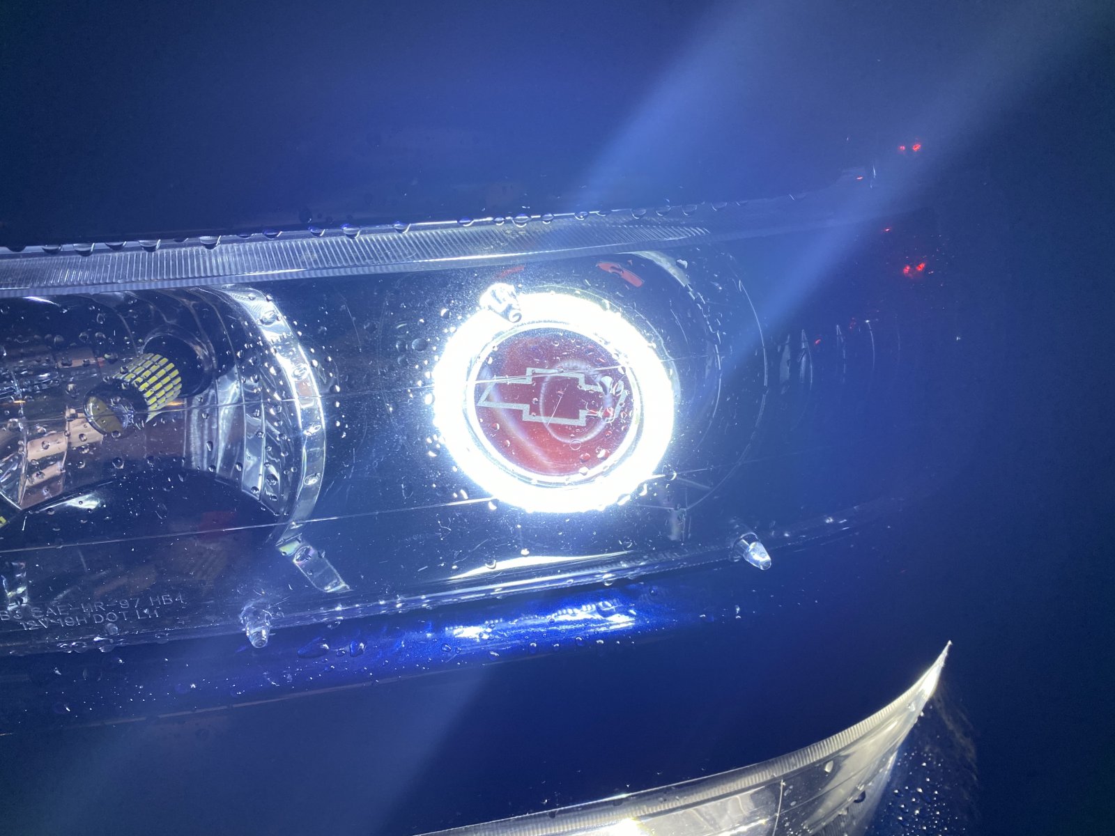

Pretty cool man! Don’t the led housings get pretty warm? I guess you used high temp paint though. Cool that you can see them in the daytime with just a little tint of blue / red.. good work, as usual. When are you moving from Ak? I want to commission you to build me some retros for my Yukon. [emoji16][emoji106][emoji631]

Nice work man. The lighting mod junkie at work.

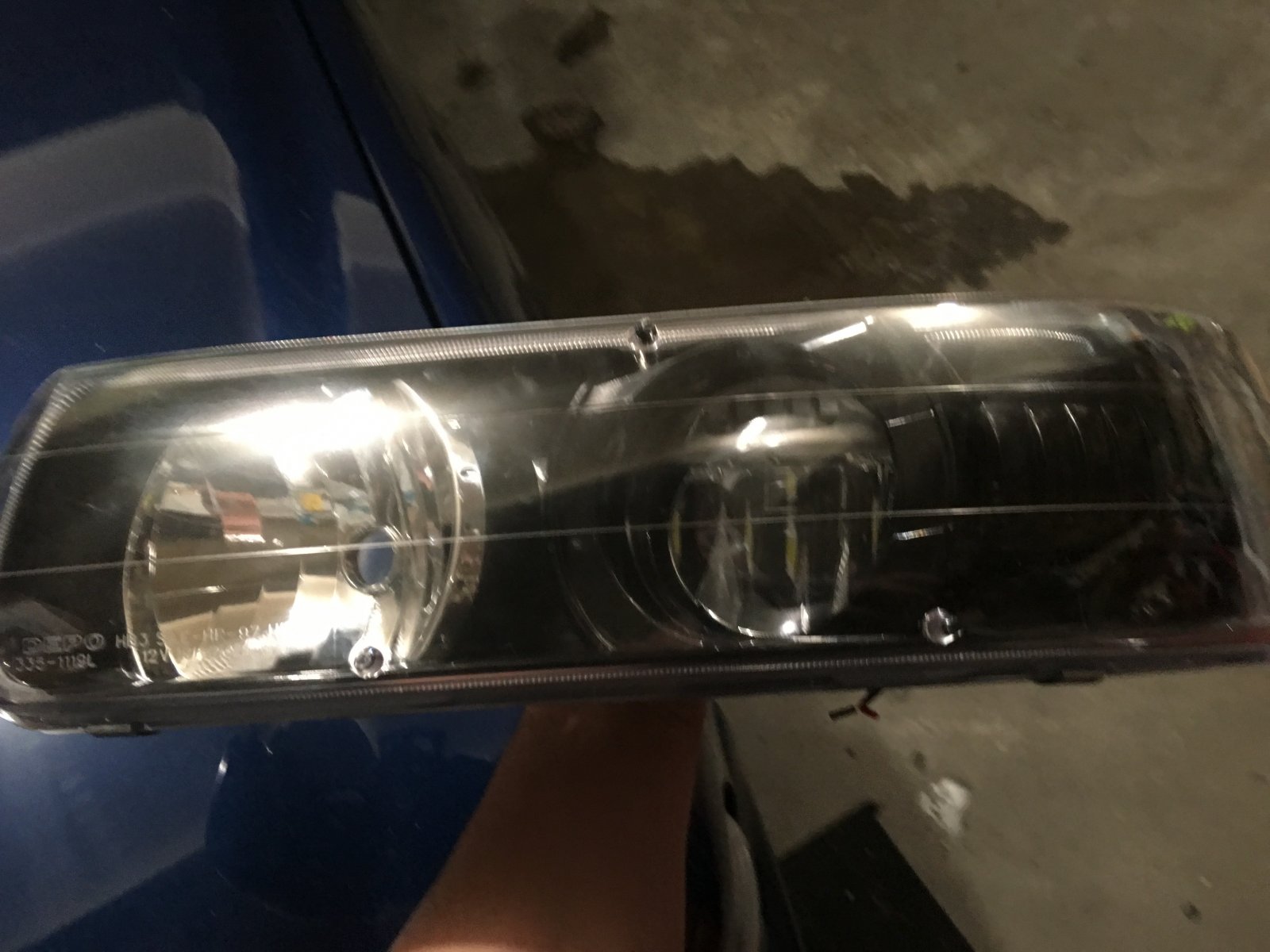

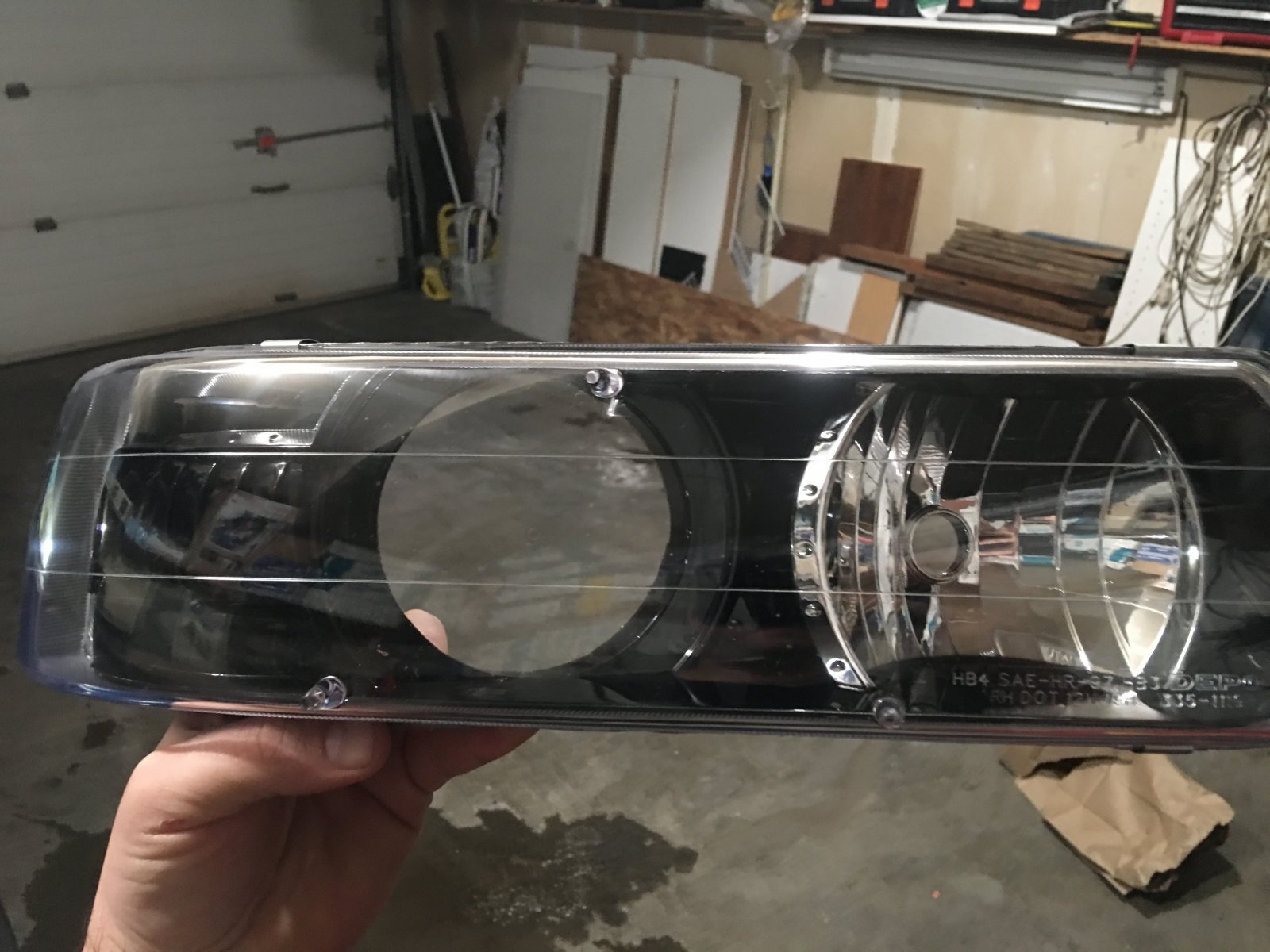

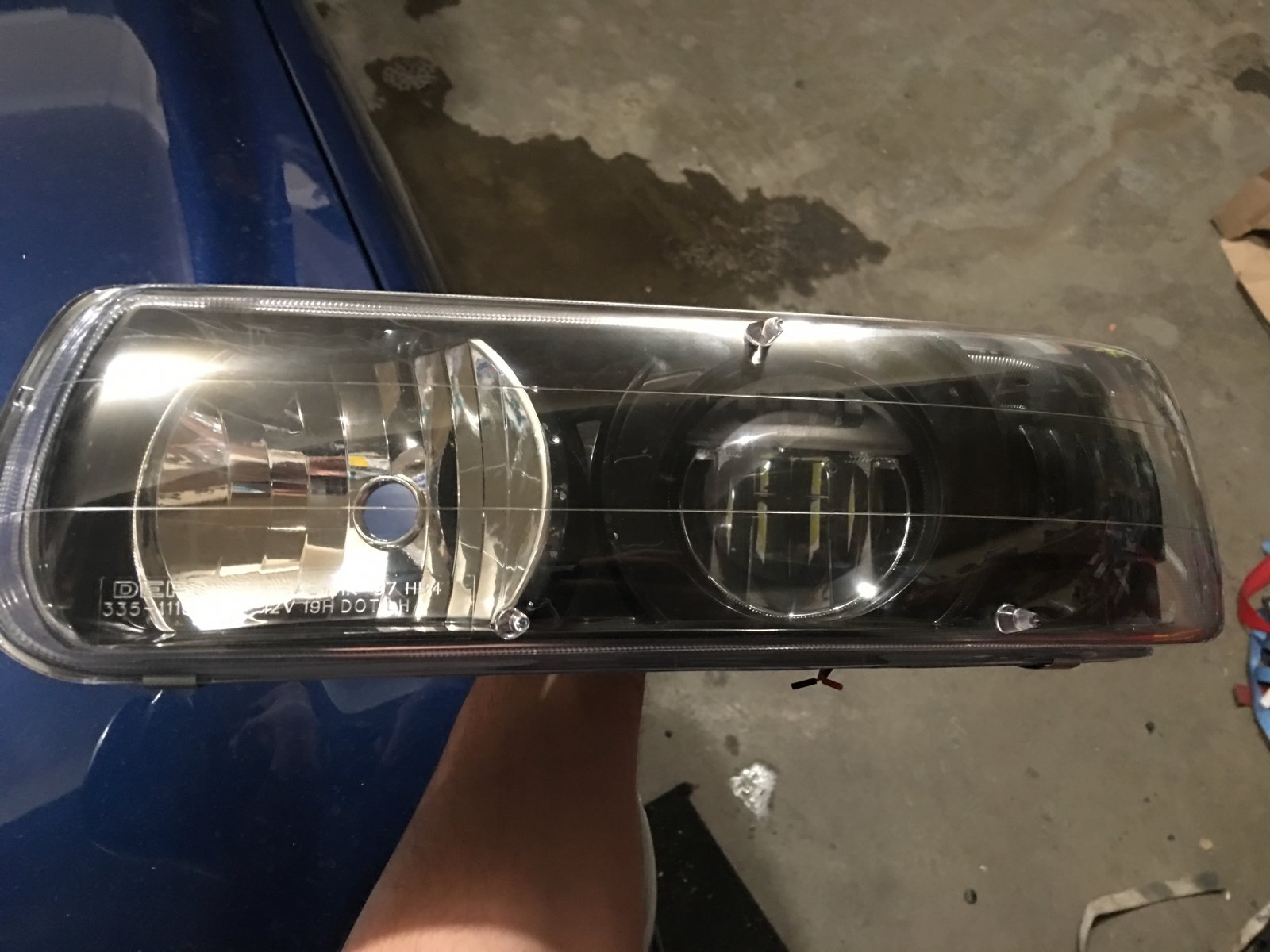

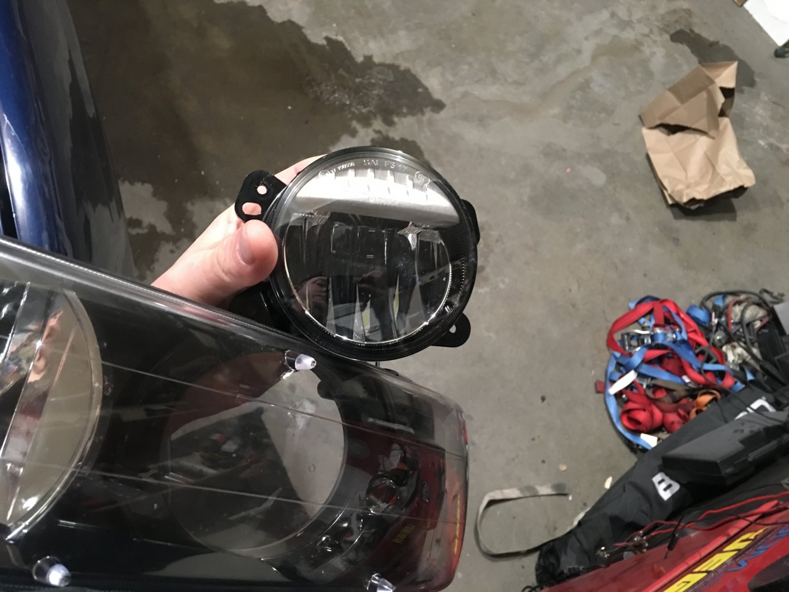

U think a 3" projector can fit in our headlights?...I want to try to retrofit a mled 2.0 into the clear housings. The acme projectors look nuts btw.

It without cutting up the housings for clearance . Then would have to mount using but and bolt method

I'm in love with these headlights...with your experience with these housings...u think it a would be a little less invasive surgery making Mled 2.0 work with these?
Sent from my SM-G981U using Tapatalk
Anything besides a matchbox or mini h1 will be invasive surgery

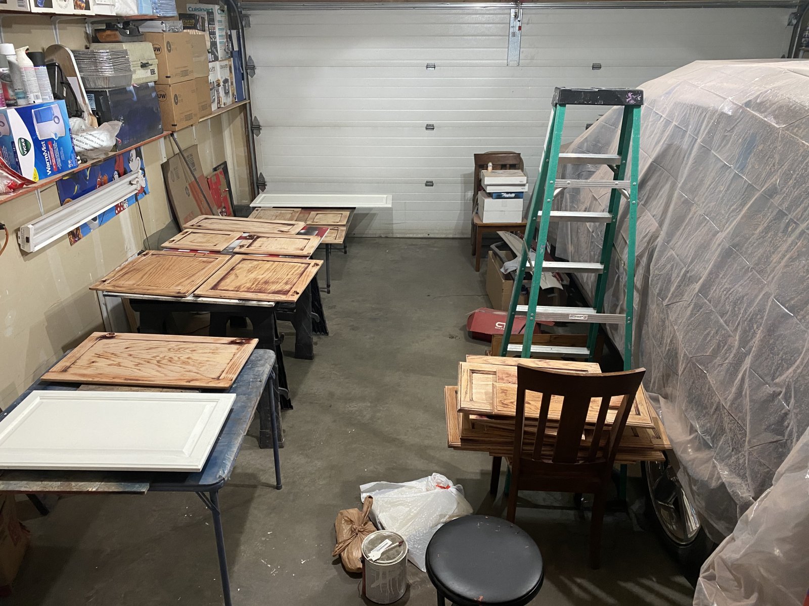

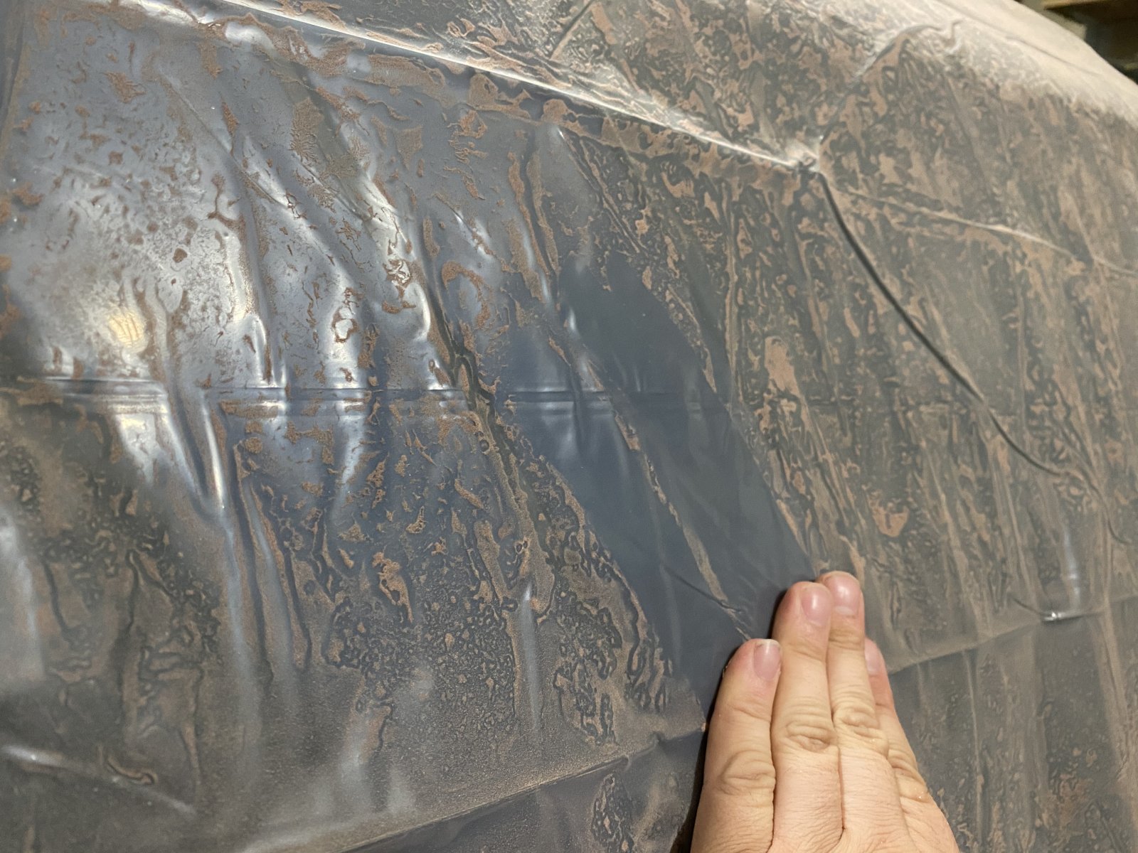

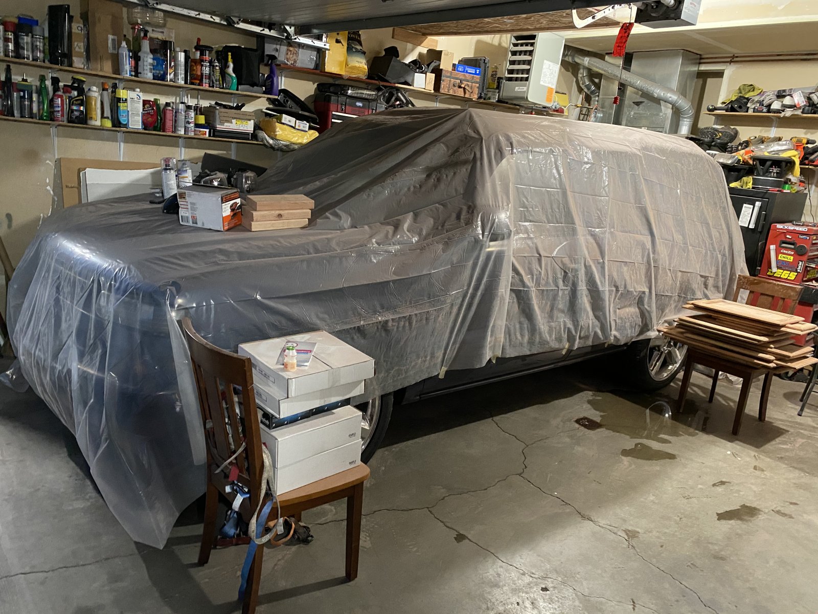

So been busy with an almost full kitchen remodel. Lots of sanding and painting. Tahoe been sleeping under a blanket

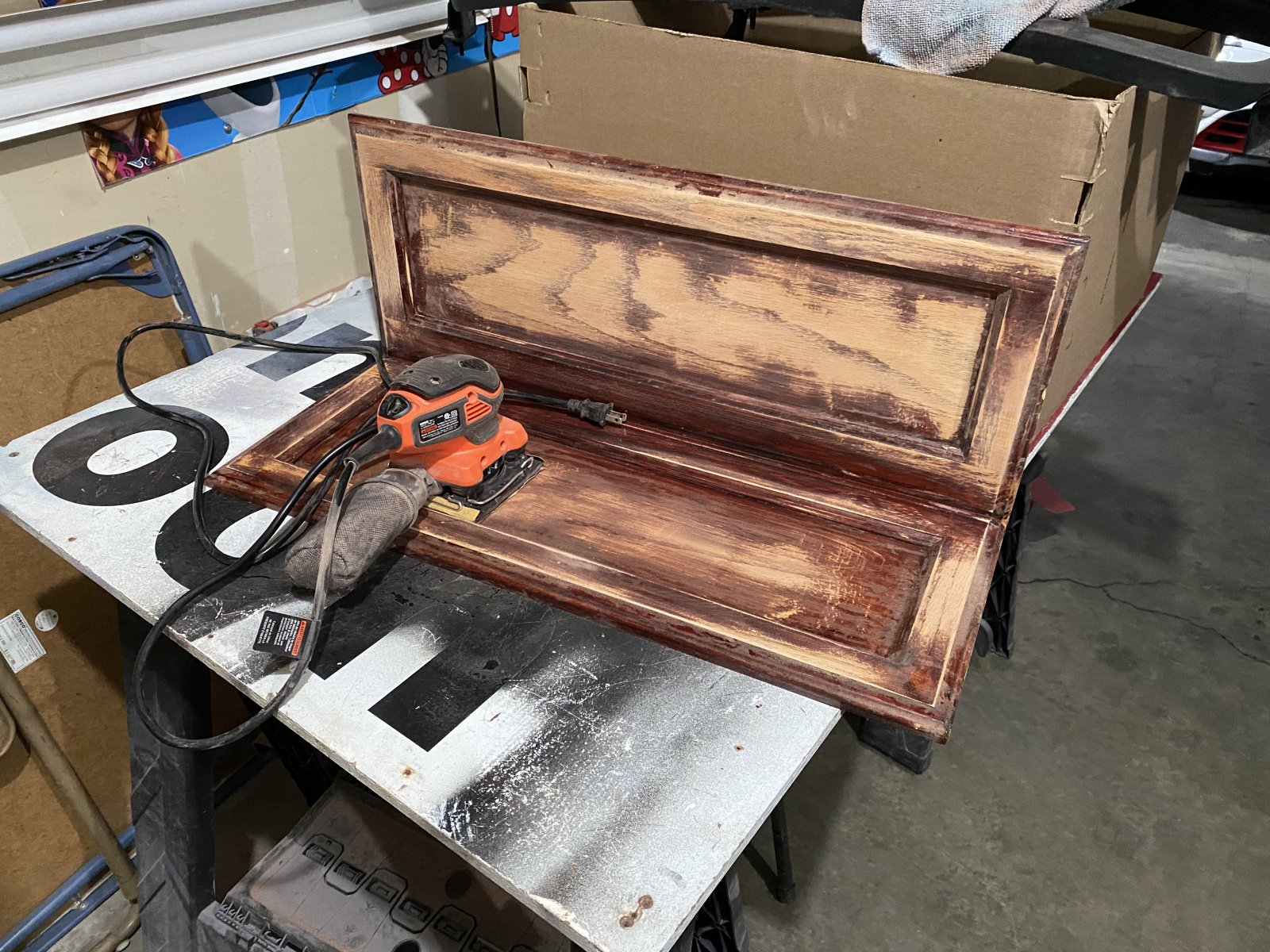

Btw I suck at stain. This is what we were removing from a project 3 years ago. Sanded all the stain off and painted a flat white. Looks way better and brightens it up a ton. Still waiting on handles. Next is granite counter tops and back splash tiles
All new brakes , rotors and pads, sitting in that chair waiting for install.

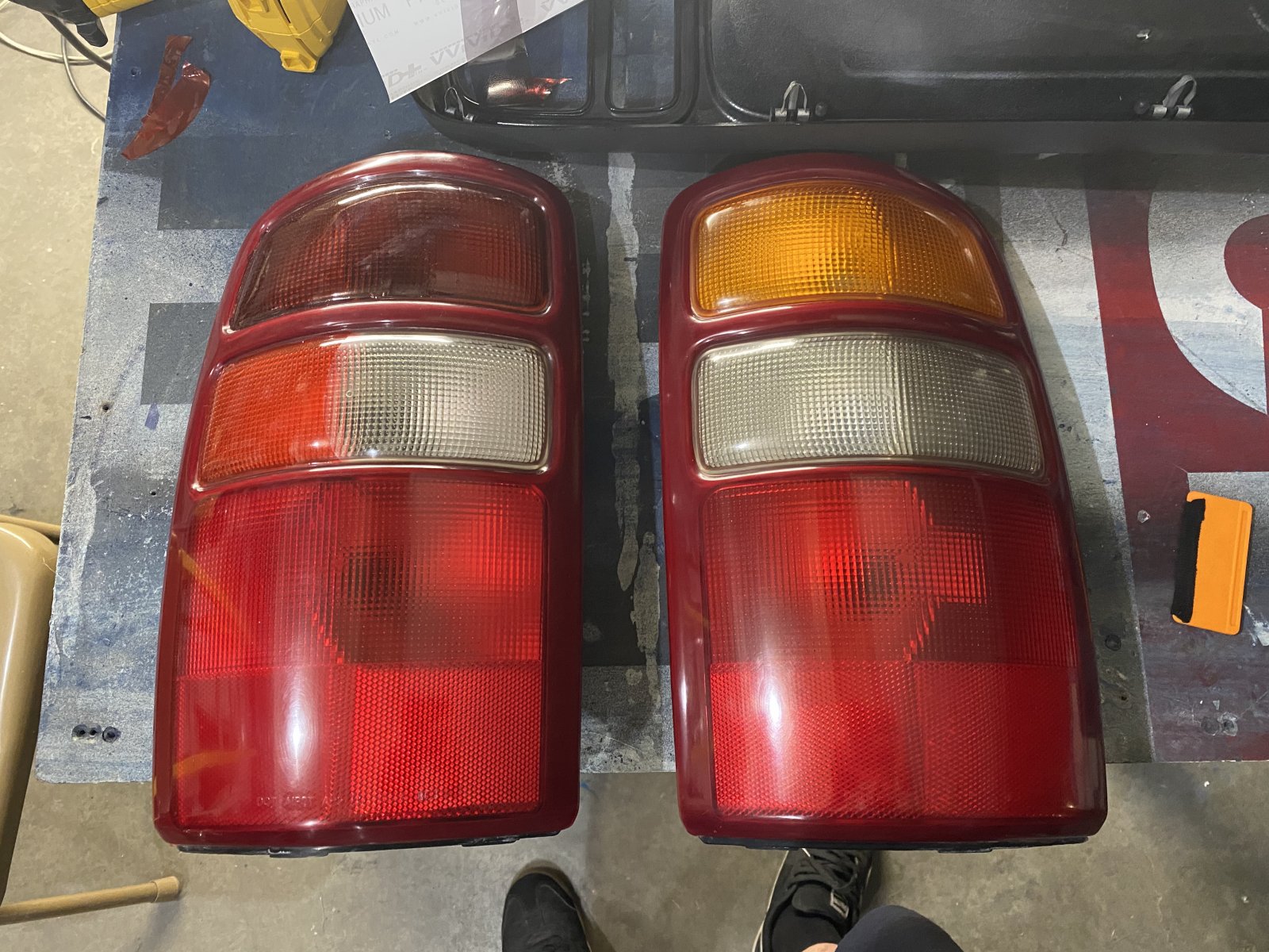

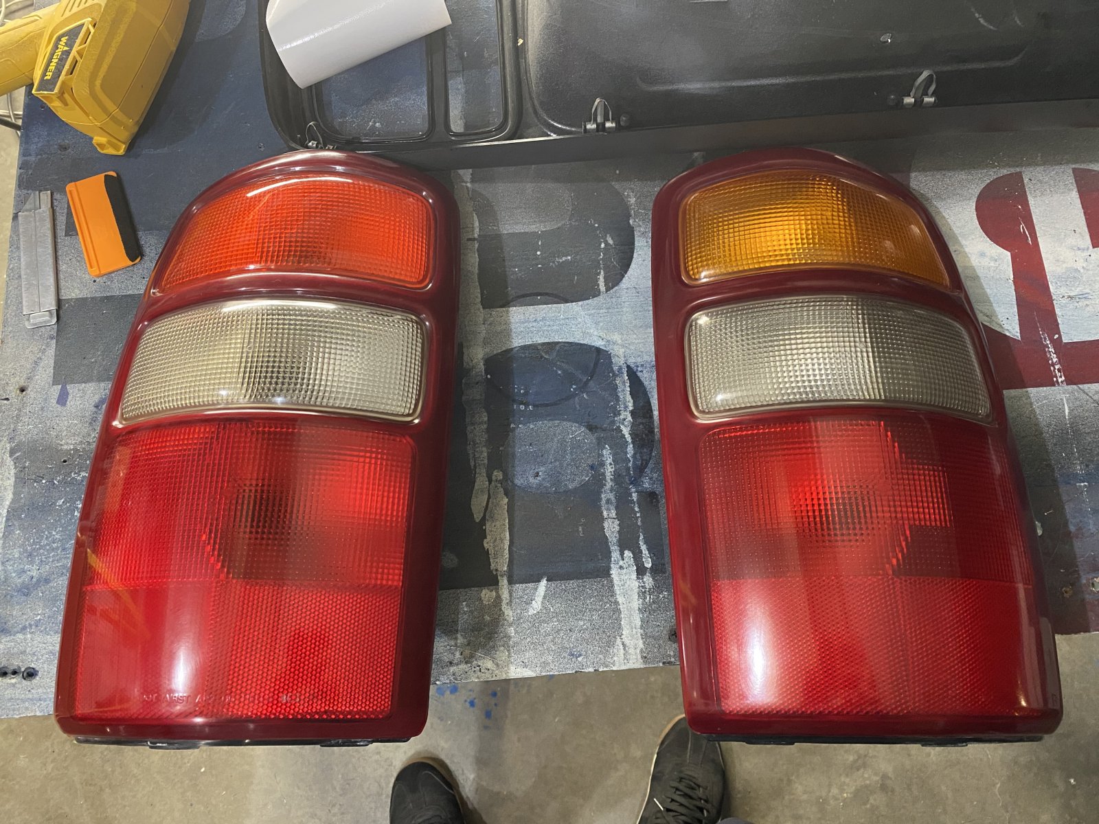

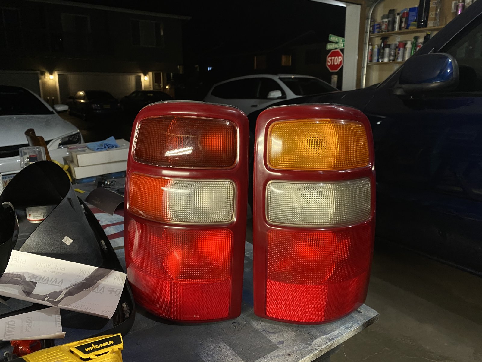

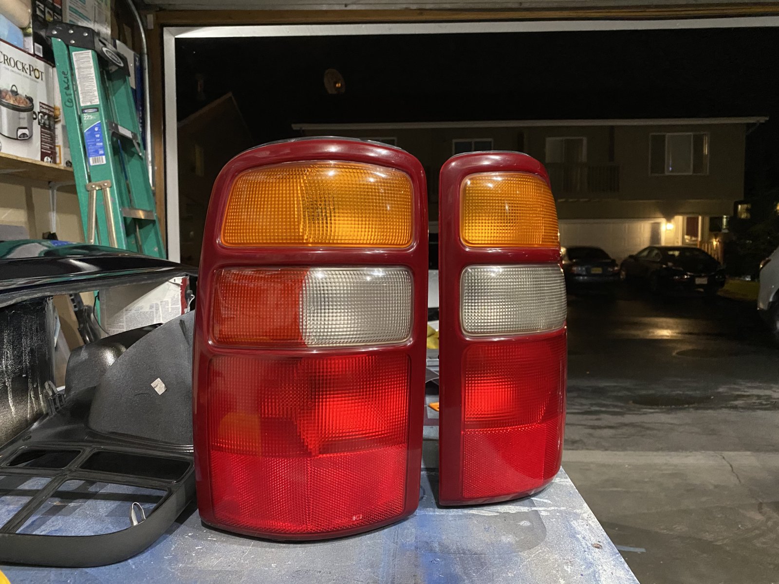

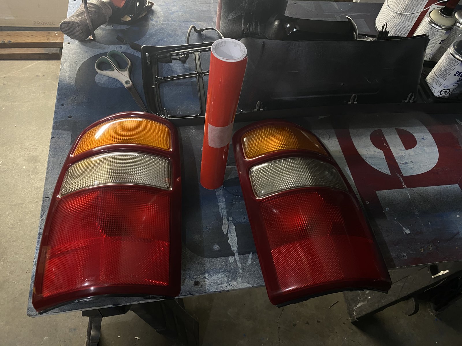

Anyway ordered some red tint to see if there might be a easier way to candy stock tails. Didn’t really turn out the way I’d like. You be the judge. The yellow part just looked like a deep orange. Then I added some tint on the clear reverse part for something different, lighter than the stock red below it.

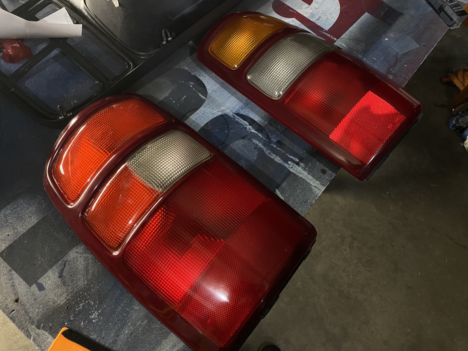

Added a light smoke film to possibly turn it more red. Was just a darker amber , lol....duh. I found some dark red tint but need to order it and try this again. I tried adding another layer of red and it was still orange and didn’t match.

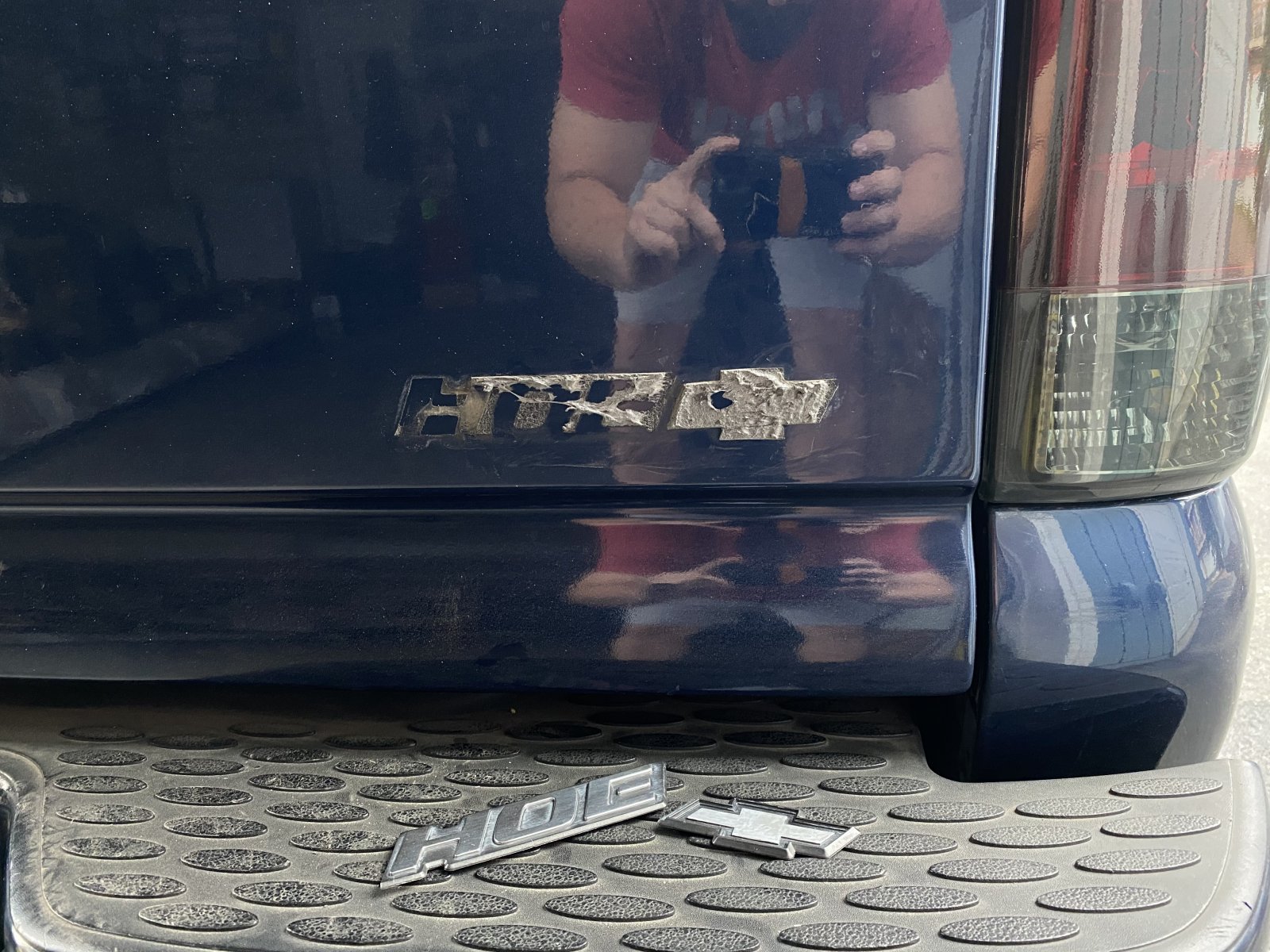

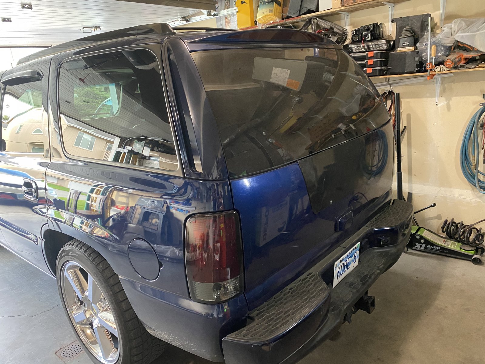

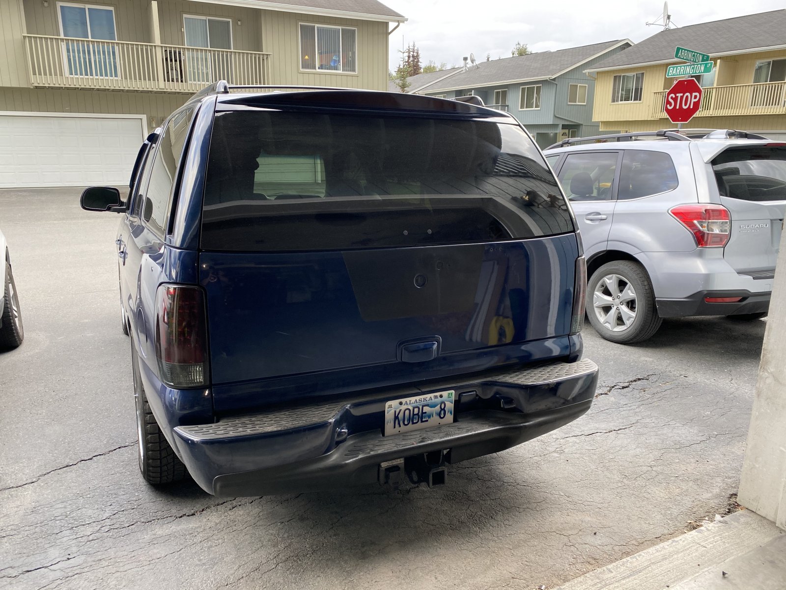

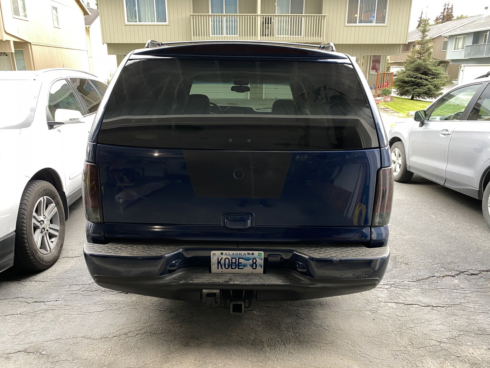

Retired the infamous HOE:boti: badge . Rear looks naked but really clean.

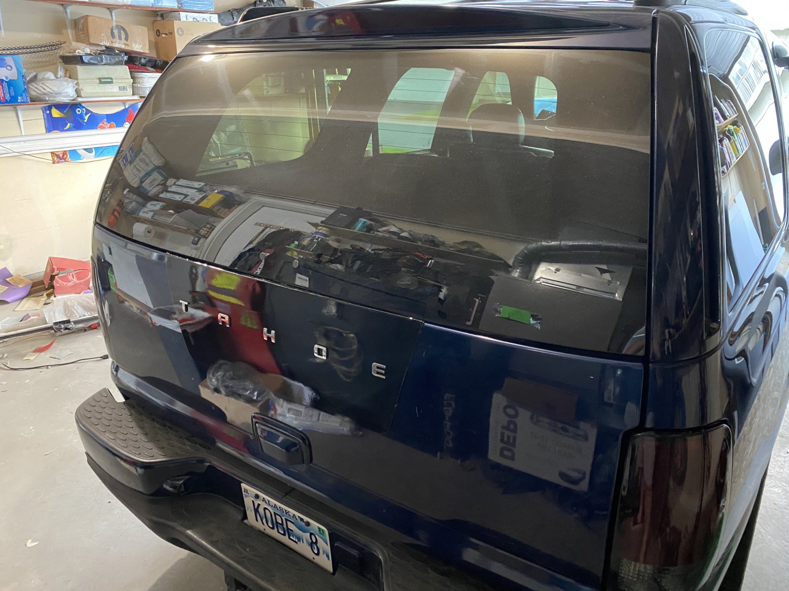

Went ahead and proceeded with an idea I've had in my head for quite sometime now. I call it the poor mans shave lol. Can’t find anyone to weld aluminum up here, then once I decided to go with a steel 00-02 hatch none seem to pop up. Even went to check on a couple “00-02” trucks and they still ended up being aluminum hatches:banghead:. So I said f**k it and went to the local plastics guy with a template I made and had him cut out a piece of abs for me to use a trim design piece on the hatch. Never seen it done before so I just went the images in my head and sent it lol. I had the rear painted with primer than Plastidip on top for a couple years with the same design after I had sanded down all the corrosion bubbles and chips that’s very common on these hatches. Was suppose to be temporary but it’s been like that for almost 4 years now. Actually got compliments on the design and how it flowed with the window and body lines. So I stuck with that design and used the plastic piece wrapped in 3M 1080 gloss black. Used the 3M double sided tape to secure it to the hatch skin. Then added nnbs Tahoe letters and bowtie to the trim piece. Came out alright. It’s kind of a prototype that I do want to improve on and see what other ways I can do this. But at least now i have a real life visual to see how it looks. And best of all no more flat black plastidip spot.
