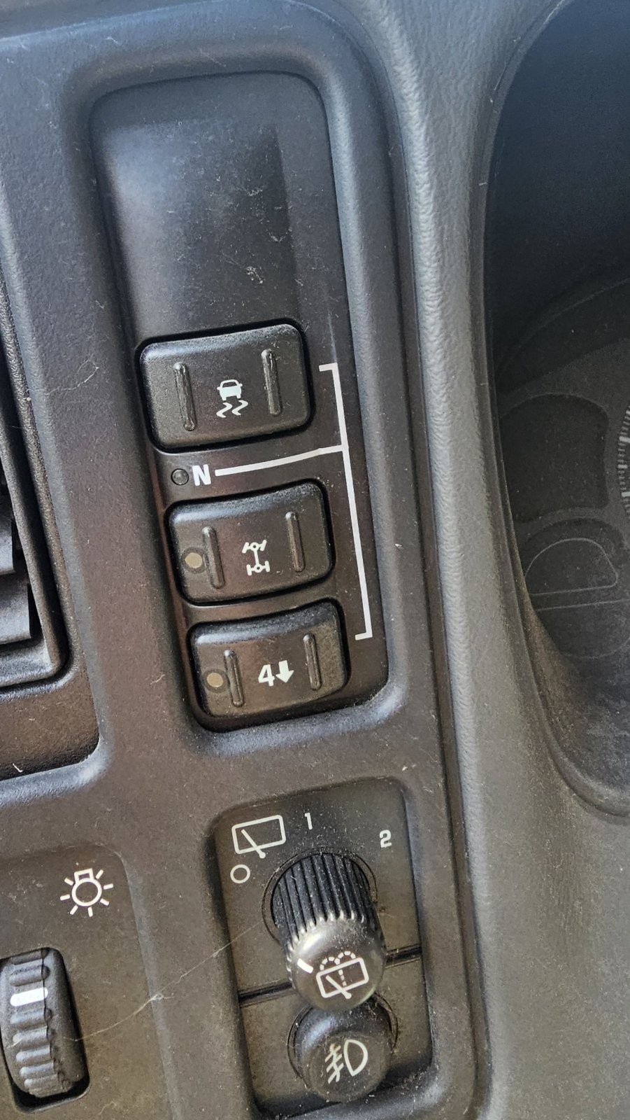

not sure what the name of the scanning software is but here's a pic of my 4wd switch

You need a better scanner that will see the 4wd codes. Once you get the code that's triggering the DIC message, post it here.
In the meantime crawl under it and make sure the transfer case harness is connected properly, as well as not hanging down near the driveshaft.
