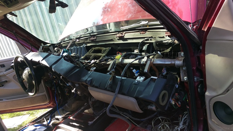

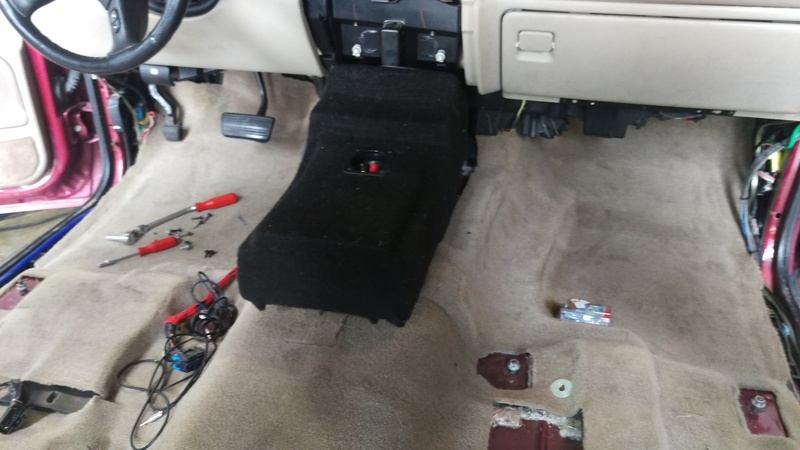

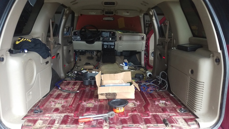

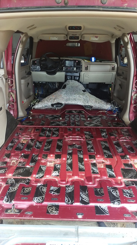

Now that I am on a computer vs my phone with sketchy at best signal in my home town I can update this.
Day started off by stripping out the seats and carpet. Carpet was filthy and needed a good power wash. I didn't take any pictures of the process or right before but there will be a picture at the end
While I waited for help on the heater core I went ahead and power washed the carpet and installed sound deadener in the back half. I didn't go crazy with it. I think I only used 15 square feet? Not like I really had any issues back there anyway. I would have done the front half but motor was giving me issues and wanted to spend more time on what actually keeps the car going vs making it a little more comfy inside. Motor is fine now though thank god. I did not want to pull the motor apart to fix the lifters. YUCK
In order to do the heater core we had to pull the dash out. It was the devil and never wish to do this again! That being said now that it is done, hopefully I will never have to do it again.
freshly cleaned carpet and my jl stealthbox. Carpet looks much better than before and I no longer feel the need to buy new. Still planning on some weathertech floor mats though. I also got a chance to rerun all of my wiring for my system as well and it is MUCH cleaner now. Getting to pull the carpet out helped streamline that a bit. I plan to build an actual amp rack sometime soon that will properly hold all 3 of my amps. Should be much cleaner

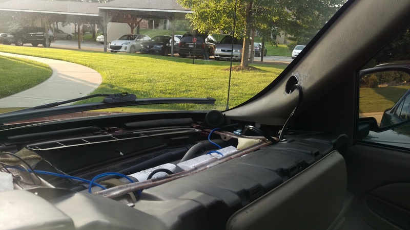

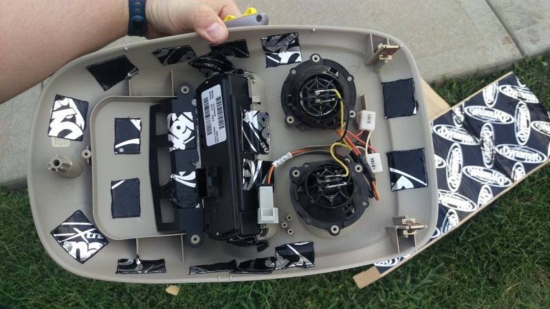

did get some work done last night. This piece was starting do drive me nuts. It's the piece that goes in the headliner that holds the dome lights and ac controls for the rear. Turns out 2 of the 4 clips that holds the ac controls in broke off so that was the culprit. As you can see I put some cld around it to hold it in place. I also stuffed some foam in there as well. It worked like a charm! I didn't need the deadener in there other than to hold the ac controls in place but figured why not. I have 120 square feet of it.
also started with properly aiming my tweeters. This made a world of difference. I knew it would help but wow I did not expect it to change this much. My harsh s sound is finally gone. I assume due to no longer being aimed at my windshield? You can see where I had them installed and where they are currently. Final goal is to fiberglass them as low on the a pillar as I can on axis. After doing this I no longer feel the need to upgrade and I was hardcore looking at some scan tweeters yesterday
also what really spawned me working on my vehicle last night is there there is some rattling witch craft going on inside the dash from when my brother helped with my heater core a few weeks ago so I am going back and redoing what he did. Also have a bit of alt whine at times so wanted to redo the ground on the deck. Do you think 8 gauge directly to the battery would be overkill? Have also looked into doing a small capacitor in the power line as well.
I wont be putting the top part of my dash on until I have the ground/rattles resolved. Wife isn't happy about that but to make her a hair happier I put a layer of ccf on top of dash to cover all of the internals. I think that actually irritated her more than pleasing her

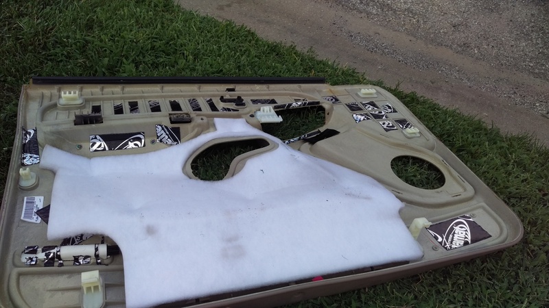

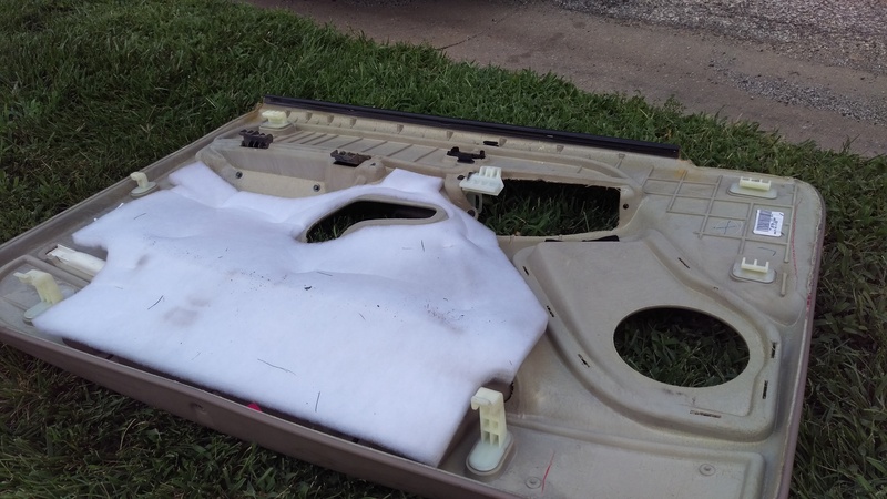

Not anything big going on but progress nonetheless. Pulled the front door panels off to do a little deadening. I still need to actually deaden the doors themselves. I'm holding off on that until I have ccf and mlv to properly finish up my doors. Only ended up using 1.5 square feet. Had originally planned on doing 9 square feet per door panel. Here I am thinking 120 square feet isn't going to be enough and I'm using a fraction of what I anticipated.
also worked on the switches in the doors. They just didn't fit quite right so I did a little deadener in there. I know ccf would have been ideal vs cld but only had cld

I always thought you needed the whole panels covered and wondered why increments of so little were often sold for the deadener. I also ventured down the path of heater core replacement when I replaced my a/c evaporator...I too wish to never do it again
Brian_smith06
Brian_smith06
Feb 21, 2014
79
imo its definitely a piss poor design on gms part for doing the heater core the way they did. That being said im not a designer.
With deadener the real rule of thumb is 25% coverage. Now mass loaded vinyl on the other hand you do want 100% coverage. Its what actually blocks the noise. Some companies market their product by showing panels 100% covered by their cld but its not truly necessary. Im not saying it'll hurt either though. When I pull the headliner I plan to go a bit crazy with the deadener. Im only willing to pull it out once

the picture I have above of my floor deadened is only about 15 square feet. It only goes up to where the back of the center console is. Id say you could get away with doing the whole floor with 25ish square feet. You will want to do a mass loaded vinyl though if you really want to block noise.
This is a great option for cheap but you will need to add a closed cell foam to help decouple it from the metal
