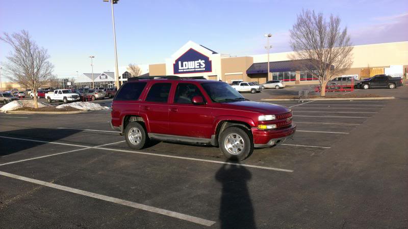

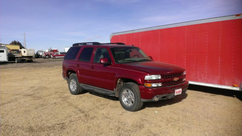

Anywho here my vehicle the day I purchased it. It was a repo so I got imo a pretty good deal on it.
Had the front windows tinted once I had some temp tags on it. The front is 20% to match the rear.

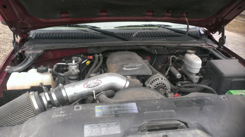

It did come with the aem cai as well. This is the only "performance" mod done to the vehicle though. Hoping to get a few other things done at some point but nothing planned immediately

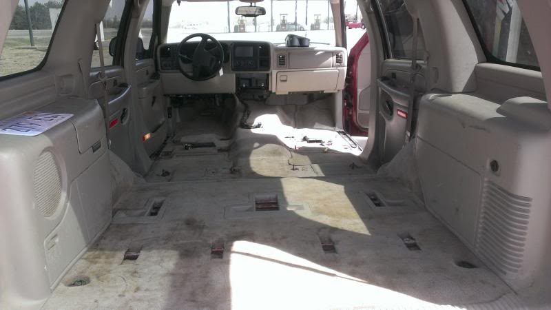

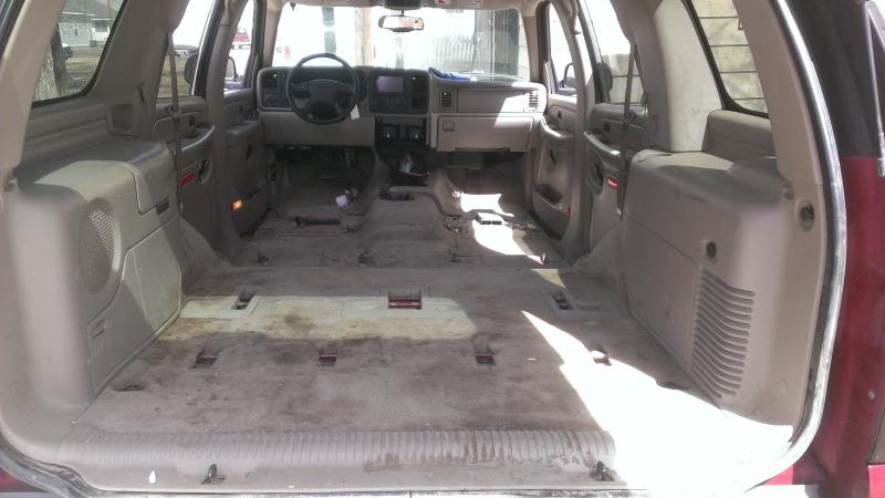

Had to do some cleaning to the interior as well. It was filthy. The previous owner did not take very good care of the vehicle

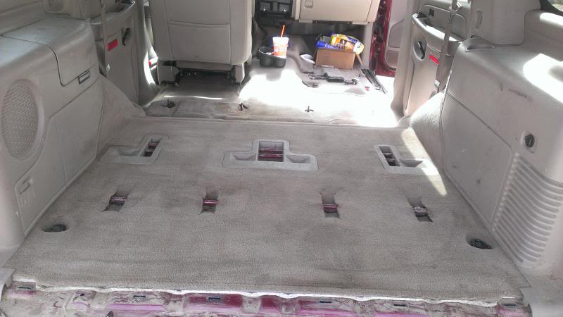

After gutting interior

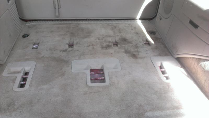

After using vacuum

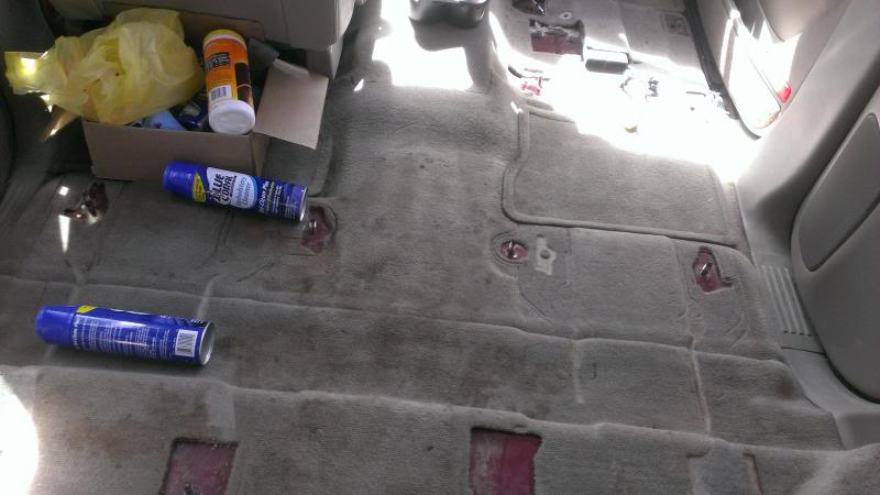

After using a few cans of blue coral. Much better but still not perfect. Plan to get all new carpet in the future

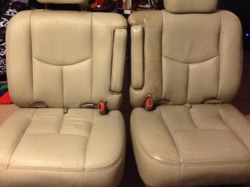

While the interior was out I brought all of the seats into the house and did a nice cleaning to them as well.
terrible picture but you can tell that they changed colors

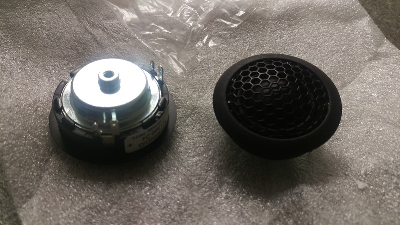

Yeah I think I just might ;) get some more inspiration to keep improving my build. A pillar build last night went wrong in all sorts of ways. However, I did learn that had I soldered the speaker wires to the tweeters I wouldn't have had to build pillars. Too late now though due to using super glue on them :chair:

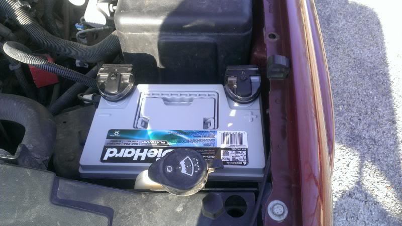

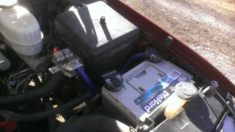

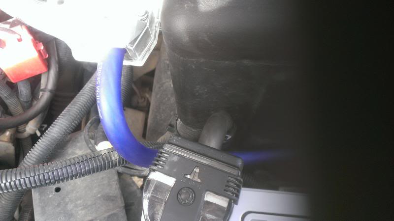

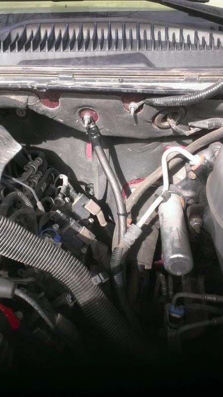

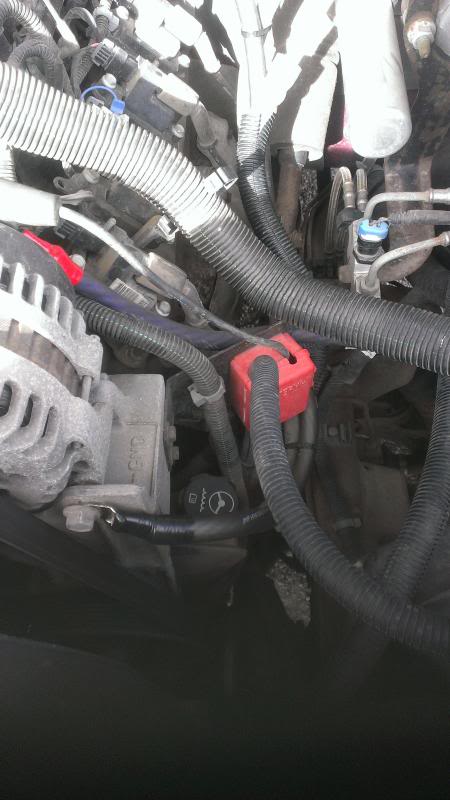

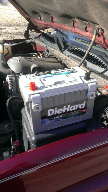

After getting windows tinted I upgraded the battery and some wiring for big 3. And yes upgrading the alt will be coming soon too. Have a buddy that is going to build me a 200 amp soon. Just need to get him a case for it

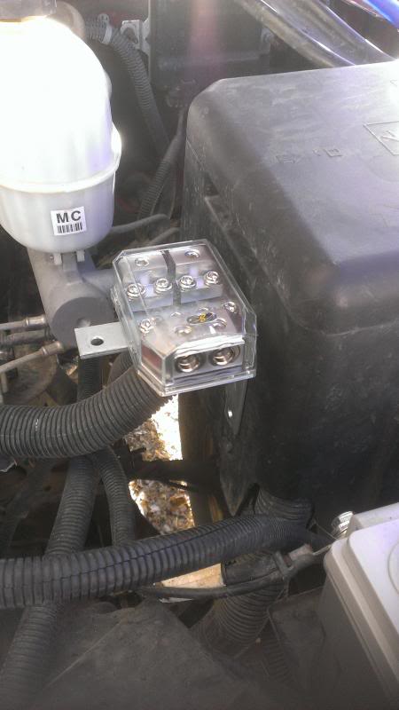

Stinger distro. Accepts a pair of 1/0 in and dual 1/0 out. Using one side for amps in the back and the other for alt

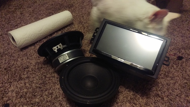

Now for the actual audio.
Currently running

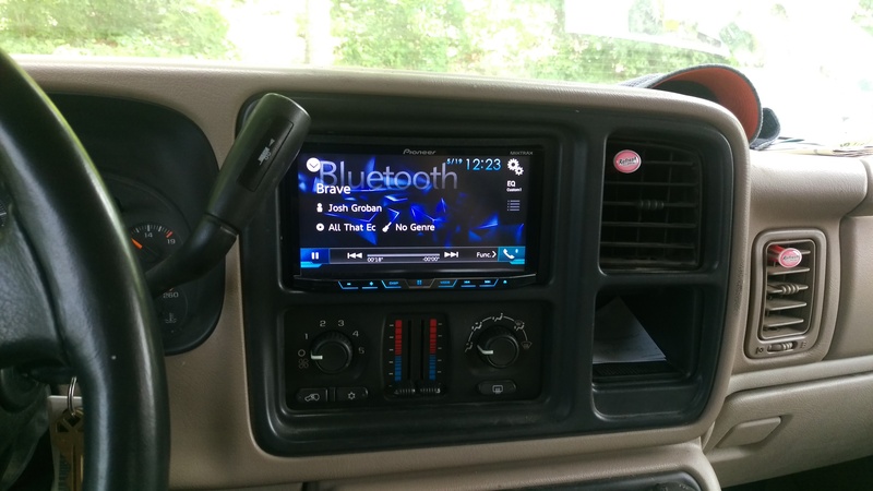

Deck: Pioneer AVH X5700BHS
Tweeters: Seas Prestige(not sure model#?)
Mids: Silver flute 6.5"

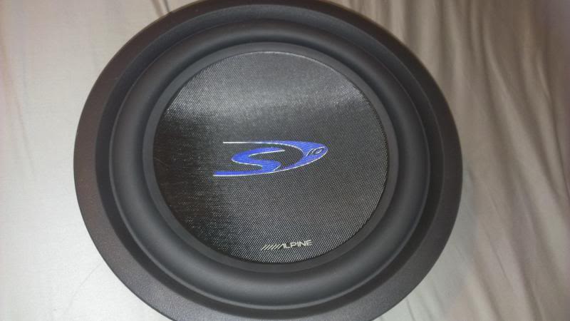

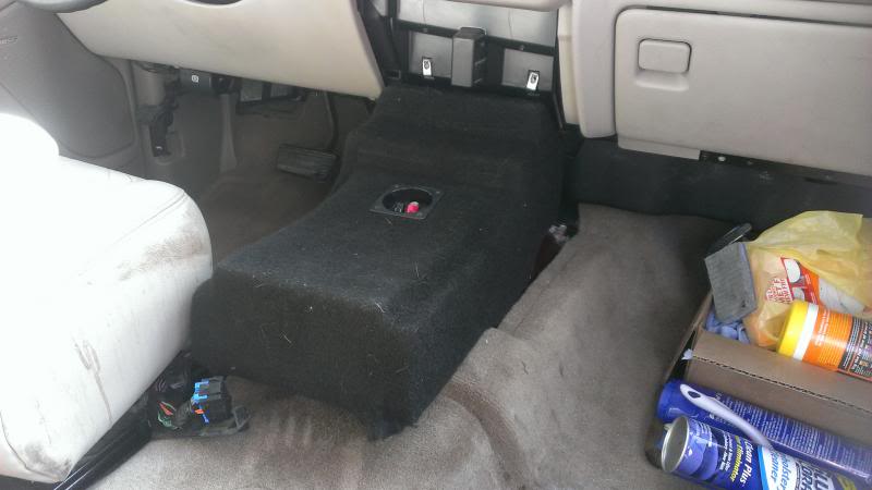

Sub: Alpine 10 type s in JL audio Stealthbox
Amps: 2 Image dynamics q700.2 one on mids the other on tweeters and a q1200.1 on the sub
The goods. And a very curious kitty
this is the 4th deck I have had in the past year for car :/
[/QUOTE]
Pic of it installed and playing one of my wifes favorite songs. I'm surprised at how well Bluetooth sounds on this deck. My old deck sounded like complete dooky
tweeters
Stealthbox
sub in the stealthbox

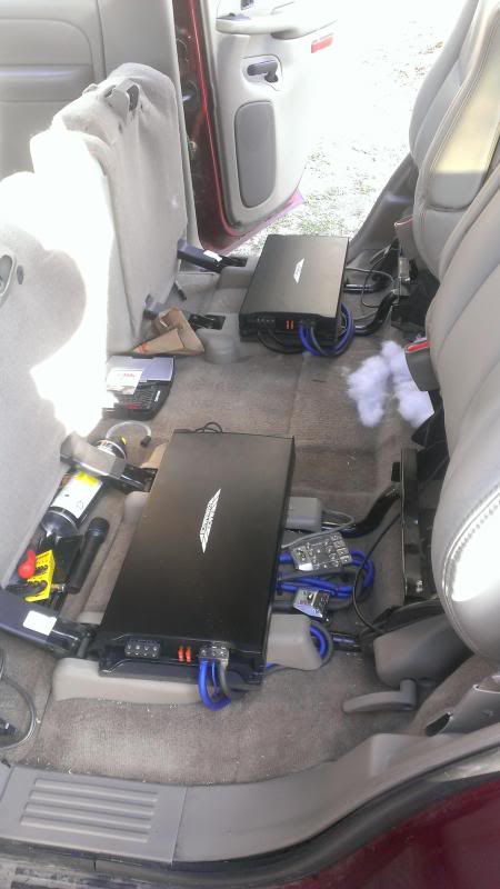

How I had the amps installed. Going to be building an enclosure that goes all the way across to hide them completely. There is a third one in the mix now.

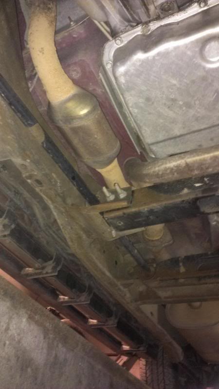

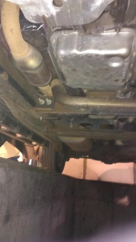

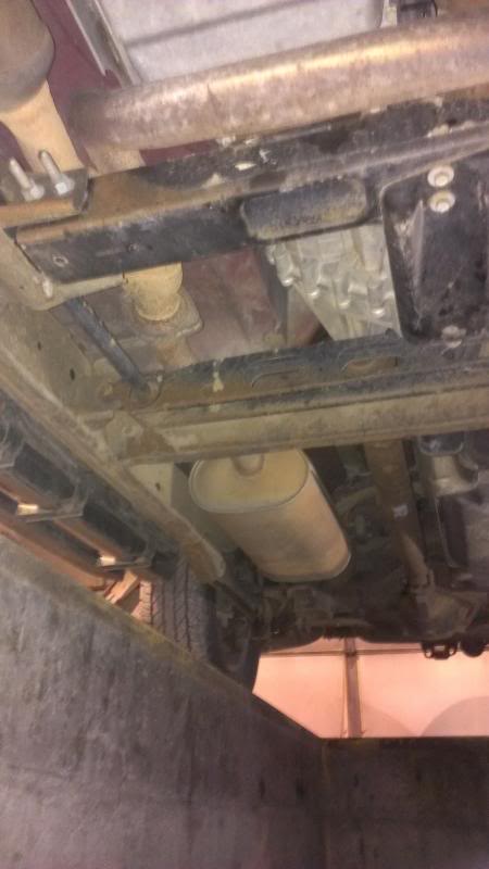

and applied the second skin thermal block
before
after which is super hard to see but I applied it from about a foot from the headers all the way to the rear of the exhaust. Im not sure how much sound it'll block but im sure it'll absorb some heat. I didn't notice heat getting through before however itll never be a problem

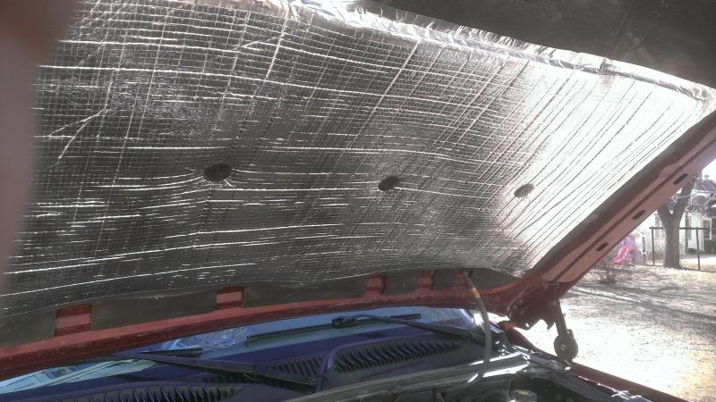

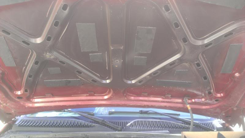

Deadened the hood. No it didn't need it but I had material so why not
Also did a hood liner to absorb heat/sound

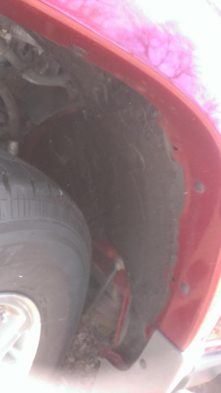

I put 3/4 of a gallon of spectrum sludge in wheel wells. Once it cures I will apply a layer of luxury liner pro

I'm learning as I go. I don't know shit about audio either, unlike you. What's that hood stuff you put on. It looks clean. Where can I get it?

Here is the stuff I used on the hood. If you get some use some good glue and the do the edges with that silver foil tape or it'll absorb moisture and be bad news bears
http://store.secondskinaudio.com/heat-wave-pro-1-sheet-24-sq-feet/
This is what I used underneath above the exhaust. Can't say how well it worked due to not having an issue prior but I assume it's doing what it's supposed to do. It's also on the expensive side so can't say that I recommend it. I will admit the only reason I had it was from my old audio install. I don't want to say I was sponsored by them but they basically gave me a lot of product to do an in depth write up for them and give a subjective average Joe review.
http://store.secondskinaudio.com/1-sheet-of-thermal-block/
