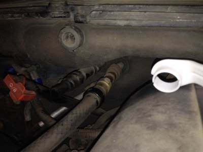

I'm replacing the heater core. Have the dash disconnected, now working on engine bay side. A/C is discharged and ?canister? is out of the way. Coolant drained. Next step is disconnecting the through firewall heater hoses. Not sure how to disconnect them. I can press in on the tab and slide the fitting back about an 1/8". But I'm afraid to just yank on EM. What is the trick?
Are these the right tools?
I have about 6 different sizes of them. None seem like they work. Thanks for any input. -Brady

Well update is I didn't need any tool. There's just a tab on top & bottom you squeeze & pull. Finally finished up this job. Gotta tell you, it's a PITA on the GMT800s. But, the knowledge, experience, & financial benefit of doing it myself was worth it I guess.
