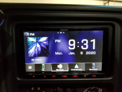

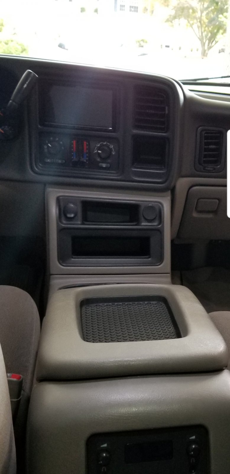

See answers in bold. Here are a couple pictures of my radio install. I also added two wireless charging pads to the bottom of the lower pocket in my console. This allows me to do everything wirelessly. I took apart a couple of fast charge pads and hot glued the internals to the bottom of the pocket. It is wired to the cigarette lighter circuit through a quick charge USB outlet. A couple people have asked me to take pictures of it. I need to do that... The USB inputs from the radio run to a double USB outlet which replaces the right side 12V outlet. I rarely use anything that requires a 12V outlet, but I did not want to get rid of both of them.

Hey man. Awesome info, and sick setup! I have been looking at head unit options for a while, and I am leaning towards the Kenwood DMX907S, which I see is essentially the same unit you've got, just one year newer I believe. I really dig the look of yours and the functionality you described, with the wireless charging and sleeper install of the USB inputs. Would you mind taking some photos of the construction of your wireless charging setup, with the fast charge pad internals hot glued to the bottom of your front console pocket? Also, what did you mean by "it is wired to the cigarette lighter circuit through a quick charge USB outlet?" All of the fast charge pads I have seen have a micro USB attachment. Did you mean you somehow hardwired the charge pad internals to the cigarette lighting harness in order to bypass the micro USB attachment such that the coils are always be ready to charge? Seems like that would be the way to do it, since it would suck if one of the micro USB cables ever disconnected from vibrations lol. I would love do to this same thing! I have an '01, so my pocket geometry is a little different (replaced the tape deck with a junkyard pocket, but the pocket has a lip) and I'll have to investigate whether the phone would be able to sit flat, but I'm betting I can make it work somehow.

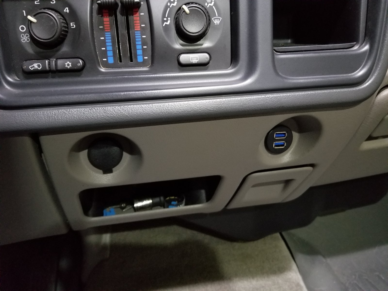

Also, what did you mean by this? I know that the USB inputs for the head unit terminate in 2 separate female USB ports. Those ports are pretty bulky from what I've seen in the past. How did you cram two of those into one 12V outlet? I would also love to copy this idea lol. Since I have an '01 I've got the flip up cover over the open 12V ports instead of the two ports beside the pocket. I also rarely use anything that needs 12V, so I suppose I could just use two of the open ports (I think there are 3 total), but I'm still curious how you did yours. Did you buy some sort of 12V outlet plug and cut it to fit the USBs? Or maybe there is a factory piece for a newer vehicle you used? All ears!

I used the cigarette lighter wiring for the outlet I removed to power the USB outlet. The pads still use the standard usb cables to power them. No issues in 3 months. If I have it apart any time soon I will take pictures but all I did was take the charging pads apart and hot glue the guts to the bottom of the pocket. Make sure to measure it all before you glue the pads on so that your phone sits centered over the pad. This is similar to the USB outlet I used.
https://www.amazon.com/Charger-Wate...6&sr=1-1-f7123c3d-6c2e-4dbe-9d7a-6185fb77bc58
Remove the 12V outlet and install this
https://www.amazon.com/ICESPRING-Fe...d=1600021832&sprefix=dual+usb+,aps,167&sr=8-3
This was before I put the center console in, but you get the idea.

Thanks for the response, man! Just to be sure I understand, is the first USB outlet you linked glued/hidden from view with the rest of the wireless charger guts? So you just connected the unused 12V power and ground wires to the USB outlet, plugged the 2 sets of charger guts into the USB outlet, glued the guts to the bottom of the pocket, and secured all of it out of sight?
Ah, yep that makes sense now. Thanks man. I will definitely be using this same approach and part.

Did you change consoles? Looks like it based on your previous photos compared to this new photo. I like your style of front console (one posted in your original photos) since the pocket looks wider and completely flat whereas mine is narrower and has a lip. I tried placing my phone in it earlier today to see how it might work, and it doesn't sit completely flat due to the lip. I'm not sure how I would make it work without cutting/filing the lip off. I don't really want to do that. I suppose I could swap consoles (after I just got this one too after having none since I picked up the truck last year...). I believe I read though that changing to your style of console requires changing more than just the center and front consoles, since I believe your style of front console wraps into the passenger foot well somehow. Also, I'm not sure, but I think if I were to bite the bullet and change to your style of front console, I would also have to change center consoles as well. Hmm, maybe it isn't worth it. I do really like the idea though. I have had 2 phones now fail only because the charger port stopped consistently charging after several years of plugging and unplugging a charger day after day.
1. Yes that is correct. It is all hidden underneath the console you see in the picture I posted earlier in the thread.
3. I changed from the center fold up seat to the console. My Tahoe is an 05 so it bolts right in. I am not sure if the 03+ console will fit in 00-02 trucks because the dash is different. I had to change the console and glovebox panel. The console is all one piece, not separate like you are talking about with the front and center consoles.
