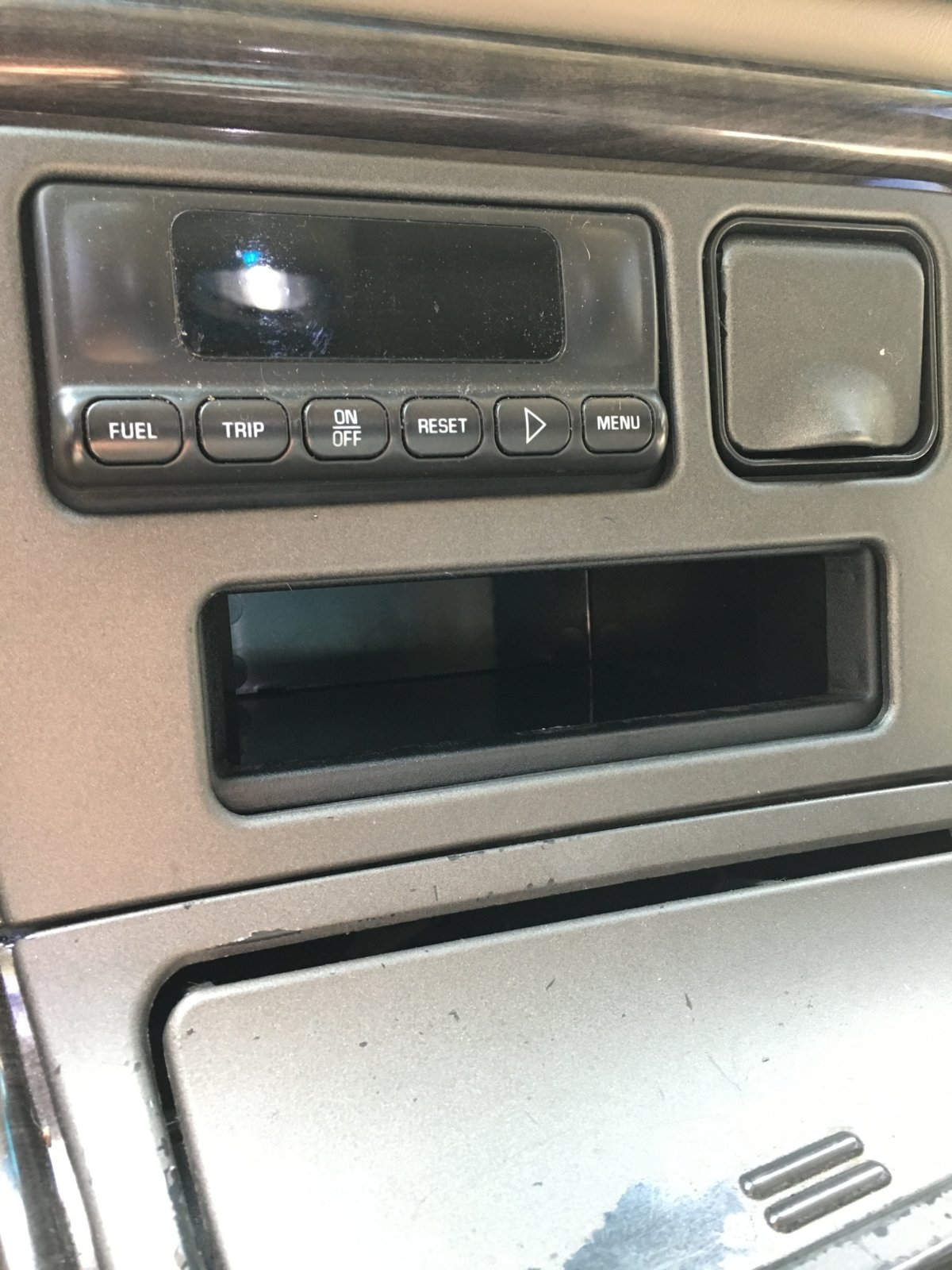

I have this console in my 03 Denali, tonight I removed the cd changer (the 6 disk) and left the hole open... I was wondering if there was some made without the cd changer, and is there just a cubby hole box to fit in the hole?
Has anyone installed something better than simply leaving it open?

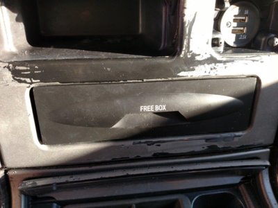

I bought this, slow boat from China, but it os the right size... I may do as 1992rs suggested and munt it using the hollowed out old cd player... I will take pics when I install it.

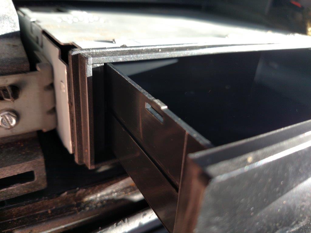

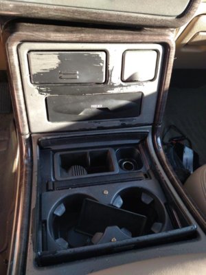

OK, the drawer I ordered finally arrived, so I did as 1992rs suggested, gutted the old cd changer box, and this drawer fit like it was made for it... popped it all back together and am real happy with the result.IMG_20180303_161437864.jpg IMG_20180303_161918969.jpg IMG_20180303_161928996.jpg IMG_20180303_161949837.jpg IMG_20180303_161945696.jpg IMG_20180303_161437864.jpg IMG_20180303_161918969.jpg IMG_20180303_161928996.jpg IMG_20180303_161949837.jpg IMG_20180303_161945696.jpg

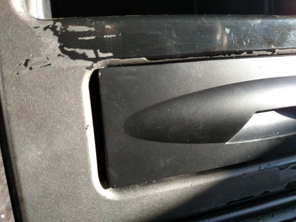

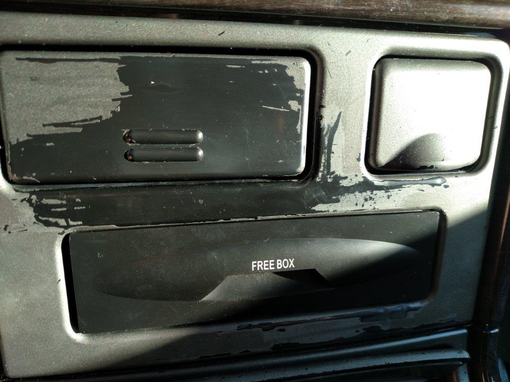

It looks so crappy because I started scratching off the grey paint to just leave the shiney black, but damn it is a LOT of effort to scrape off... not sure how to do it 'easy'.
26,678
52,944
I used denatured alcohol and scotchbrite pads. Easy.
