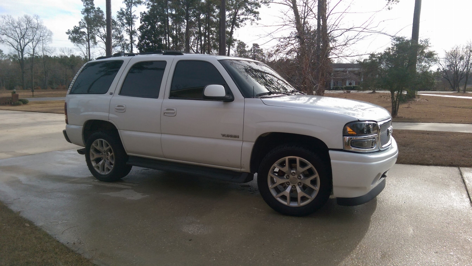

This is a shot with stock spindles back on. Measurements 34-1/2 front and 35 rear
Belltech spindles dropped mine to 33 1/2 and your at 34 1/2 with stock spindles? I was at 35 1/2 before I lowered the front of mine with stock spindles. What size tires are those?

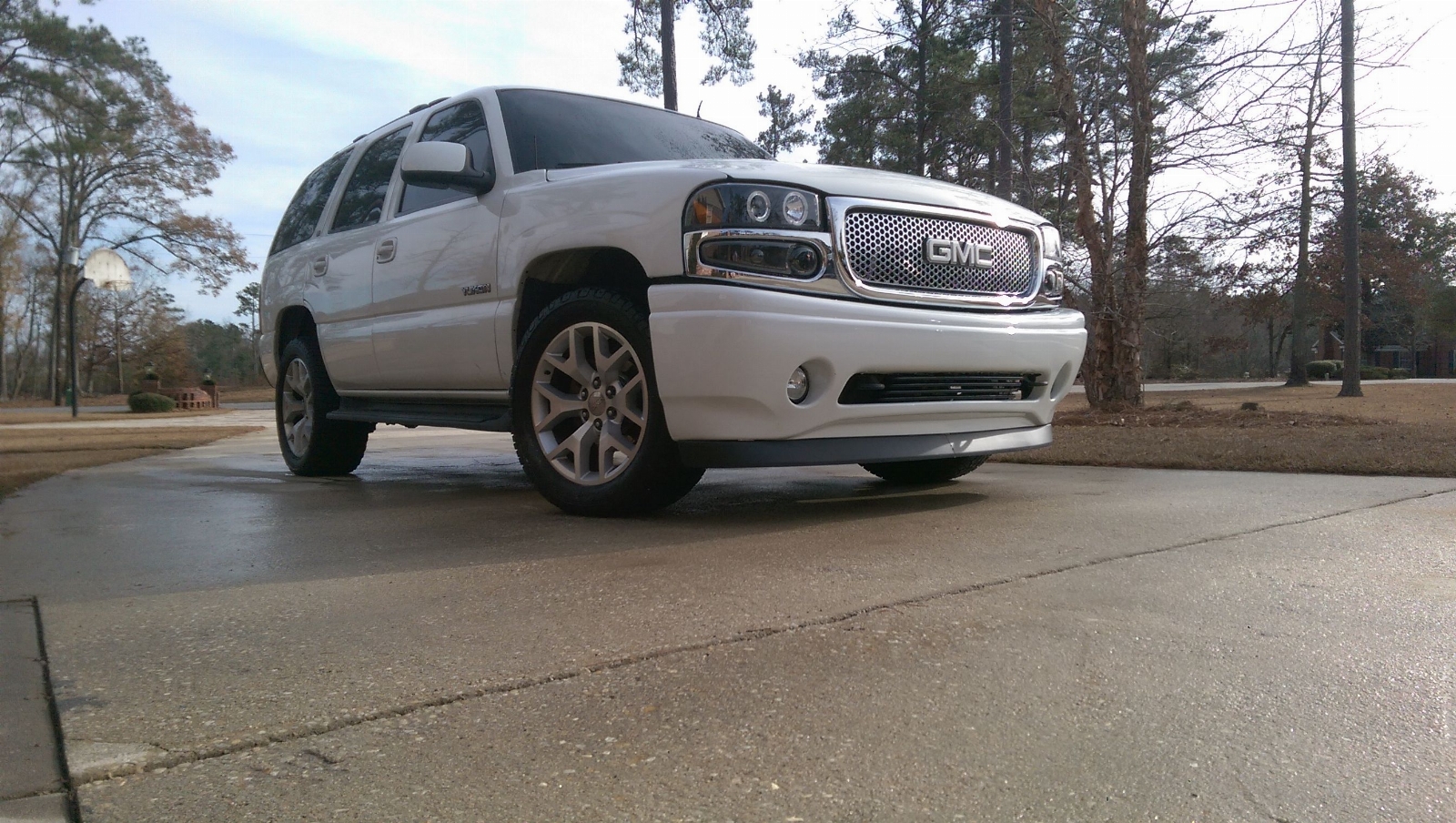

Here are a few pics of the new stance since I went with non z-71 moog rear shocks. I also finally got some time over Christmas break to install the lower valence for the bumper and headlights that have been sitting in the garage for a year.

So are you back at stock height now?
Not exactly. Rear is slightly lower than stock and front is a bit higher since I turned up the torsion bolts. There's a slight rake.

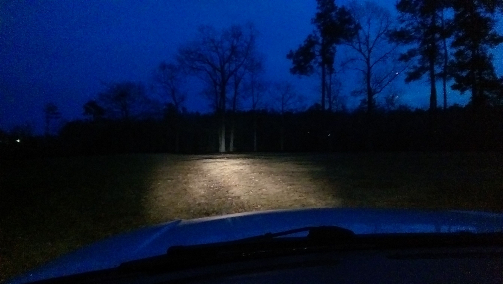

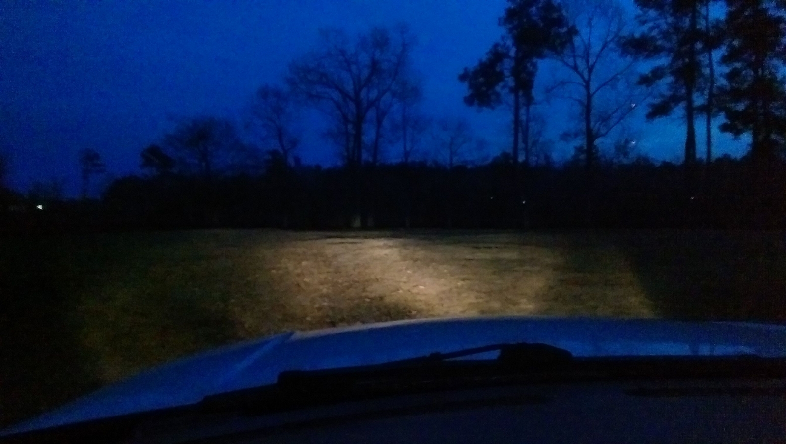

First shot is low beams through the tinted windshield with the treeline approximately 50 yards away and the second is of high beams.

Yeah definitely need some hids or leds

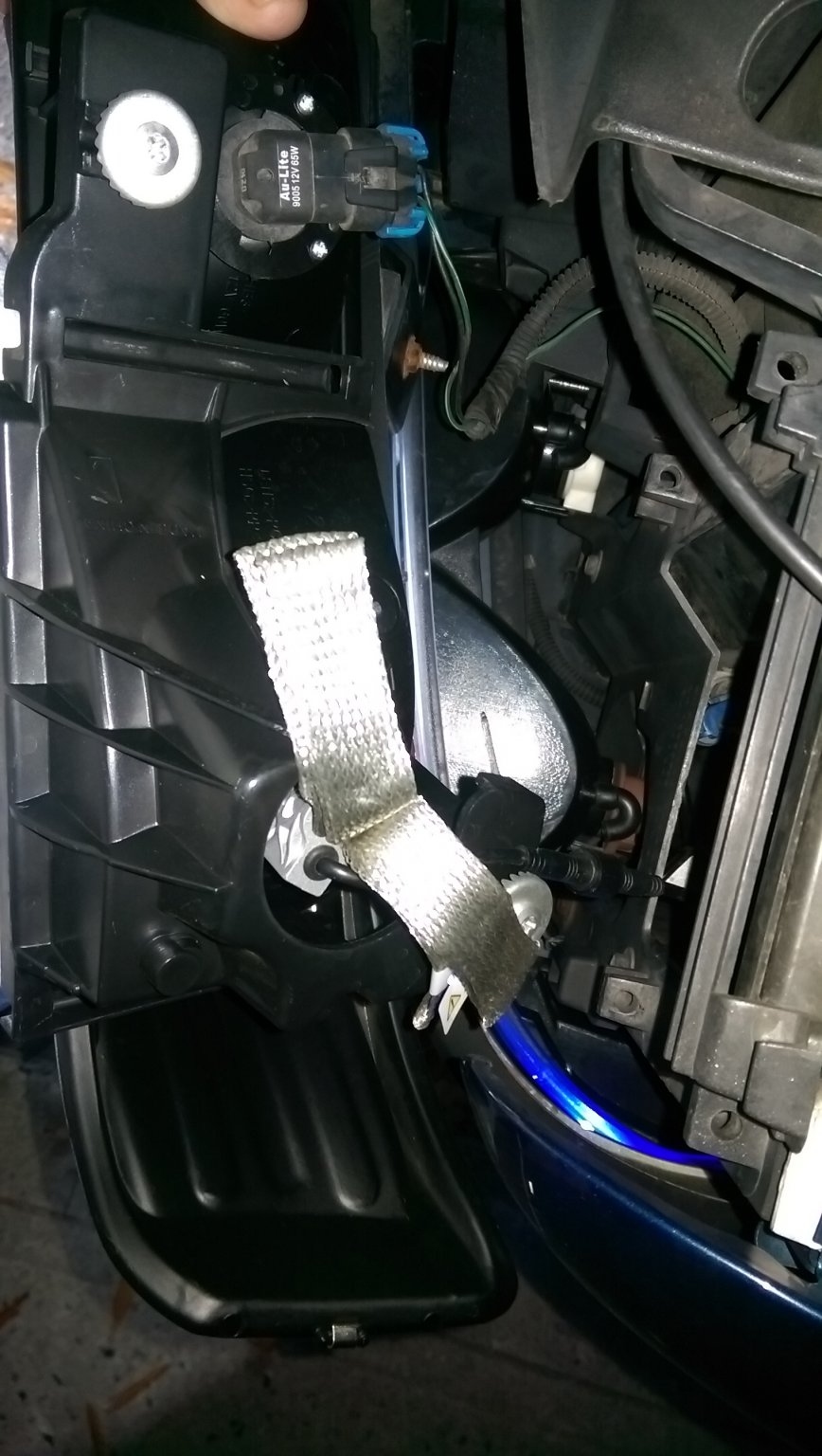

Really easy, basically plug and play. I don't remember which side, but I did have to remove the black housing that's screwed behind the headlight housing on one of the headlights. The led was a little too long to wiggle it in. Not a big deal at all. Once in, I just spread the cooling fins behind the bulb and called it a day. Money well spent. I can actually see at night now.
