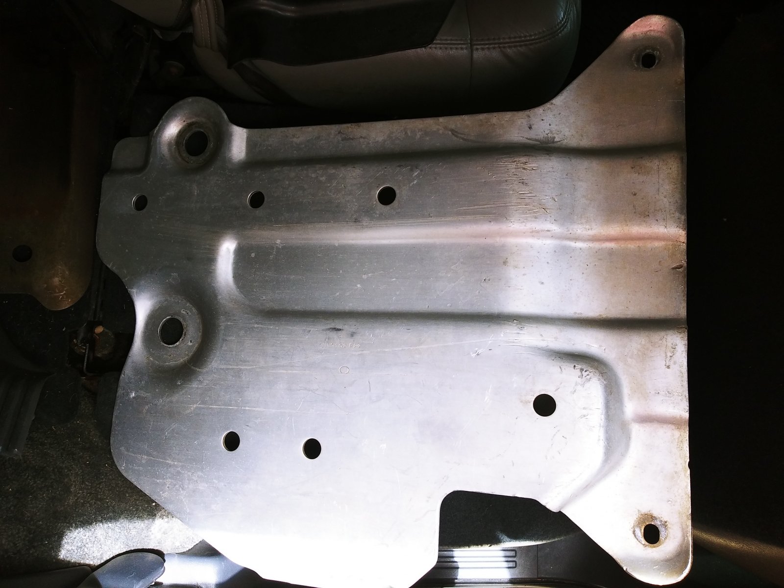

A couple of years ago, I was working on my Tahoe and had removed my skid plates. Can't remember why, but I found that these rubber bushings for the plate were really deteriorated, so being the confident genius I am, I threw them away and said to myself "self, you can buy these later".
Jump forward to last week, I decide it's time to put the plates back on and now I have no idea where to get these rubber bushings.
Anybody got a lead on these or am I shopping for a new skid plate?

It covers the oil pan I believe. The bolts that go in those two larger holes on the left had large rubber bushings they set in to. Those are the ones I need.

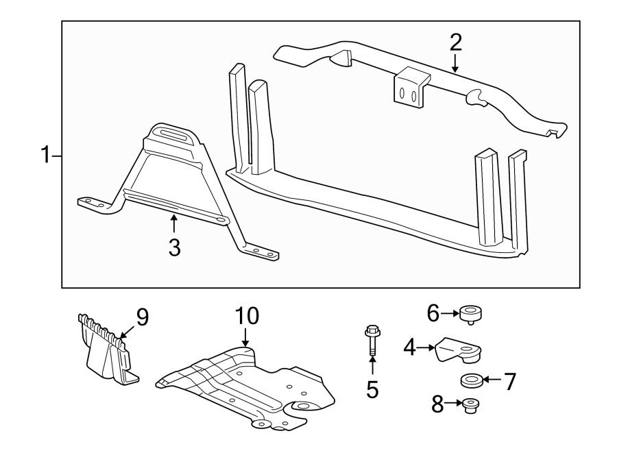

My best guess is that 4 - 8 are what I need, but it's just not clear to me and I can't find the pn's for them.

Bushings are not serviceable, part of skid plate

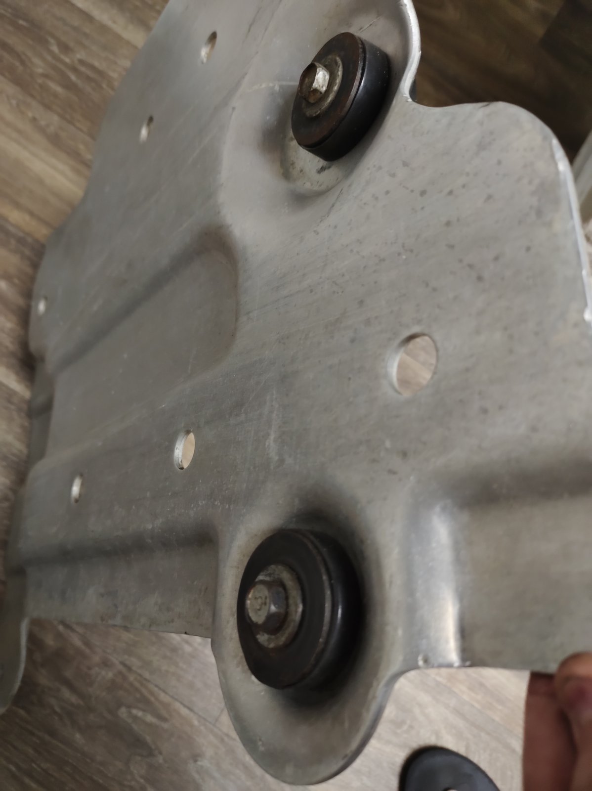

I ended up using these rubber isolators and they're very squishy. We'll see if they hold up against the elements but they definitely worked to get it reinstalled.

Side
02Z71Raven
02Z71Raven
Jun 1, 2021
117
117
Bottom
