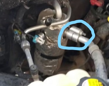

So I've been so busy with the AC being fixed and a new problem that I forgot to give an update.
So...it was a leak. A leak that the last place I went to who "Tested for leaks" and then "filled" the coolant..said wasn't there.
New place caught the leak and repaired it and filled me up with the right amount of coolant.Cold as can be! My wife is an ac queen and I've never heard her say she's too cold...and now she does!
Thanks for the help guys!
Hammer02
Hammer02
Aug 30, 2016
23
Sorry for the blurry pic...I quickly found it on google.
