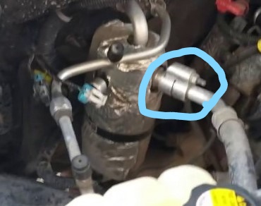

Being the rear is colder?? How cold is colder. If it blows as cold as it should then I would suggest the front has either a clogged orfice tube or a bad blend door actuator. Verify blend door is working correctly. I would say the compressor is likely good since its strong enough to keep the rear ac cold as it's the furthest away. Bad fan clutch would effect both. Check your line going into the fire wall it should be getting cold if it is I would suspect blend door if not then I would suspect the orfice tube is to blame.

It's not as cold as it should be...but just a little bit cooler than the front.

If both systems are being affected then it could be fan clutch clogged condenser fins I would check the operation of the blend door in the front and then move on from there. Put a gauge on it and see what the pressure is of you have one.
