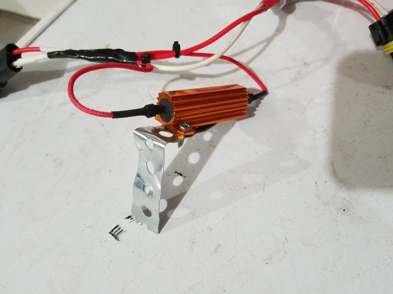

Yep they will get super hot and easily melt plastic and wire insulation. I made custom brackets for mine using ac/heater ducting hanger straps. I tried searching my build thread but I couldn’t find pics

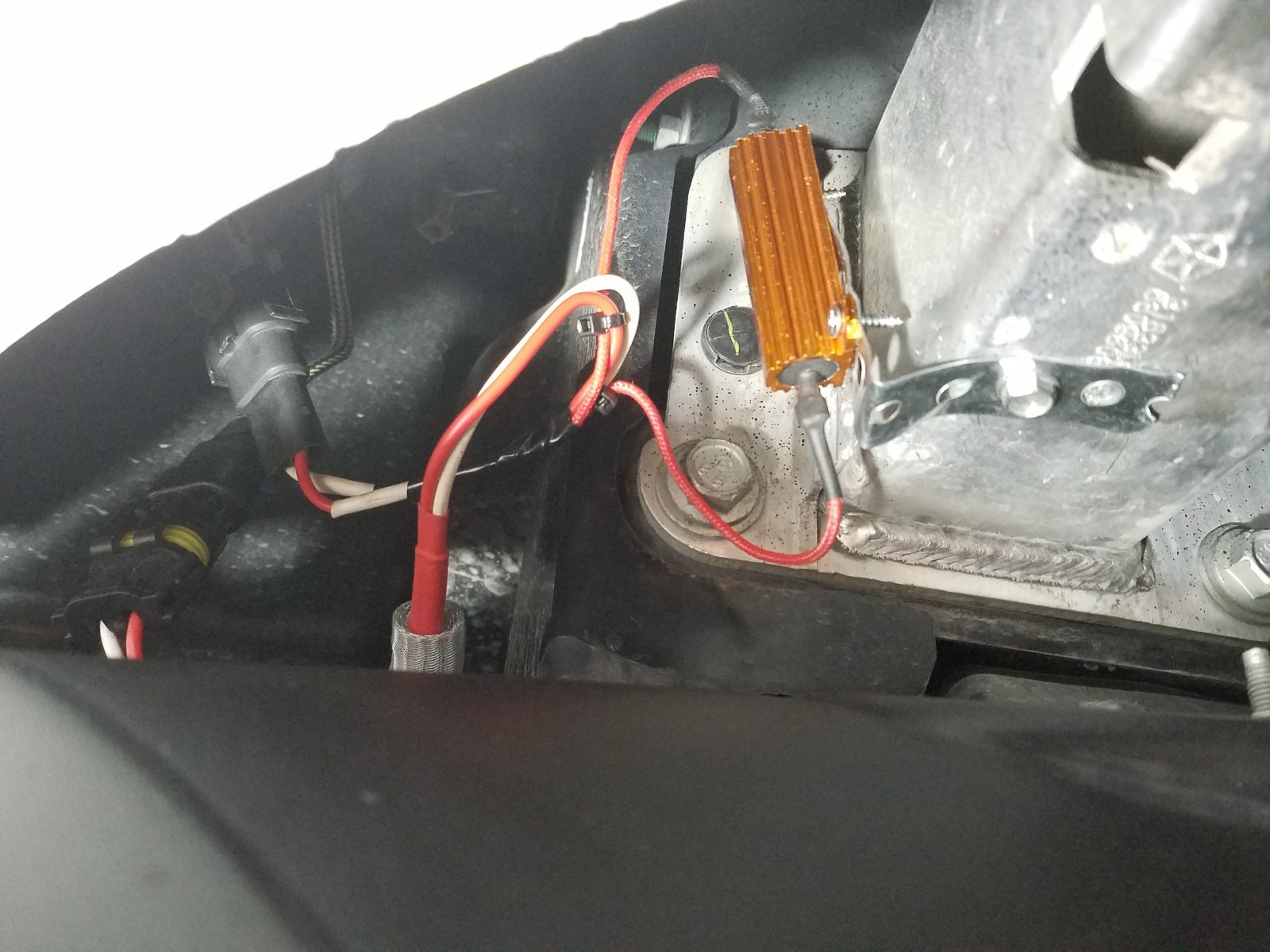

Bugs me I can’t find pics of my resistors mounted
Here’s on the wife’s car. Used same method on Tahoe
