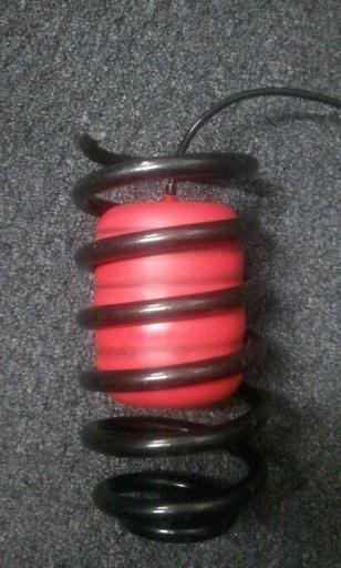

on the guys that want to cut i use the belltech tb spring and cut a coil off then smooth the edges that will drop it 6.5 inches over stock then i use the airlift bags inside. You will need to run a shock that is 18 inches extended. Using the same set up on my wifes truck now and have done prob 50 local trucks like this over the past years with no problems. I was tryign to get a spring made to set us this low but not enough people were interested.
http://www.tbssowners.com/forums/showthread.php?t=56608
the djm tb spring when cut loses a lot of its quality due to design and 99 percent of the people like the way it rides and sits low enough. But for customers that want to get lower I install the belltech set up and cut a loop along with the rear djm hardware kit and shocks with airlift bags and its fine.
on 305 35 24 and this spring the back sat at 31.5 with no air in the airbags.

the main thing the coils ONLY CUT OFF THE TOP do not cut the lower side. You need the placement on the rear axle. ive never had issues with the tb coils cut as long as you use that airbag i put in the post. because when the truck sits down its only like 5 inches from top to bottom of spring clearance. ive done tons of the tb coils cut off the top and flat cut the top spring and no issues.
1lowhoe what does your truck sit at now from ground to fenderlip?? if you have 245 50 20 it should sit at like 29

i never use those i use the 60748 kit. its only 5.5 inches tall.
with your 20s and the tb coils cut off the top only like i posted in my link you should be 31 easy at all corners and ride great.

first of all id start with the tb coil cut like i show in that pic and use the air kit I listed

for the front you can do the djm 3 inch a arms with djm shocks and belltech 2 inch drop spindles for 5 inches. In rear you can do the djm hardware kit with the djm 1800 shock and the tb spring cut 1.5 loops and use the air helper bags from airlift and you will be pretty good.
but what size tires are you running on your truck.
rear tb spring cut with helper bags
