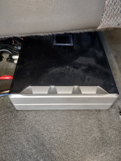

I got the new hardware & new radio, but the PO also installed an aftermarket amp/sub setup which makes this job a bit of a hassle.
The 12v, camera etc. is on one harness, which I didn't fully test yet, but it powers up fine. The main problem is wiring the second audio output harness to the amp's RCA inputs, which has 4 speakers and a sub. This harness has only a raw + and - wire for each channel, L & R, front & back, so I understand that as balanced outputs for each channel (2 wire) right? So 4 speakers = 8 wires total. The sub hooks up on a separate RCA connection.
I didn't have parts on hand so I have some balanced RCA connectors ordered that I plan to splice on to the harness so I can connect them to the amp inputs.

Installation is done. The left & right side of the trim needed about 1/4" cut out so the knob/screen fit right. I used the balanced RCA connectors to work with the monster (Alpine) amp inputs because I didn't want to rip that whole setup out.
So because this radio's amp is now going into another amp it was REALLY LOUD. I had to turn the inputs on the amp to the lowest setting, and tweaked the sub settings too. We're in business!
