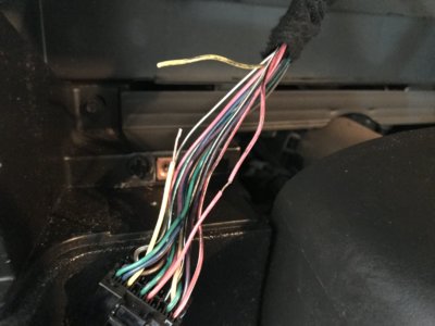

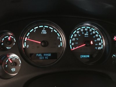

Thanks to Fiatdale, I was able to keep my gauge lighting on all the time while the vehicle is running. It drove me nuts for years that the gauges could hardly be seen during the day. I think GM realized this and changed it for the 08'+.
It is a very easy mod and took about 20 minutes. See below for the video on how to remove the gauge cluster and then I attached a schematic of the wiring harness for the gauge cluster. If the mods feel like sticking this thread, it might help others that have the same issue I had on not being able to see the gauges.

Just came across this looking for an alternative to the dim gauge cluster TSB (only had my 07 for a year). I will give this a shot over the upcoming weekend. I cant see my gauge cluster for shit with sunglasses on during the day.

This may be a dumb question but will the dimming function still work on the gauges? I drive a lot at night and I like to dim the gauges on long road trips at night.
Hmm... Probably not since you are taking the dimming control out of the loop. I don't drive enough at night to worry about it though.

Can you get to the wire bundle to make the splice without removing the whole gauge cluster?
No, it is directly behind the gauge cluster. There isn't a ton of room to work even after the gauge cluster is out. It is super easy though.
