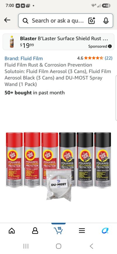

This is the Fluid Film mentioned above.View attachment 490209
Whenever I see a can like that I can hear a sheep bleating...
