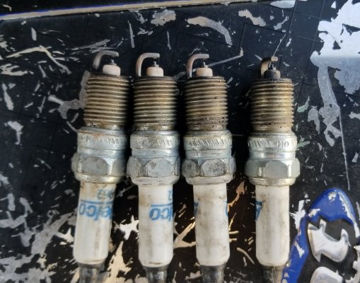

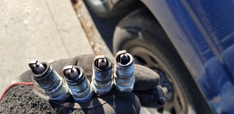

Checked out the Tahoe today--finally. Pulled the plugs. Cylinder 2 was discolored(black)and ever so slightly wet--not much. All other plugs were great. There's probably 500 miles on them since they were changed.
Cylinders 2,4,6 and 8.
Looked great, as they should.
I tightened 3 loose exhaust manifold bolts on the driver's side. That's where I was having an issue with stf/ltf, bank 1. I guess that was the issue. Runs 100 times better, but I still heard a little popping from the exhaust. Nothing loud or anything, but I heard it.
I saw some antifreeze drip out of the right side heater core line. I guess I leaned on it when I was trying to pull that last plug. I pushed it in and gently wiggled it, and it seemed fine. I let it run for awhile, then took it for a ride. System didn't pressurize, so idk what to think about that. Needle didn't move a lot past 160 degrees. Heat worked. Guess I'll keep an eye on it. No more leaks tho.
View attachment 361291View attachment 361292
Cylinders 1,3,5 and 7.View attachment 361293
