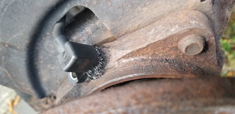

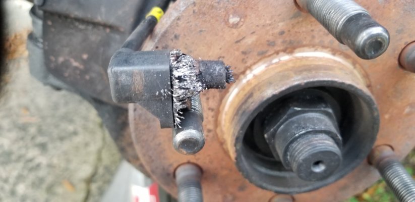

Sorry, yes I did remove those bolts after taking the pic. The pics I posted was right after I pulled that front of the hub off--well it basically fell off in my hand. I was trying to get as much done as quickly as possible, while being attacked by mosquitoes----plus I've been awake almost 24 hrs. I was beating the crap out of that rear hub plate, and I was also trying to hammer a pry bar, then a long screwdriver with no good results.
This is a ton of metal shavings stuck to the abs sensor. I'm still shocked the wheel didn't fall off!20211015_161238.jpg20211015_161301.jpg

This is a ton of metal shavings stuck to the abs sensor. I'm still shocked the wheel didn't fall off!View attachment 352936View attachment 352937
I hope you got a new axle nut. You’re supposed to replace it anyway but especially since it was the only thing holding your wheel on so I’m sure it’s stressed.
