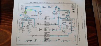

I disconnected the BCM to see if behavior changed and it was the same. I then probed everything in the system down to this level. Blue highlighted lines are behaving fine...
It's kind of interesting, the switch just changes direction of current on lock motor. I cannot verify if the unlock is finding ground on it's own (could test)... Or if the motors are bad (I need to hookup a power source and try to command the locks directly.
Curious has anybody ever seen 4 of 5 lock motors fail at the same time?

I quick disconnected the driver lock switch. The system performed the same. I thought this might have a master switch but doesn't look like it does?
I'm looking at the schematics everything is grounded through the post on the A-Pillar / Driver side SP203... I'm still trying to visualize how the reverse current works with the relays. That said, I tested all the relays and they seem to work fine (there's 3 of them).
