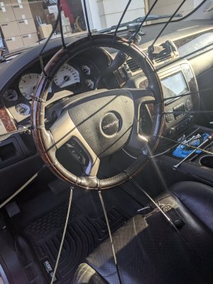

Used a old toothbrush and spread the epoxy all over as much as I could and zip tied it fingers crossed, couldn't do much for the dash the break is right on a ridge so no way to really fix it without taking it out but I dabbed some along the cracks under the center speaker cover and used a couple small pieces of popsicle stick

well crap the clear jb weld clear epoxy I used did not bind the leather and wood trim, it did bind to the dash plastic good though
so what has anyone used that worked for the leather/wood trim?

I think a guy used gorilla glue to bond the 2 together. Double check that tho.
