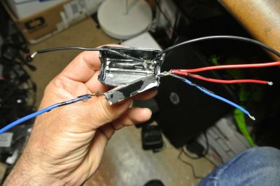

I opened one the box up when I first got it and it looks like it is just the resistor inside with some epoxy

No pics of the box open I assume?
inside the box it's hard to see much it's all epoxied together but looks like the
black wire is a pass-thru? but has a connector in the middle and connects to one of 3 resistors
red wire is also pass thru but has one end of the blue wire attached in a connector red to red + blue
looks like blue wire is attached to one end of a resistor and joins the red wire at the other side of 1 resistor
makes no god dam sense to me I tore one open
View attachment 244114 View attachment 244115
Is that a second resistor in the box with the black wire connected to it or is that just where the resistor was glued into the box?
I would take the resistor that you pulled out, with the blue wire on one end and the red and blue on the other, amd connect it as shown in the other pic I posted just to test it.
So...
Blue wire on left side of resistor in pic > turn signal + (light blue wire)
Blue wire on right side of resistor in pic > truck ground wire (black wire).
looks like there is 3 resistors total the blue wire to black wires reads 24.6 and blue to blue reads 4.4
Usually a 6 ohm 50 watt resistor is used to trick the BCM into thinking there is a regular bulb in place.
Its really hard to see how the resistors are connected from the picture.
Perhaps they have them connected together to raise the resistance.
At this point I would probably disconnect the resistors from each other and ohm them individually to see what you've got... then try hooking one up as I mentioned earlier.
Which ever is closest to 6 ohm would be the one I would try... the 4.4 ohm might do the trick.
