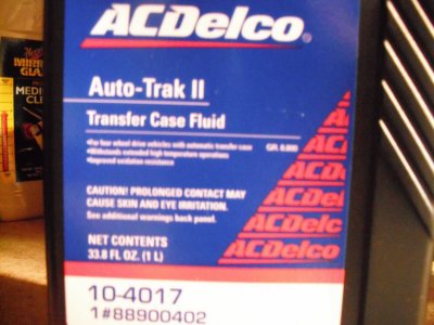

It's a internal Transmission Seal failure causing fluid under pressure to fill up the Transfer Case. No indication of this what so ever. No leaks of any kind. Tranny shop figured it occurred when Internal parts failed. Transfer Case ok found Needle bearings and small metal parts in Trans Pan.

To be clear, I'm wondering if the TC takes transmission fluid (red) or something like AutoTracII (blue).

Each are different you really need to check the manual. Mine takes atf and I change it often. I really don’t like autotrac! If my case did call for it I would use it. But I would change it even more often. I am not a fan of autotrac! Some say you can use good synthetic atf I have not experienced so I can not say. There should be a tag on case for model of case .
