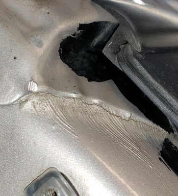

Thought it was the windshield. But I traced it up and it's coming from BETWEEN the body panels on the top right corner of the windshield.

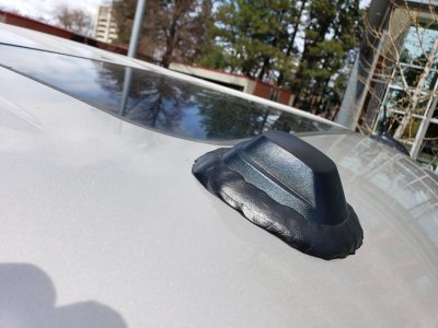

Antenna perhaps? Not sure which side is GPS and which is sat-radio. Which one's on the passenger side?
And how to they secure? I have some sealer with me but I've never had to pull one of those things off before so I'm rather clueless here. I didn't see any obvious clips or screws on the top end. Need to drop headliner to get to it?

If I zoom in on the pic there’s what looks like a black seem sealer to the left of the arrows? Or is that from the headliner? The arrows seem to point to a split in the metal or am I not seeing it right?

Ohh
The sealer is from the windshield. The arrows point to a gap in the body panels presumably where the roof meets roof braces and whatnot. But yeah there's no sealer where it is, just a gap between metal sheets. Current theory being it's the antenna because I'm really not sure where else it could come from regarding that. Just need to figure out how to take the thing off and seal it up. Hope I don't need to drop the headliner, don't have any decent weather for a minute

To left of arrows..... That black stuff looks like "over-flow" sealant/rubber from the seal ABOVE the metal/silver body seam in photo. The metal seam looks 'wavy' ... (bent).... a factory defect at the edge?
Possibly the windshield was replaced and the removal/install damaged the edge?

Yeah windshield was replaced a couple years ago. Leak is new as of this winter.
Seam is symmetrical on other side and neither show signs of prying or other damage. I think that's just how it is.
Anyway... Had a break in the weather. Tossed some of the good stuff around the antennas for now as I won't have the time to drop the headliner for a few weeks.
Guess if it's fixed we know it's the antenna. If not then something else
Used butyl rubber if anyone's wondering
