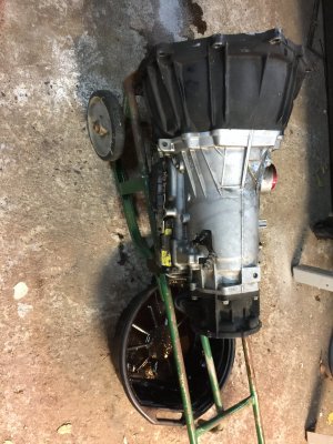

Well f me I got it out after 8 1/2 hours today. Everything seemed to be a giant PIA , plus doing it in my driveway sucked. For instance, to pull the flex plate to TC bolts the starter had to come all the way out which meant the passenger header had to come off which meant the fender liner, plugs, wires and dipstick tube had to come off ( it goes between 2 of the header tubes). It was like that all day. Then when it was finally time to drop the trans, it wouldn’t come back at the top. There was one more bolt that I didn’t see ( not the top of bell housing but one space to the left) because you have to get your head up in a hole behind the trans to see it, and use a 4’ extension to remove it. Then it still wouldn’t come loose until finally as I was prying between the flex plate and TC it popped loose and fell off the damn trans jack. It didn’t hurt anything luckily. ****** news is that I see nothing wrong with anything. Torque converter doesn’t have any obvious signs, nor the transfer case. I think it’s the trans. If I put the gear selector in neutral the tail shaft only turns in one direction plus it seems like it makes noise as I turn the shaft although I can’t turn it much. I’m thinking I’ll get a return authorization and send the trans and converter back and see what they come up with. Besides I’m in no hurry to reverse this process. Damn truck tried to kill me today lol.

I sure don't envy you. Good job buddy.
