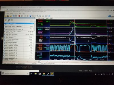

Well...uh I'm out of injector :lol:
50% throttle, 5000rpm, 97% idc ....a little rich just wanted safe tune to start data logging
134kpa roughly? 4lbs of boost
if you look at the purple line second row, its rolling into boost about 3500rpm (105kpa being atmosphere- max on the graph) audibly you hear it start whistling about 2500rpm.
