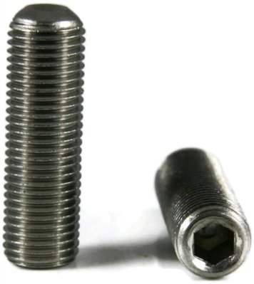

Has anyone thought about using set screws with a bit of sealant.? Those bumps would still stick up a little bit but I doubt anyone would see them.
I'm wondering if I'd need the right length for the set screws to bottom out in the holes, or if the loctite/sealant would be enough to hold them still.?
https://www.albanycountyfasteners.com/Socket-Set-Screw-A2-Stainless-Steel-M6-x-1-0-p/401014.htm

Set screw are a great idea. I used small plastic push pins and you can tell i even put anything over the holes
