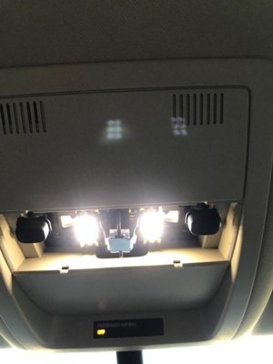

Swapped out my vanity and other overhead lights to LED's. Took about 30 minutes. That includes photos and cleaning the covers. Got them off Amazon.
LEDpartsNow Interior LED Lights Replacement for 2007-2014 Chevy Tahoe and Suburban Accessories Package Kit (15 Bulbs), WHITE
Attached pics showing vanity bulbs comparison. Then before and after pics. These are VERY bright. I use the top right one independent every morning to grab ID out of bag while pulling up to a gate and its almost too bright.

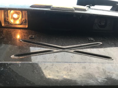

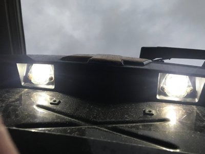

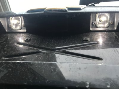

Yes, mine popped out fine. I belive i saw a youtube video on it so was not as timid. Here is completed licence plate lights. One of the old bulbs were blown.IMG_5175.JPG IMG_5176.JPG IMG_5179.JPG

Thank you for your confirmation. I'll give it a try this weekend, if it gets above 10F outside. The interior of the truck lights up so much better, when all of the dome lights are converted to LEDs.
And, the license plate just pops out, with the LEDs illuminating it (maybe, not a good thing..... :) ).

I gave this kit a try, seems decent enough. Two of the festoons didn't have end caps that were secure but oh well. I have two additional bulbs that I don't have a home for. They are push in base with 1 led pointed in each direction of the square. Where are these supposed to go?
qcon
Jul 21, 2017
110
252
Huntsville, AL
Sounds like the 194 bulbs for your license plate.

After installing the plate lights, I also had 2 left over but figured it was for the bottom of exterior mirrors which mine do not have the option so...spare bulbs.
