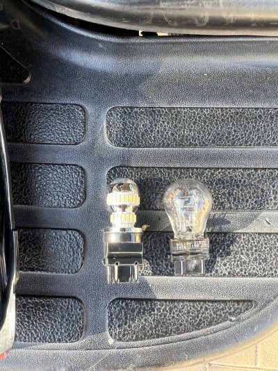

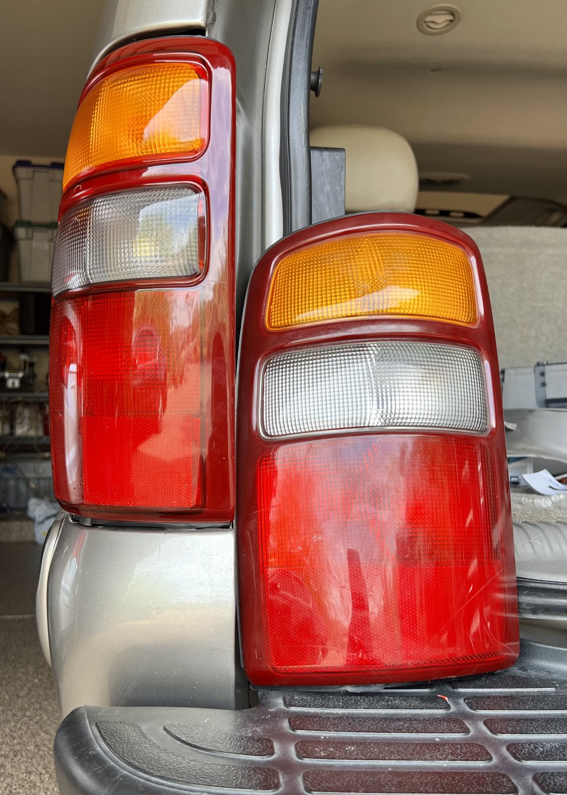

Apparently everyone on the WorldWideInterWeb already knows this, but I can now confirm that LED brake lights will cause the Cruise Control to stop working on GMT800 SUVs. I replaced the left and right brake light (aka tail light or stopping light) bulbs in my 2001 Yukon, and the Cruise Control worked fine. Then I also replaced the top center brake light fixture above the lift gate with a Dorman LED fixture, and the Cruise Control stopped working. It would not set on the speed. Then I swapped the original 3157 incandescent bulbs back into left and right lower brake lights and Cruise Control works now fine again. I’m trying to noodle why this is; something about the amount of resistance in the circuit the Cruise Control monitors to turn off when brakes applied, but I can’t figure this out since the Cruise Control surely does not put current in the brake lamp circuit.
I decided against installing resistors. Why would you do that? A resistor converts electrical energy to thermal energy. The current and power increases and you lose the benefit of LED efficiency, just to make more heat.
So I’ll keep the the LED fixture on top center brake light and run with ole’ fashioned 3157 incandescent bulbs on the left and right brake lights, and the flashing turn-signal lights. I’m now running all LED interior (it’s awesome, easy upgrade) and LED on exterior head lights, daytime running lights, fog lights, center brake light, and reverse illumination lights. I retained incandescent bulbs for the amber turn signal lights (front and back) and red brake lights; replaced bulbs with new but not LED. I also polished the headlight enclosure with a Meguiar’s kit, and replaced the brake light enclosures with Dorman aftermarket enclosures. The whole project was probably $250, mostly for the new rear fixtures and fig lights, but it’s a nice refresh on a 23-year old vehicle.

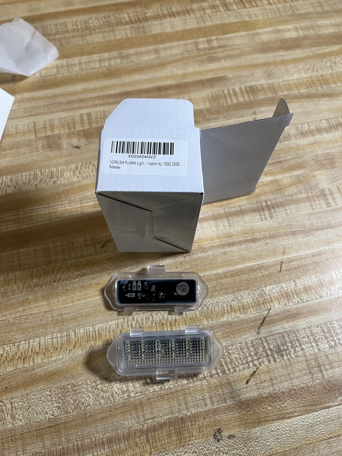

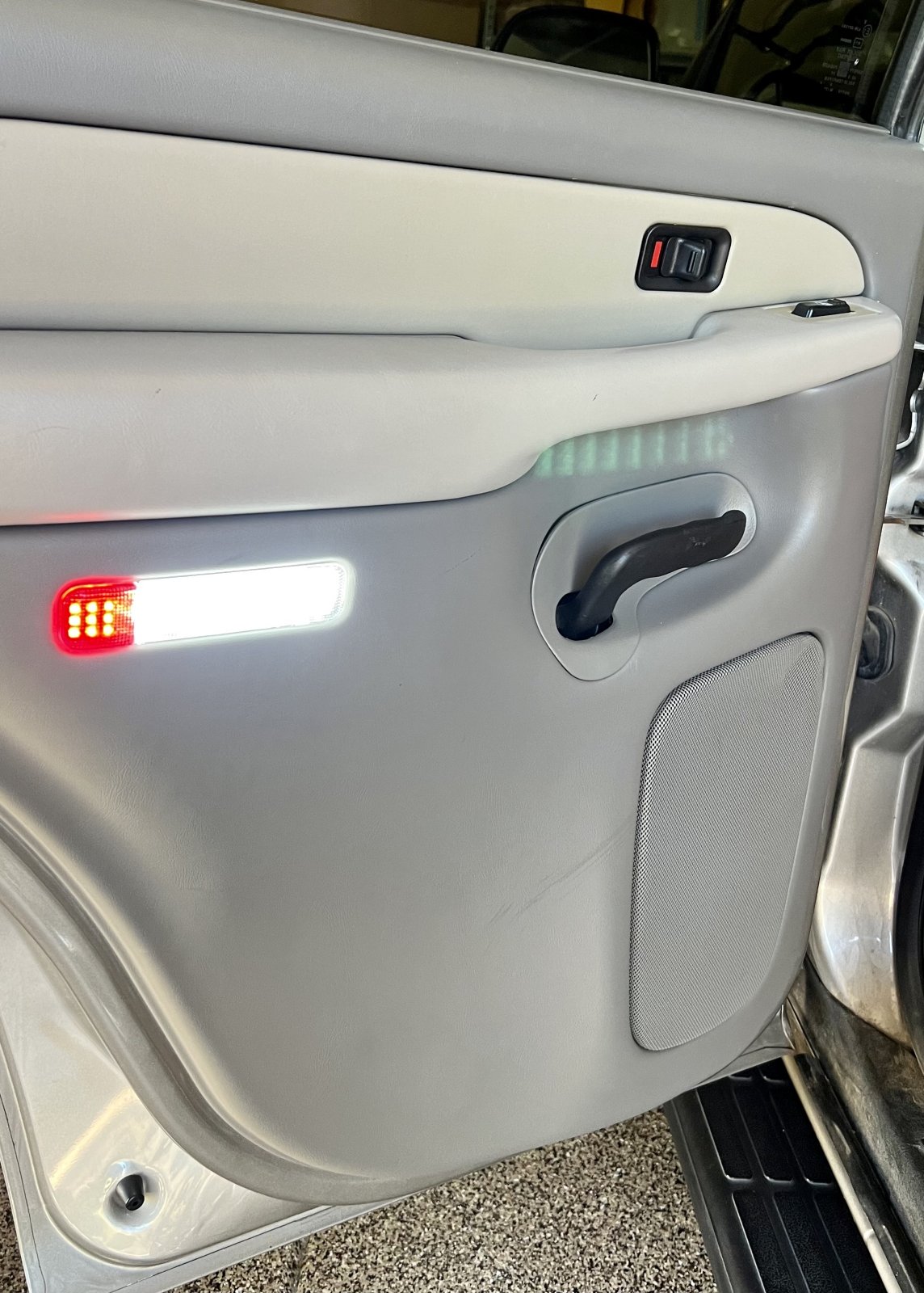

You should really give the interior lights a try, Marky. It’s amazing how much more light. This is the courtesy lamp in the rear door.
