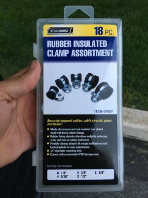

Changed from zip ties to rubber coated clamps for my brake lines and brake sensor cables. Pulled out the sensors and cleaned them so hopefully the anti lock will quit kicking in at 5 mph when I am parking. I've almost hit other trucks in the parking space ahead of me because of the anti lock kicking in.

That’s a pretty good idea what sized clamps did you use and what about the screws or bolts to hold them on?

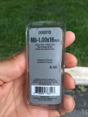

Just got this kit from Harbor Freight and used what worked. I had to use a bigger one in the middle of the a-arm so I could bend it down towards the bottom of the arm. Used factory holes.
