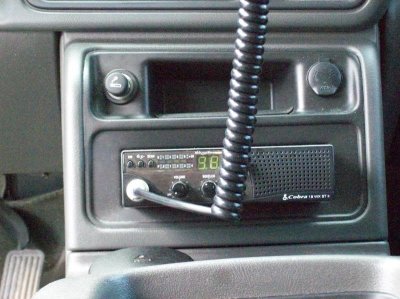

This is on an 02 so the console is different, but @02TahoeMD has a build thread on Expedition Portal that is just awesome for overlanding!
http://forum.expeditionportal.com/t...itionary-Vehicle-quot-Under-Construction-quot

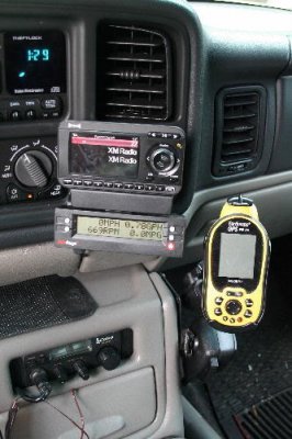

Thanks for the pictures. That's not bad doing a face plate. I'll play around with it some and see if I can come up with a good location. Was thinking of maybe putting it in the center console it self possibly instead of in one of those pockets. But we will see.
